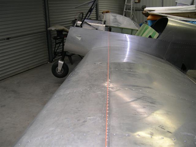

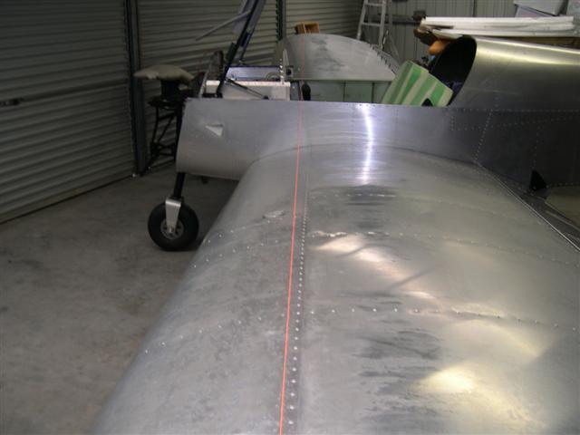

geather
Joined: 06 Feb 2008 Posts: 23 Location: Mt Hutton Australia
Posted: Wed Dec 24, 2008 1:50 pm Post subject: 601 problems |
Paul
Doesn’t wing sweep depend on the angle of the front spar? If you make the front spar vertical (by lifting the front wheel) then the sweep magically “disappears”!! – see pics
ge

bryanmmartin
Joined: 10 Jan 2006 Posts: 1018
Posted: Wed Dec 24, 2008 3:57 pm Post subject: 601 problems |
The forward sweep is an artifact of the 3 degree forward tilt of the
spar and the wing dihedral. If you raise the nose until the spar is
vertical you will see no forward sweep. During final assembly, the
entire spar web should be on the same plane with no bend in it.
On Dec 24, 2008, at 3:45 PM, <paulrod36(at)msn.com> <paulrod36(at)msn.com>
wrote:
| Quote: | You're not the only one..I've been putting the wings in place as a
rough draft to figure out where the holes for cables, fuel lines and
wires go, and once I get the temporary pins in, I see forward sweep.
Not a whole lot, but it's there, and it's driving me nuts. With what
we know about the spars and carry-through all being individually
mated during manufacture, my original skepticism about sweep has
turned to wonderment and consternation. If I pivot the wings back to
the neutral position, I'm putting a load on the spar-to-carry-
through joint, where ideally there shouldn't be any. Anybody got any
ideas on this?
Bryan Martin
N61BM, CH 601 XL,
RAM Subaru, Stratus redrive.
do not archive.
