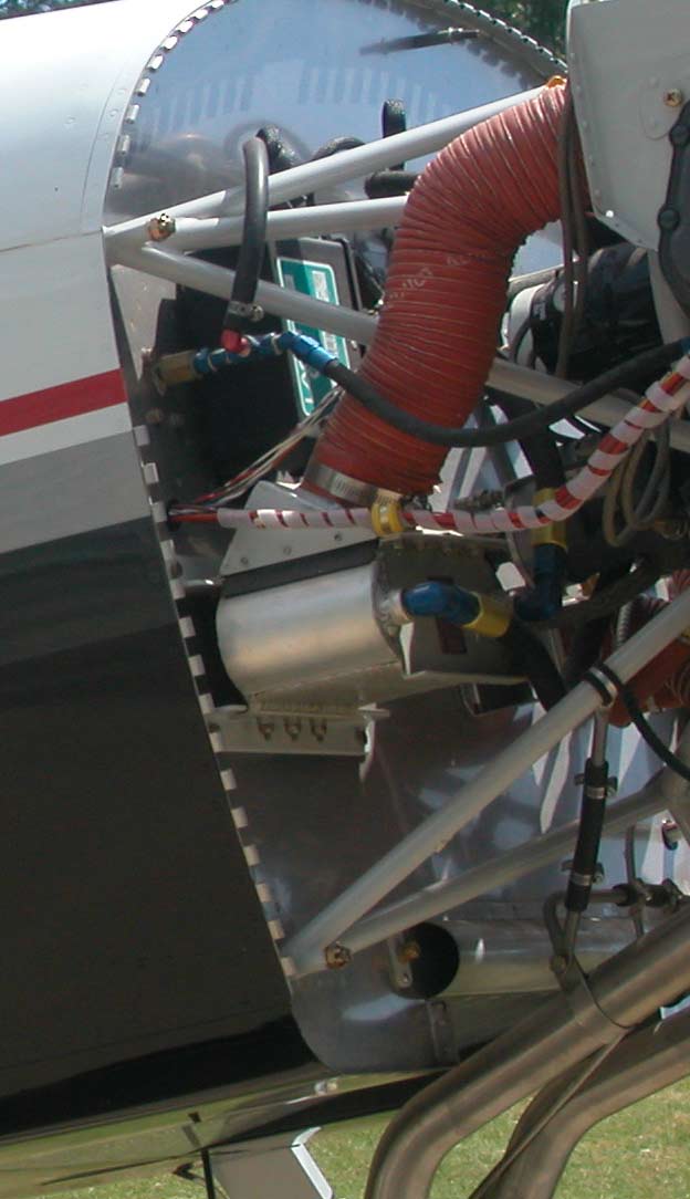

Check this out Dwight ... it was sent to me by this builder last year, he installed a SW ... just an idea for you. Jerry
