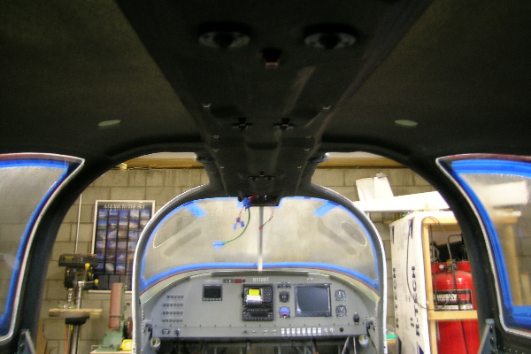

For those of you looking for the overhead console, its finally ready and fitting perfect to look at it go to nonstopaviation.com or I believe you can also contact Stein from SteinAir because he is putting together a package deal to include our overhead with his vents, lights and switches. Sorry for the advertisement but I know a lot of people where looking for an overhead.

A bunch of people have done this including myself. It was originated by a member of my former chapter, EAA983, Jim Erskine. I picked up a brand new one that a dealer had ordered for someone but they never picked it up. It was less than $50 on eBay if I remember correctly.
To make it fit I taped the bottom of it with professional release tape (aka packing tape), positioned it in the place I wanted it on the cabin lid, and went to town with professional molding foam (aka urethane foam door and window gap sealer). Once the foam hardened I sculpted it with a professional sculpting tool I acquired from the local Wal-Mart for about $9 in the knife area (aka electric knife). I then covered it with micro and some ply's in strategic places. For the hard points I took a piece of AL HVAC tape, made a small cylinder, put in a chunk of AL, and filled with flox. Drilled and tapped.
All told I probably have $65 in it counting the knife and spent less than 10 hours on it. The lights are all in the correct places for use and it will look very nice once the headliner is in. Still haven't figured out a good use for the spot where the factory compass readout went though.

I did the same thing and it worked out great. I did change the lights over to safety red LEDs with a blue LED cabin illumination light. I did use the compass bay to add in a 9V transistor battery backup with a switch on a plate where the compass was. Thus if a total power out, I can reach up and have decent panel illumination via the 9V battery backup.
Byron

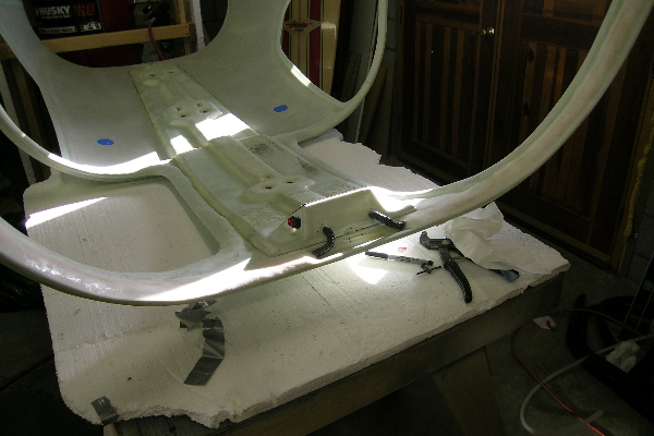

Just to reiterate "you can" do this yourself . If you can do all the
fiberglass work on the 10 you can make a console. I used blue foam and
molded the console in place, glassed it in place and then released it to get
the blue foam out, finally epoxied back on for good. Just takes time and the
will to do it.
-Chris Lucas

Posted: Tue Dec 16, 2008 10:16 pm Post subject: Overhead console |
OR........
Do NOt Archive
| Quote: | From: toaster73(at)embarqmail.com
Subject: Re: Overhead console
Date: Tue C 16 Dec 2008 20:22:52 -0500
molded the console in place C glassed it in place and then released it to get
the blue foam out C finally epoxied back on for good. Just takes time and the
will to do it.
-Chris Lucas
#40072

Posted: Tue Dec 16, 2008 10:58 pm Post subject: Overhead console |
And the final product...foam and fiberglass is fun!!!
JOhn G. 409 Do Not Archive
will to do it.
-Chris Lucas
#40072

Phil.Perry(at)netapp.com Guest
Posted: Wed Dec 17, 2008 4:10 am Post subject: Overhead console |
John,
Looks great!
What did you cover it with and what are the red buttons for?
Phil
From: John Gonzalez [mailto:indigoonlatigo(at)msn.com]
Sent: Wednesday, December 17, 2008 12:57 AM
To: RV 10 group
Subject: RE: Overhead console
Date: Tue, 16 Dec 2008 20:22:52 -0500
will to do it.
-Chris Lucas
#40072
