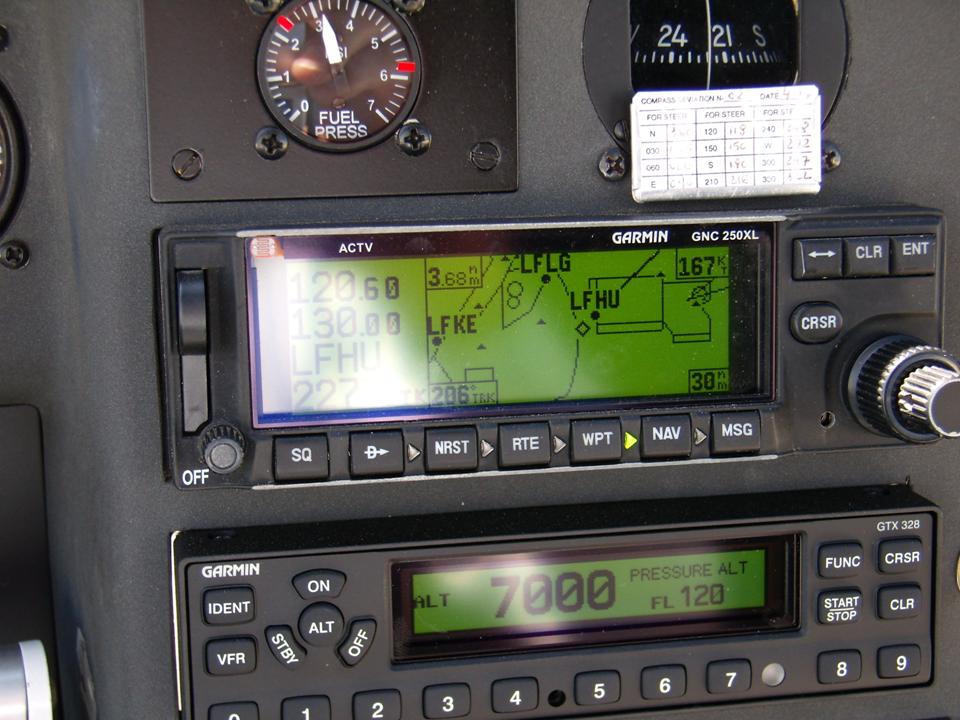

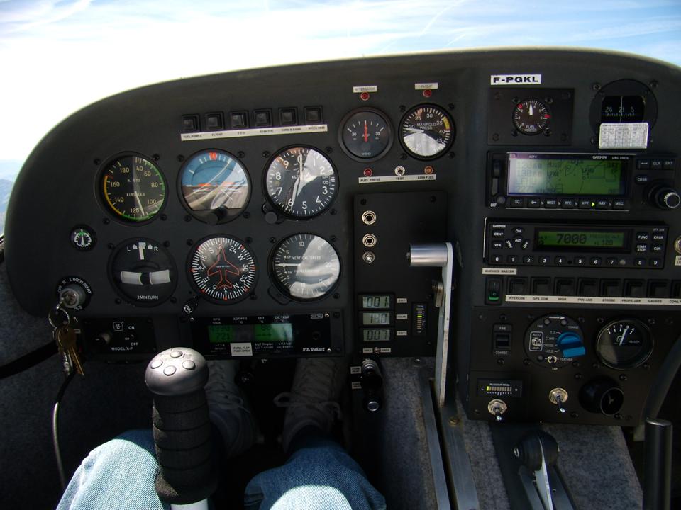

The GTX 328 uses the 330 rack. I confirm again that the 328 fits ok into the Europa. For those who still do not believe it, I have attached two pictures of my instrument panel. My panel module is factory standard. Sorry I do not have any pics of the back side.
Remi Guerner
F-PGKL

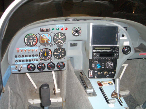

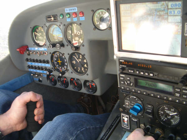

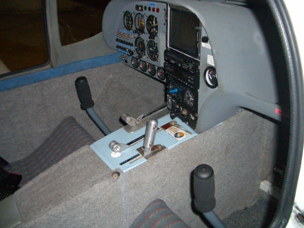

PostPosted: Tue Dec 09, 2008 8:11 am    Post subject: Garmin GTX 328 Mode S Transponder Fitting. Reply with quote
Rowland C
I managed to get the GTX328 and SL40 into the panel for WB C but its a tight squeeze behind! Just enough room for the connectors and an air gap.
Photos of panel layout from the front attached.  Sorry I don't have a photo of the reverse view C but will take one the next time the panel is out (selfishly sometime not soon I hope!).
Sean
