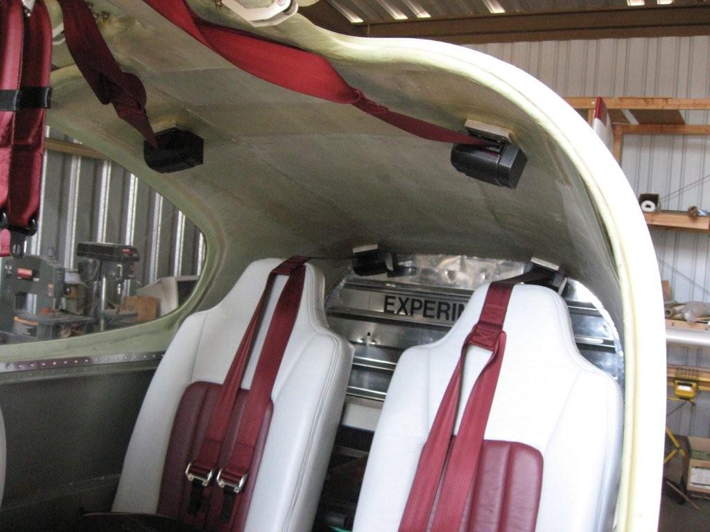

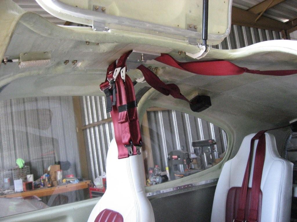

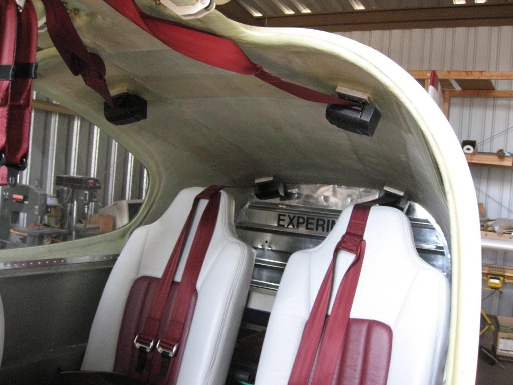

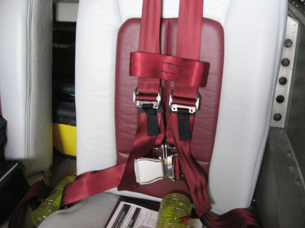

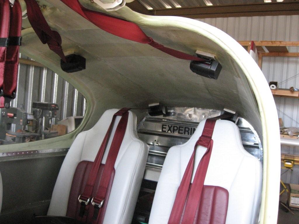

I received a couple of emails about the inertial belts so I took some
pictures.
(1) the rollers have covers that snap on and could be painted.

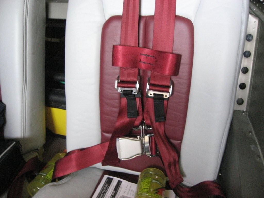

(2) I have two small children so created a velcro loop that will catch them
across the chest and prevent upper body from coming forward between the
belts.

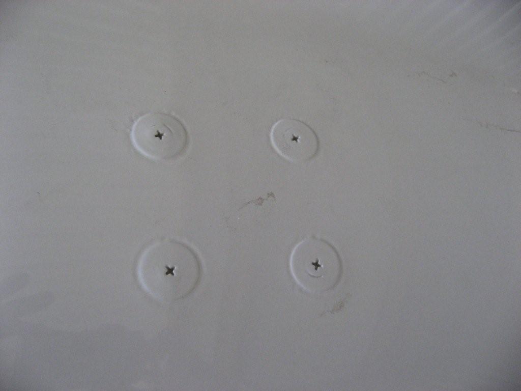

(3) One picture show the external SS screw pattern and CS SS washers that
spread the load on the belts. The consulting ME (a neighbor) indicates that
the additional hardpoints and CS washers should be 8-10 times as strong as
the Vans (single CS #5 screw without CS washer) in a crash.

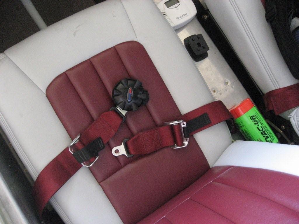

(4) there are a couple of shots that show the buckle options. If it looks
like the Boeing stuff ; it is. AMSAFE has that contract.

I covered my plastic covers with headliner material. Worked great.
