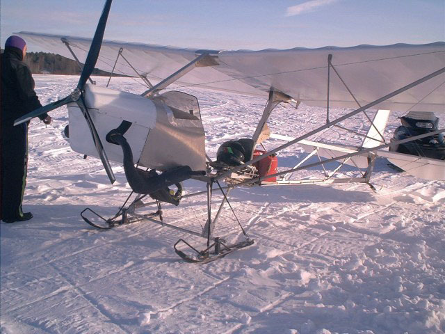

also i read this
Prospective purchasers of Basic Ultra-light Aeroplane kits should be aware that kit manufacturers and part suppliers are bound by no legal requirements under the Aeronautics Act. It is strongly recommended that owners and prospective owners of Basic Ultra-light Aeroplanes avail themselves of the information and services provided by the recreational aviation industry, schools and the ultra-light aviation community.
its statement like this that almost make you just want to come up with a rudder from another simpler plan of equal size better strenght. anyone have a total weight for the rudder. i want a idea of what i am lookin at
i guess my will be called a ch(theonlyone)
