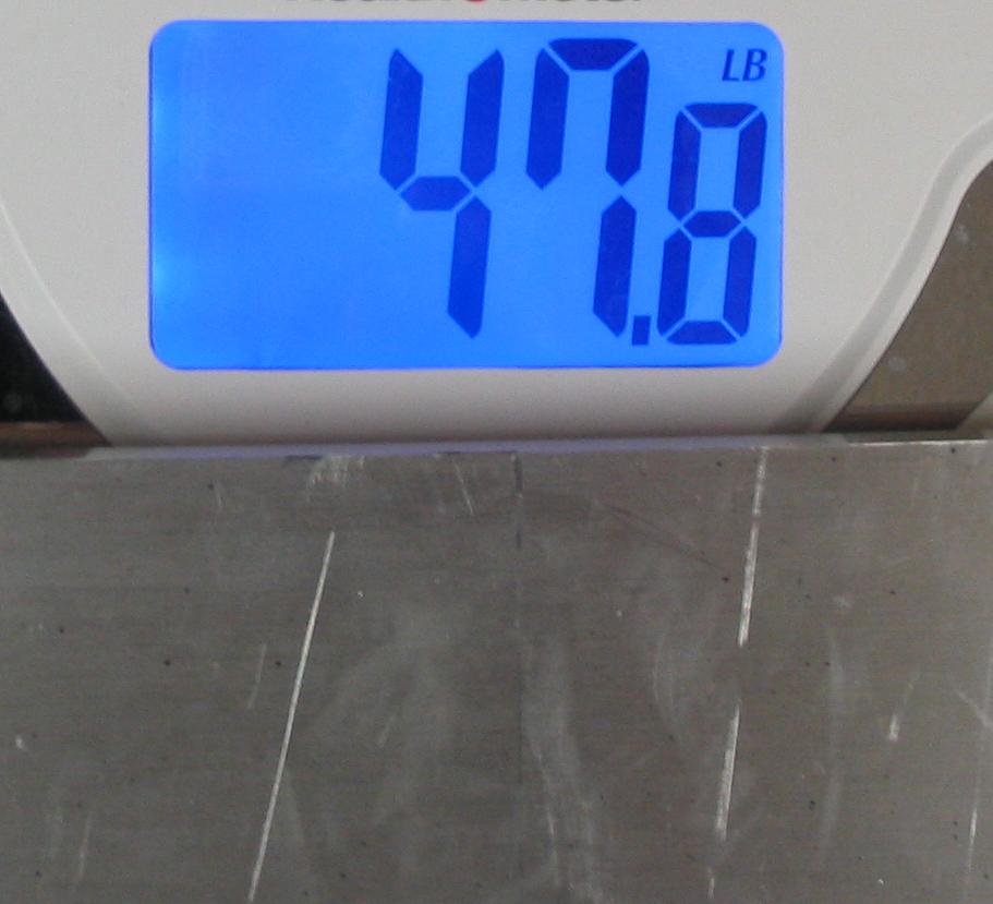

PostPosted: Tue Nov 18, 2008 2:39 pm    Post subject: Re: All 601XL grounded in Netherlands Reply with quote
Just put mine on the scale. With axles, but without wheels/tires, the big chunk of aluminum weights 47.8 lbs.
- Pat
- Pat

PostPosted: Tue Nov 18, 2008 8:13 pm    Post subject: Weight savings Reply with quote
If by "reduced" you mean thinner, the Grove gear is actually 1/8 inch thicker (if indeed it is 7/8" vs. ZAC 3/4".
10 lbs is significant. Every bit adds up. The paint might weight 3 to 4 lb/gallon after it dries. You can save some weight by replacing the electric flap motor with a pull lever. If you live in a warm climate, use a smaller battery and save a few lbs. The wheels make a big difference depending on what you choose etc. I'm sure there are a lot of weight saving tips out there.
