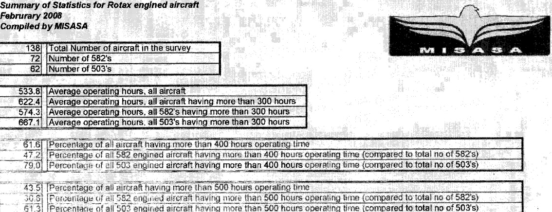

Also from SA: Rotax reliability facts:
 Filesize:  375.7 KB
 Viewed:  577 Time(s)

This is AMAZING, Larry. I checked their website
(http://misasa.flyeaaforum.com/?p=469) and found that the request is
expected to be approved. I loved the letter because of the statistics
in the appendix. It's the best information on 582's I've ever seen.

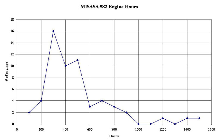

Larry,
I have attached a plot of the number of engines in each
group of 100 hours, (i.e. 0-100, 100-200, etc.) These are the hours
582s in South Africa have flown without crank replacement or major
overhaul. I'm trying to figure out the number of hours one can fly
with a 97% chance of no-crank-failure based on this data, but my
statistical mathematics is rusty.
Guy Buchanan
