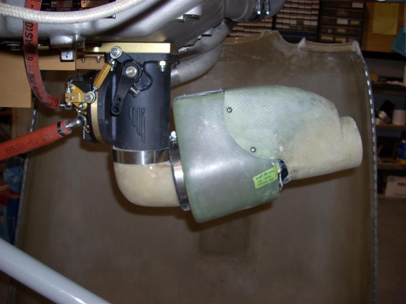

PostPosted: Tue Nov 18, 2008 5:33 am    Post subject: Re: Rod Bowers Ram Air Reply with quote
Lee, we have the Rod Bower Ram Air installed on a 'standard' IO540, vertical draft induction. There is an elbow available from Airflow Performance that Rod sent us to try, these elbows will not work. They push the front of the intake too far forward, and will not leave enough room for the cowl. We made a fiberglass elbow that attaches to the throttle body in the standard vertical orientation, then makes about a 100 degree turn to meet the ram air intake. Hopefully the pictures attached show it well.
Keep in mind when we did our install it was with Rod's 'old' design, I have no idea what needs to happen for his new design. We also had to shorten the front of the ram air intake to make it work.
Our objective was to not modify the cowl to make the system work, we are using a James Cowl, with the standard induction position, not the cold air induction position.
I like the concept behind the system, Rod was nothing but helpful. I will admit that after putting in dozens of hours making this work I did start to question my sanity. Not flying yet, no proof it was, or was not worth it.
