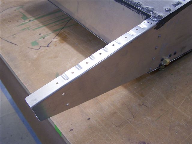

Now I just have to build more flanging dies for the wing ribs, hope it doesn't take as long as it did the first time ;^)

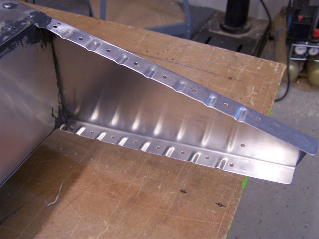

PostPosted: Sun Nov 16, 2008 8:51 am    Post subject: HDPE fuel tanks Reply with quote
R.D.

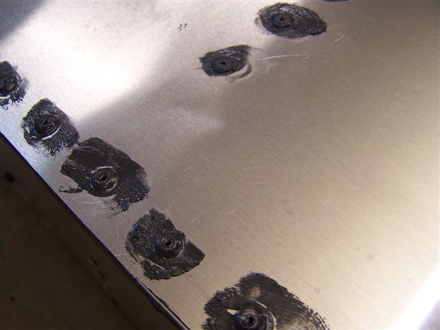

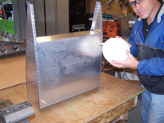

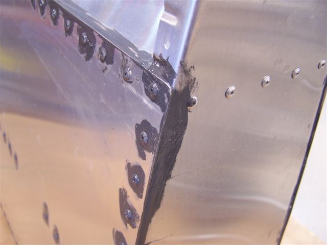

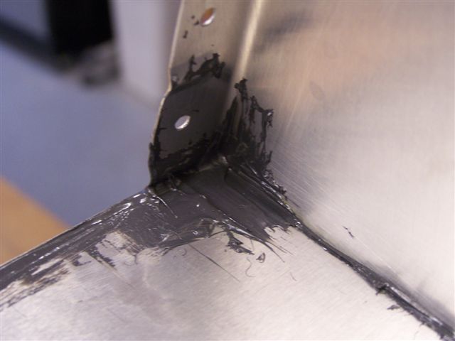

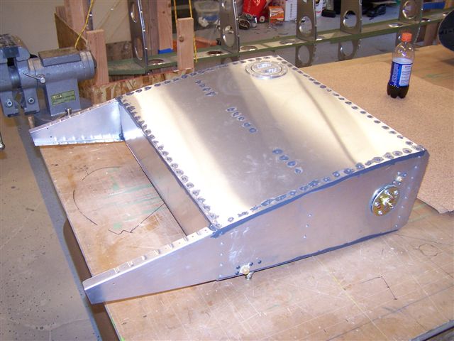

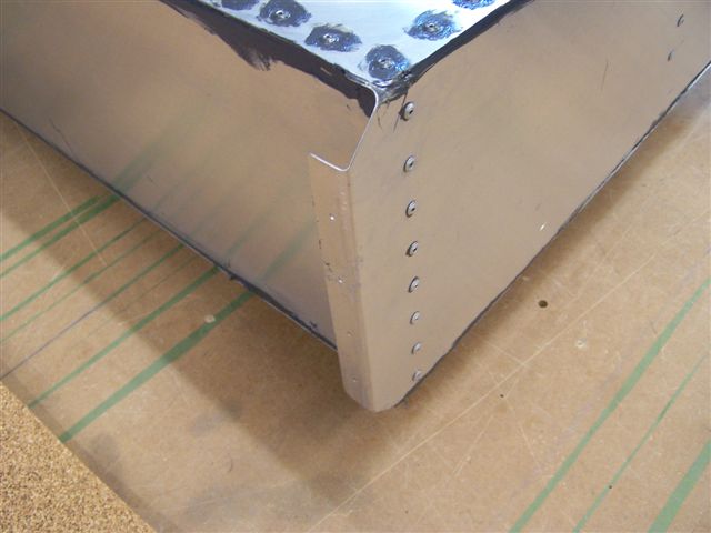

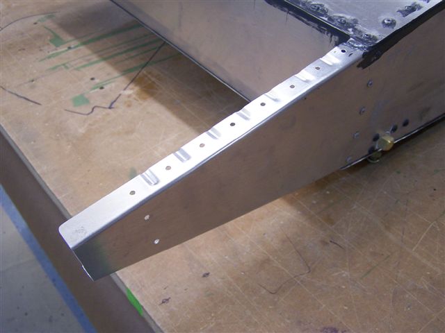

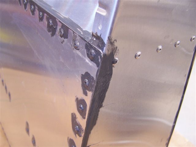

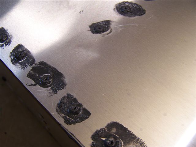

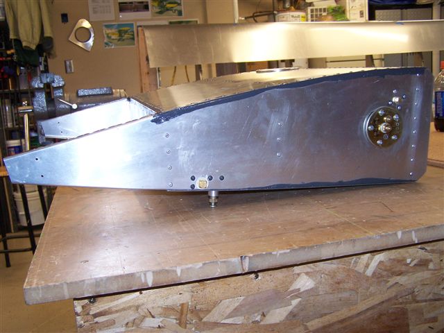

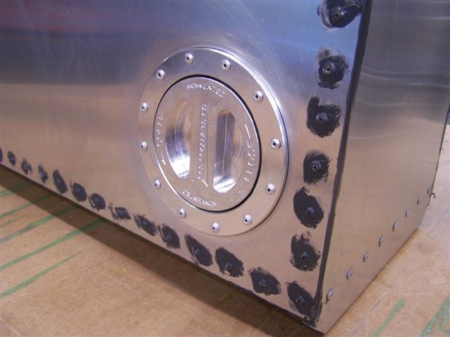

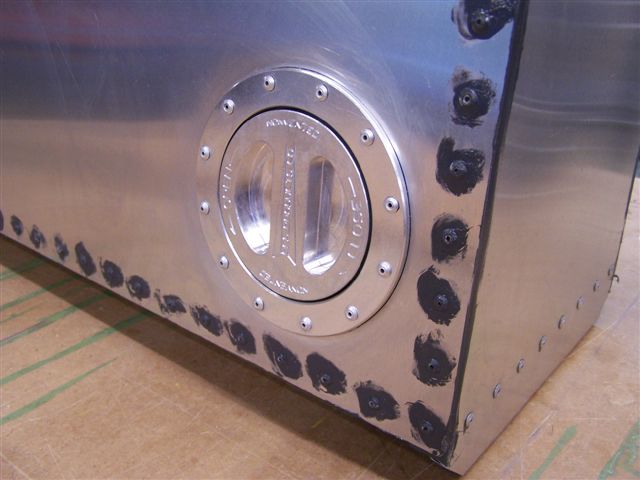

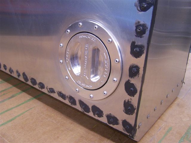

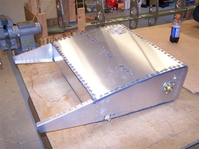

Here are some more pictures. You should post your info about rivets and
flanges to the 701801 list. I think other would find that useful.
Curt

PostPosted: Sun Nov 16, 2008 9:17 am    Post subject: HDPE fuel tanks Reply with quote
For those of you contemplating building this type of tank, and who also want more fuel
capacity, it may be possible to simply make the tank longer, resulting in those two ribs being
spaced further apart.
I base this on my conversations with Zenith. On my 750 kit, they are going to increase total
fuel capacity for two tanks from standard 24 gal to about 35 gal. They will do this by moving
the ribs and putting in larger tanks. As far as I know, no other modifications will be required,
but if you decide to do this you should certainly confirm that with Zenith.
Ken Ryan

I don't know if you got a reminder from a moderator, but those pics are good info. It is defiantly not SPAM, as it applied to the topic at hand, was asked for and helpful. Maybe if the web space cost here is prohibitive and I believe it is. We should try to put pics of relative items on a single stable free website, with references to the relative thread here and links to there.
The pics helped me a bunch.

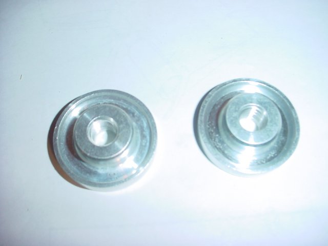

PostPosted: Sat Nov 29, 2008 1:45 pm    Post subject: HDPE fuel tanks Reply with quote

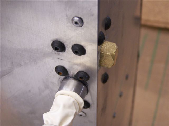

Thanks for the great photos Curt...

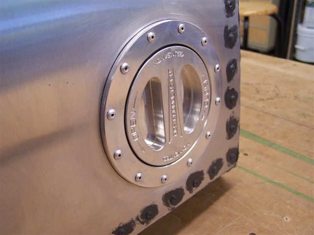

Your caps look like the ones from ACS... http://www.aircraftspruce.com/catalog/appages/acstlockffc.php
Is the hole in the wing skin the same diameter as the cap flange an butts up flush to the flange... ie not fastened?
I was thinking of using the ACS...
http://www.aircraftspruce.com/catalog/appages/lwsprlfc.php  with the threaded flange!

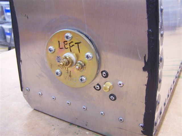

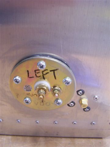

Also what is the  thickness of the ring for the sending unit that is to be fastened on the inside of the tank?    Is it 6061 aluminum?  Did you use a rubber gasket between the sending unit and the tank then, or just Proseal as some builders do?  I think that it would be very difficult to remove the sender if it was Prosealed... but then would you have to ever...
I have the Zenith recommended sending unit which includes the rubber gasket... but will have to make the mounting ring with the 10-32 threaded holes.

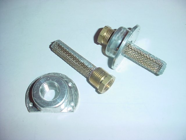

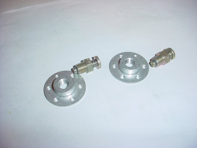

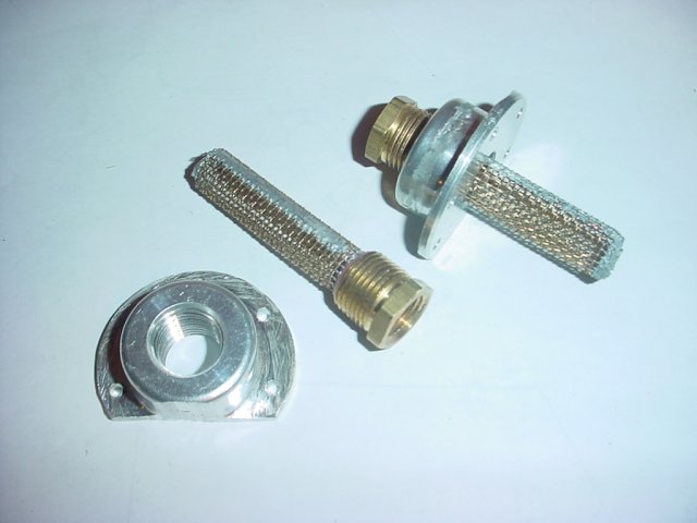

These are the VAN'S drain flanges VA-112 and CAV-110 sump drains from ACS..
These are the welded flanges from ACS for both sizes the drain and finger screen!
http://www.aircraftspruce.com/catalog/appages/alumflange.php
These are the welded flanges from ACS... trimmed the flange off, cut the flange level with the bottom of the tank and then had to drill the holes... lots of works.  Can be has also from VAN's VA-141, for about $20 per... I had the ACS flanges already so I used them... but next time I would buy from VAN'S.
There are a lot of builder Web Sites of the Van's aircraft wet fuel tanks systems on the Web... lots of info available!
Have fun Curt... and keep building,
Ron

PostPosted: Sat Nov 29, 2008 8:31 pm    Post subject: HDPE fuel tanks Reply with quote
Thanks for the pictures Ron.

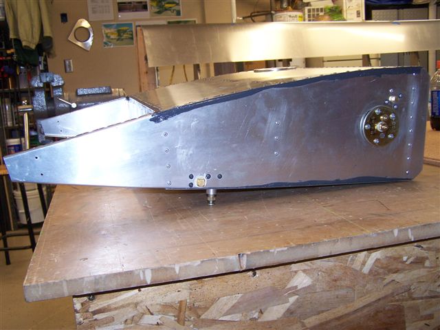

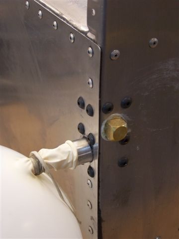

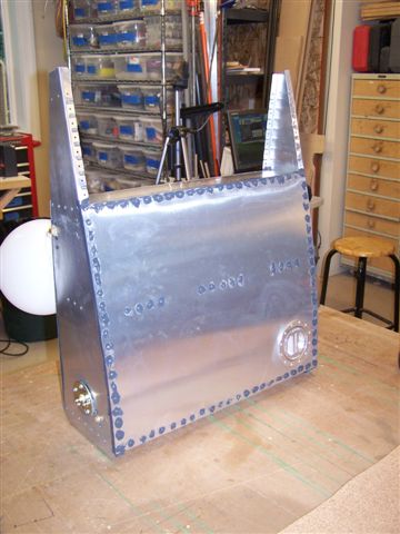

Those are the ACS caps I used. They are the sealed (non vented) kind. They are heavier than I expected. Appear to be quite robust.

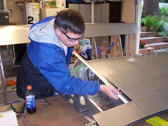

The hole in the wing skin is about 3mm larger radius than the outside of the cap flange. I put a ring of flooring subfloor cork between the tank and the skin. Keep in mind that my tank matches the profile of the wing. I might fill the gap with ProSeal or the “3M 5200” stuff that Brady wrote about.
The ring around the ACS cap had six indents that I used to drill out for the rivets. I then eyeballed it and drill six more holes (for a total of 12). I then ProSealed and riveted the cap to the tank.

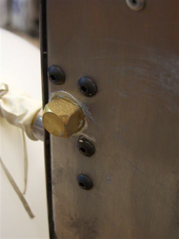

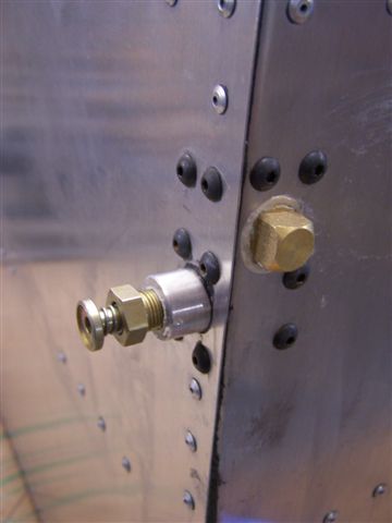

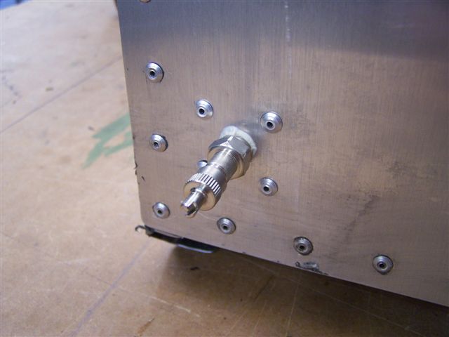

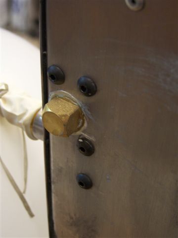

My vent is pretty much as Brady described his (actually I think I stole the idea from him). Except I ProSealed a ” flange to the bottom of my tank and threaded it with a 1/8” NPT. I will screw a vent tube in that eventually.
My fuel outlet from the tank comes out the side so I can keep the fuel lines in the wing. I still have about “ of fuel I can’t get to but at least my drain valve is below the fuel outlet. I heard a rumor that certified planes are required to have a certain about of unusable fuel in the tank – 8oz?

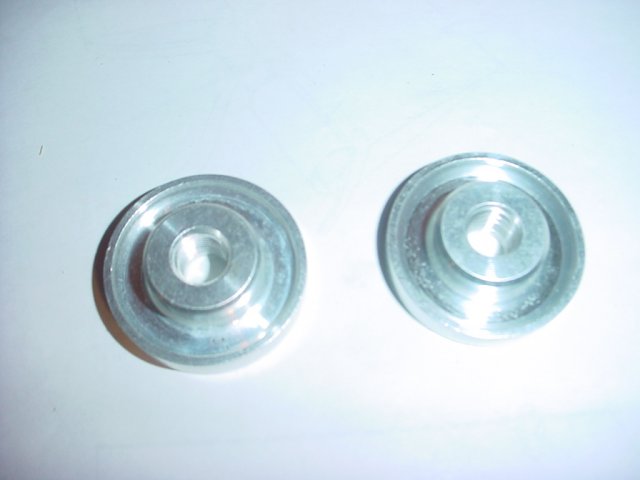

I think the flange I made for the fuel sender was 0.250” AL. I made it using some round whole saws obtained from Home Depot. I had to tap them for 10-32 as you describe. The ring was ProSealed in (but not the fuel sender).

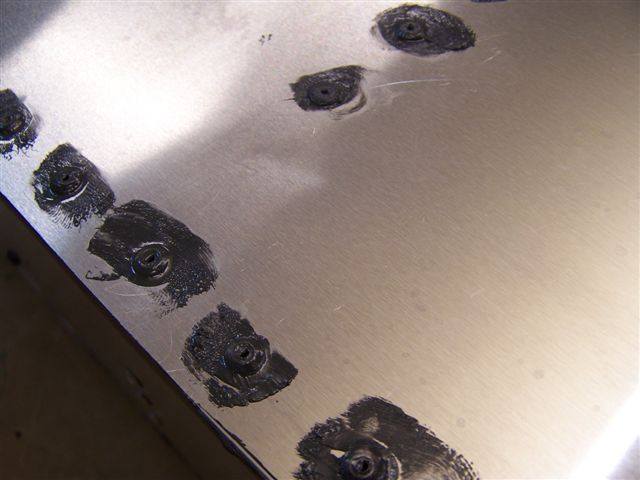

Someone wrote in the archives that the rubber gasket alone would seal the fuel sender. It seemed to me that fuel would leak around the heads of the bolts. I tested this theory and sure enough – leaks around the bolt heads on the sender. I sealed my sender with Permatex #59214 from B&B Auto. I called a Permatex factory guy and he said the stuff is fuel tolerant as long as you let it cure for 24 hours before you expose it to fuel. It will be months before I get to that point.
I rinsed my tanks out with mo-gas before I put them on the wings. I wanted to see if any ProSeal debris would come out. I dumped them out into a coffee filter. The only thing I got was a little bit of lint from the cotton rag I used to wipe them down (with acetone) before sealing them up.
Let me know if I didn’t get to all your questions.
Curt
