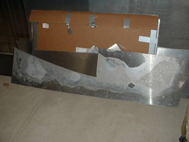

Z-Builders-
For all of you touting the corrosion resistant qualities of T-6, look at the attached picture. This is the only original skin I still have- I keep it around to make L angle out of. The T-6 picture was taken in the garanger, "Other stuff" was taken in the basement. Not exactly severe conditions.
My skins were stored standing upright against the panelled walls of my basement (Where a dehumidifier was running 24/7) in their paper wrapping. When was ready to install them, this is what I found when I unwrapped them. Consequently, I literally had to rebuild 75% of my factory supplied parts from scratch. And yes, the factory T-6 marks are on all the bad skins.
Bill Naumuk
Townville, Pa.
HDS 601MG/Corvair 95%

Posted: Wed Nov 05, 2008 4:14 pm Post subject: Re: T-6 Corrosion Resistance |
I had a piece that got damp in the wrapping paper. Top rear fuselage skin that looked much like that. There was no pitting and it cleaned up just fine with some stuff I found at Home Depot.

Posted: Wed Nov 05, 2008 4:33 pm Post subject: T-6 Corrosion Resistance |
6061 is corrosion resistant, much more so than 2024, but it is not corrosion proof. The paper it came wrapped in is to protect it during shipment. In a damp environment, the paper can hold moisture which can not only promote corrosion directly, it can promote biological growth which can be another source of corrosion. Even with de-humidifiers, basements tend to be damp and if air can't circulate around the metal to purge the moisture, you can end up with a favorable environment for corrosion.
On Nov 5, 2008, at 6:34 PM, Bill Naumuk wrote:

grs-pms(at)comcast.net Guest
Posted: Wed Nov 05, 2008 5:21 pm Post subject: T-6 Corrosion Resistance |
Someone more knowlegeable may correct me on this, but I believe the manufacturing process for kraft paper and for corrugated cardboard results in a finished product which is somewhat acidic. I know that regular cardboard shouldn't be used to back framed pictures or documents for that reason. It probably shouldn't be in long-term contact with any sort of aluminum, even in conditions of low humidity.
Incidentally, T-6 refers to the heat-treatment rather than the alloy itself. The alloy is 6061, so the full designation is 6061-T6. It does give good service in aluminum canoes and boats, so it must be at least somewhat corrosion resistant.

dbrown(at)avecc.com Guest
Posted: Thu Nov 06, 2008 7:10 am Post subject: T-6 Corrosion Resistance |
This is interesting, my top rear fuselage skin looked like that also.
Now I am thinking that it came from Zenith like that. I cleaned with
MEK, then precote and Scotchbrite and it came out fine.

Gig Giacona
Joined: 10 Jan 2006 Posts: 1416 Location: El Dorado Arkansas USA
Posted: Thu Nov 06, 2008 7:50 am Post subject: Re: T-6 Corrosion Resistance |
Just a coincidence. I know how mine got wet (a very small leak during a very heavy rain) and the only way Zenith is to blame is that they packed that particular piece at the bottom of the stack.

naumuk(at)alltel.net Guest
Posted: Thu Nov 06, 2008 3:24 pm Post subject: T-6 Corrosion Resistance |
Dave-
MEK, eh? I tried everything under the sun but that, including to try to
polish it out with Nuvite with no luck.
Posted: Fri Nov 07, 2008 6:27 am Post subject: T-6 Corrosion Resistance |
Bill,
The MEK was used only to remove the grease from fingerprints and
handling. The Prekote and Scotchbrite were what I felt did the trick.
The fuselage was painted about 2 years ago and the wings about 1 year
ago.
I used 2 part NAPA automotive paint. Still looks great.
David
Posted: Fri Nov 07, 2008 3:52 pm Post subject: T-6 Corrosion Resistance |
In other words, you weren't able to remove the corrosion, just prep for
painting.

planes_by_ken(at)bellsout Guest
Posted: Sat Nov 08, 2008 5:47 pm Post subject: T-6 Corrosion Resistance |
Take a look at the metal with a magnifying glass and a bright
flashlight. If there are no pits then it probably is just staining, not
corrosion. Aluminum corrosion products are generally a white powder
that is not too hard to remove. Try cleaning with some Alumiprep 33.
This is what is used to prep for applying Alodine, painting or welding.
The Alumiprep should foam up and bleach the surface to almost white.
Flush with plenty of cold water. Remember to dilute with water as
directed. You don't need to use Alodine afterwards unless you want to.
A natural layer of aluminum oxide will form quickly and seal the surface
back up. Not to open old threads but.... 3M maroon scotchbrite is
aluminum oxide based and is OK on aluminum. Don't use silicon carbide
sandpaper on AL. It can lead to corrosion (per AC43.13 2A) 3M offers
an aluminum oxide wet or dry paper (Imperial) that is no more expensive,
just had to find. I you want to see some impressive corrosion I could
post a image of a Cessna wing mounting block with intergranular
corrosion. Flat out 6061 is much more corrosion resistant than 2024.
It is all we can do to prevent 2024 from corroding. Most single engine
Cessnas prior to the 90's were not zinc chromated unless equipped to
have floats. We have it easy.
