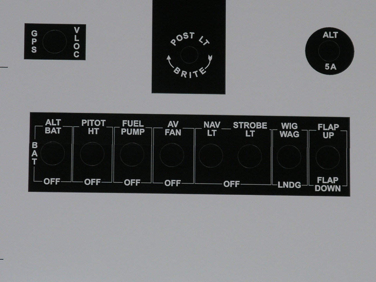

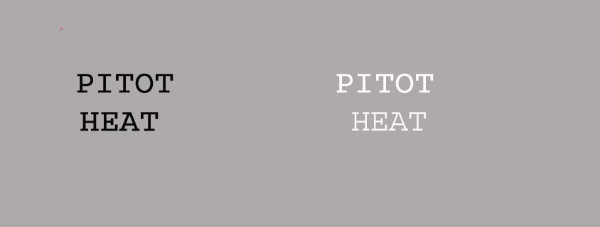

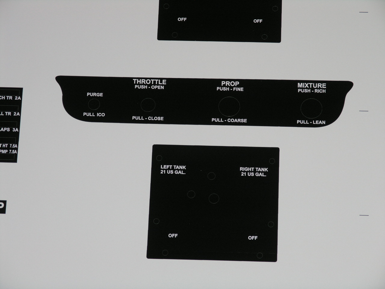

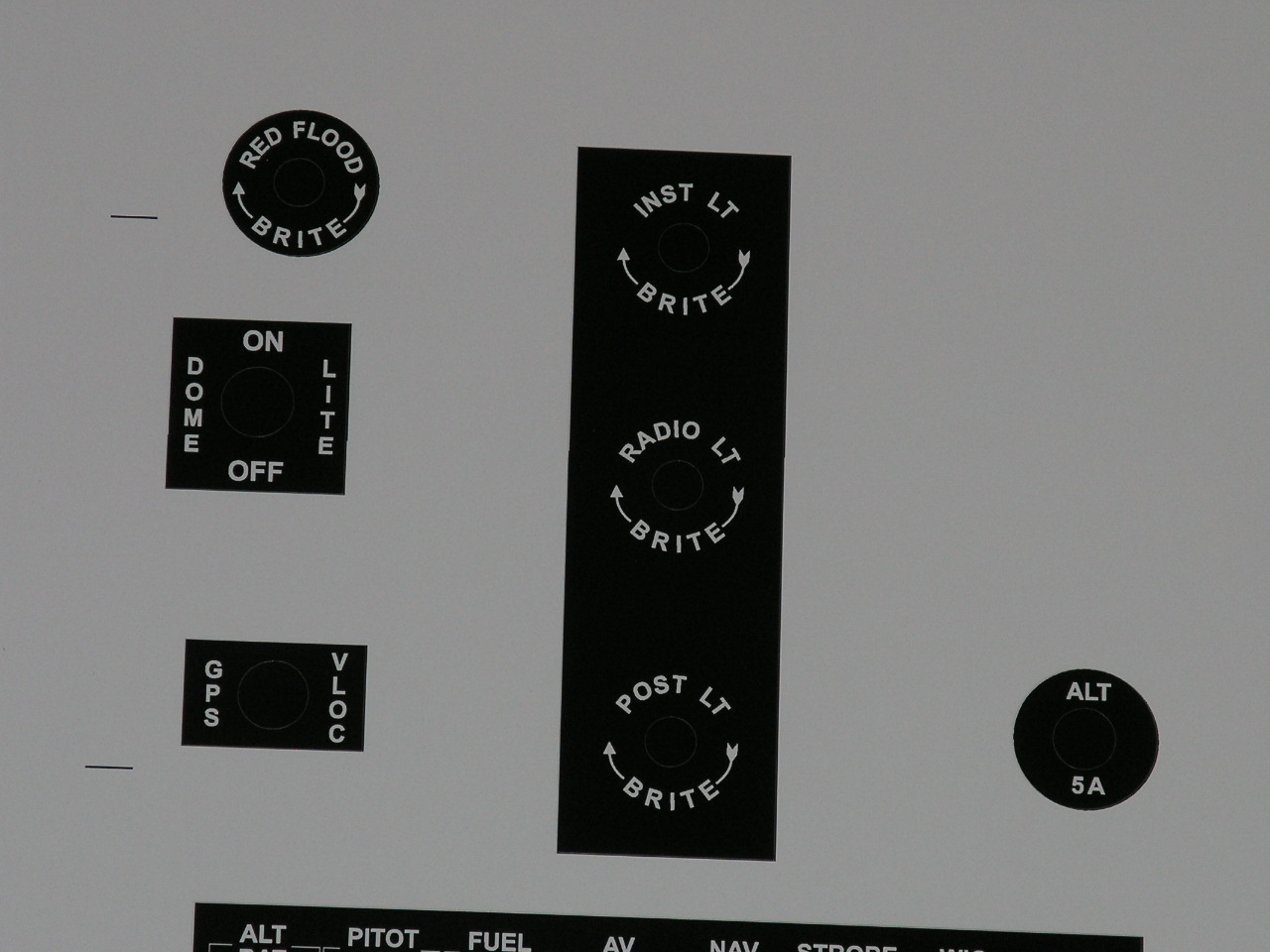

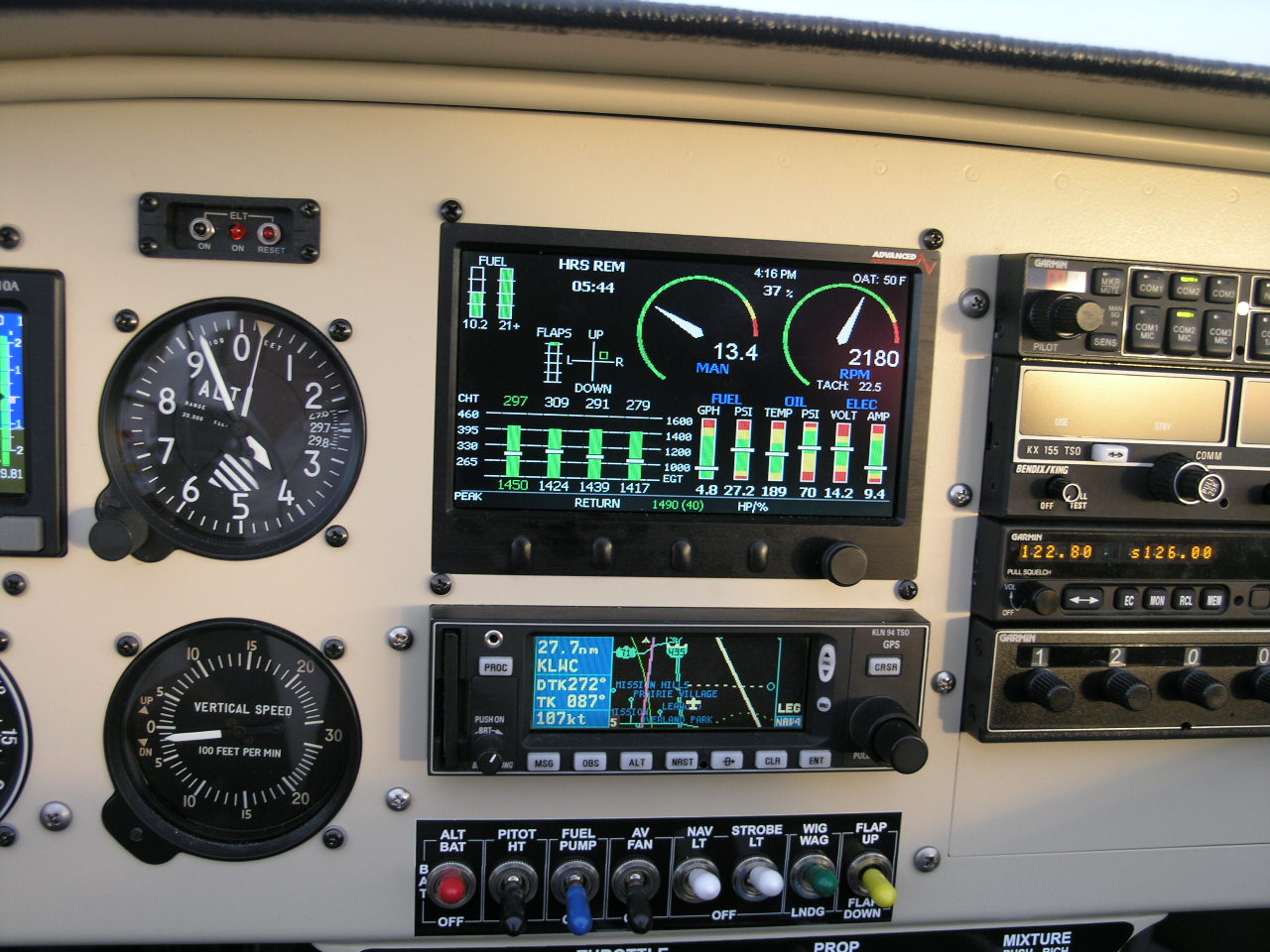

Attached are a few examples from my project.
Bill

Henry good looking work what did you use to make these great job!
Jim Wickert
Vision #159
Flagstone(at)cox.net
PostPosted: Sat Nov 01, 2008 12:55 pm    Post subject: Sub Panel Labeling Reply with quote
Bill:
Would you mind posting details of how you made your labels.
hammer408(at)comcast.net
