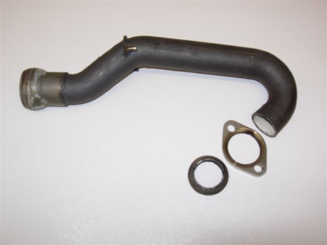

Remi,
The front port pipe on my 912S engine had the pipe and bell fitting (the
flange that is bolted onto the engine) come apart at the weld (see picture
as this explains better than my words). I realised I had a problem when
taking off and I heard a noise that I had not heard before. The pipe was
able to rattle in the flange fitting but did not fall off and was only
observed once the engine cooled and I was able to grab the pipes and shake
them.
I did not loose power but aborted the take off due to the change in noise.
The engine has done 120 hours.
Hope this helps.
Steve Pitt
G-SMDH

Steve,
I had the same break on the #3 pipe at 400 hours...
Jeff - Baby Blue

Same on mine (front left) at approx 100 hrs.

Willie and all,
What I surmise is that the alignment of the muffler is the culprit.
Since the #s 1 & 3 are catty-cornered from each other and neither has an
adjustable link, one tends to stand off the muffler if the #1 pipe is
not perfectly adjusted. This situation is what caused the exhaust leak
on Baby Blue, which ultimately overheated the ignition coils and caused
the rough running incident I encountered.
What I see happening is this: The ball end of the pipe is not fully
seated into the muffler, allowing the pipe to vibrate and setting up a
resonation which ultimately leads to the cracks. I may be totally off
base, here, but it makes sense to me...
Jeff - Baby Blue

Thank you Steve,
Apparently the cause is a defective weld.
Best regards
Remi
