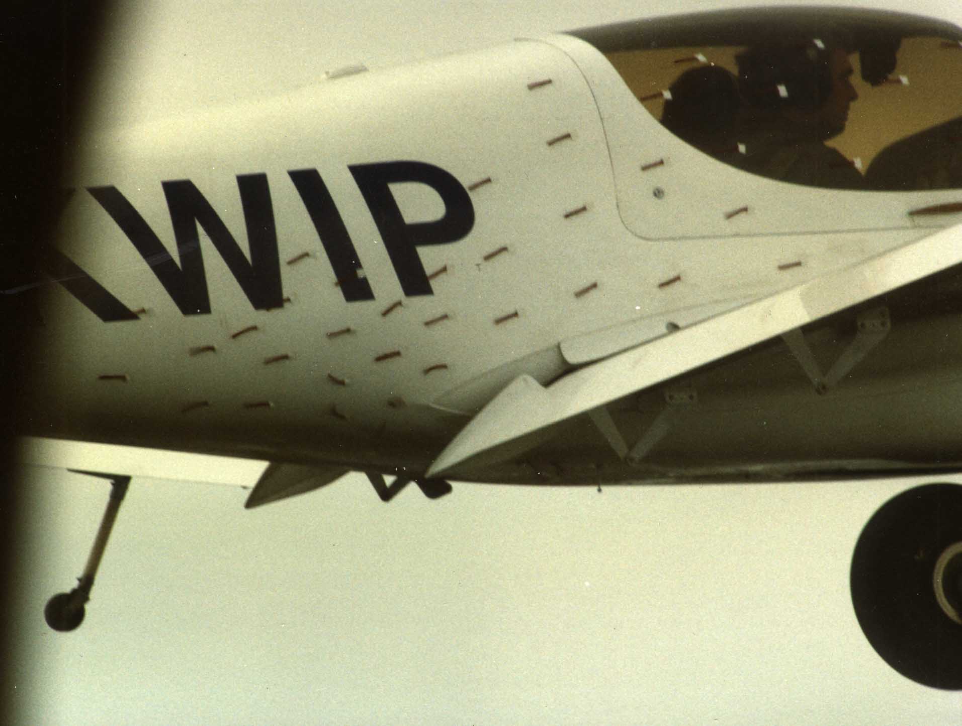

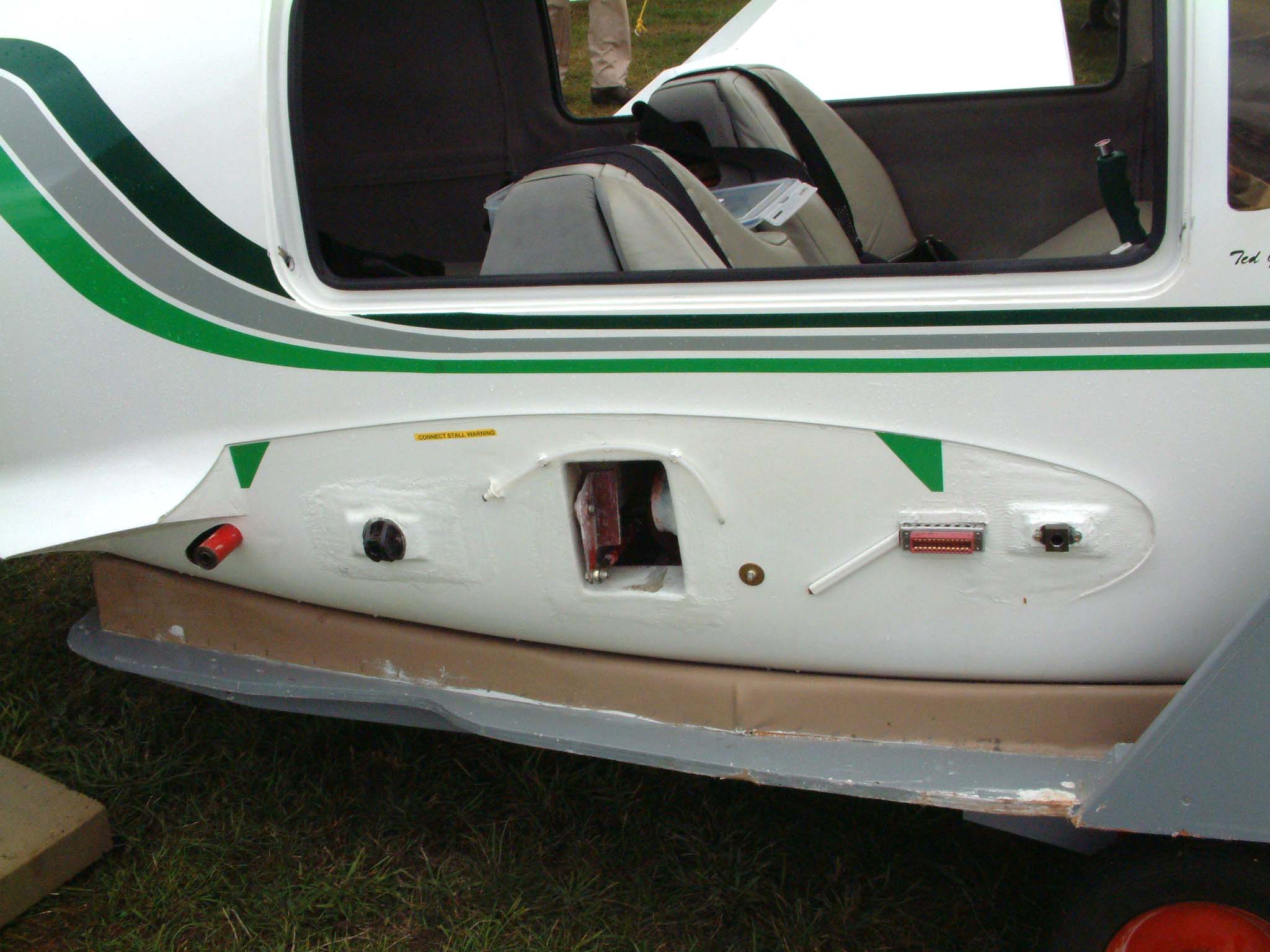

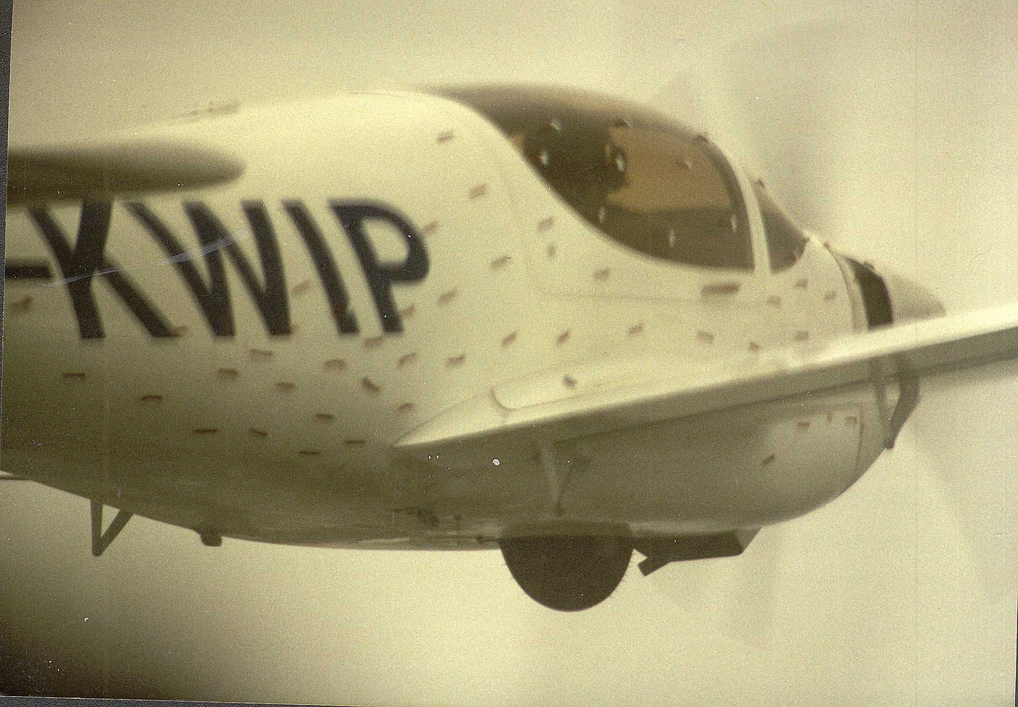

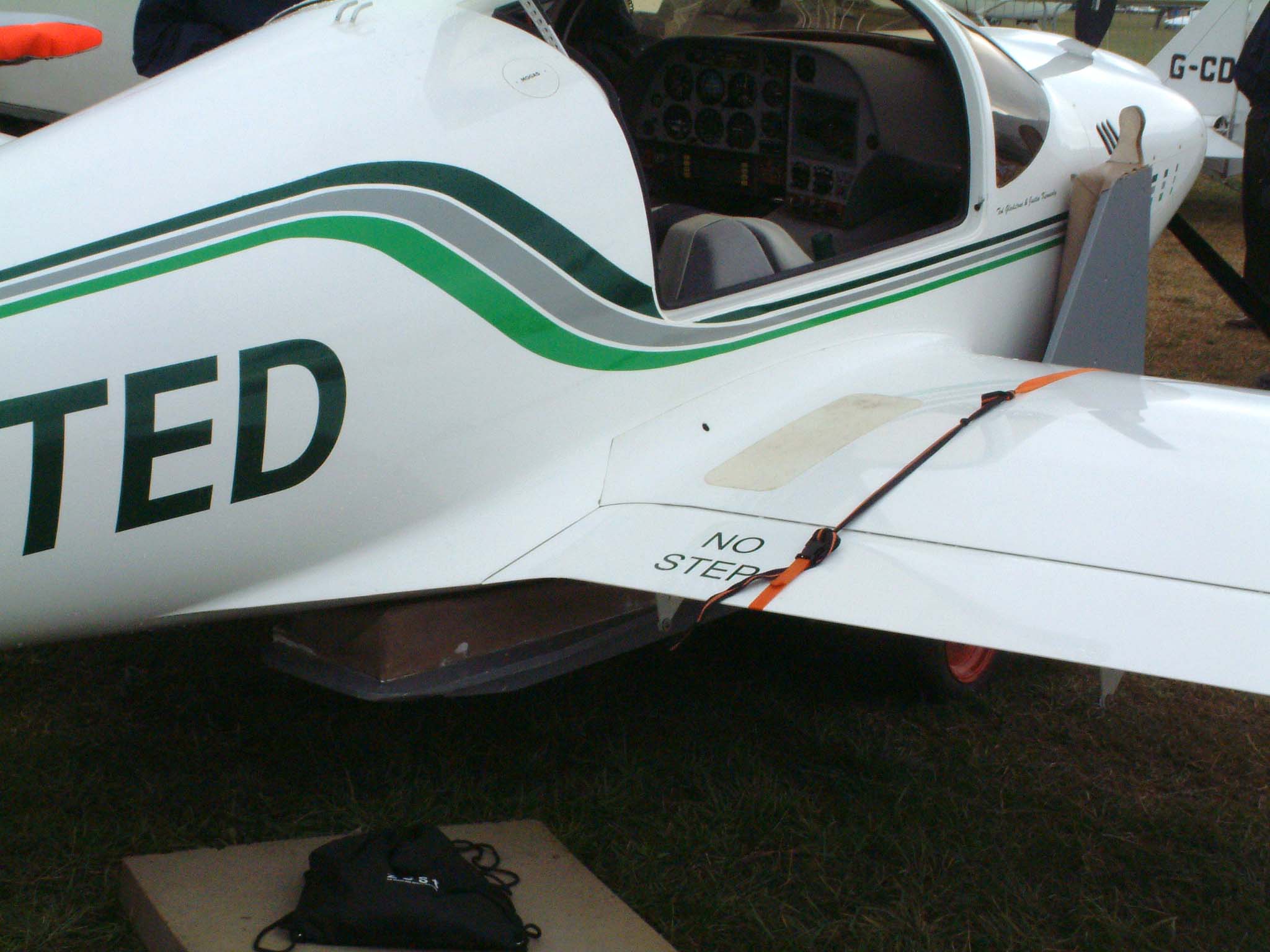

some pix for you to look at. You should also look at Justin Kennedy's
and Fred Klein's design. Very nice
Graham
