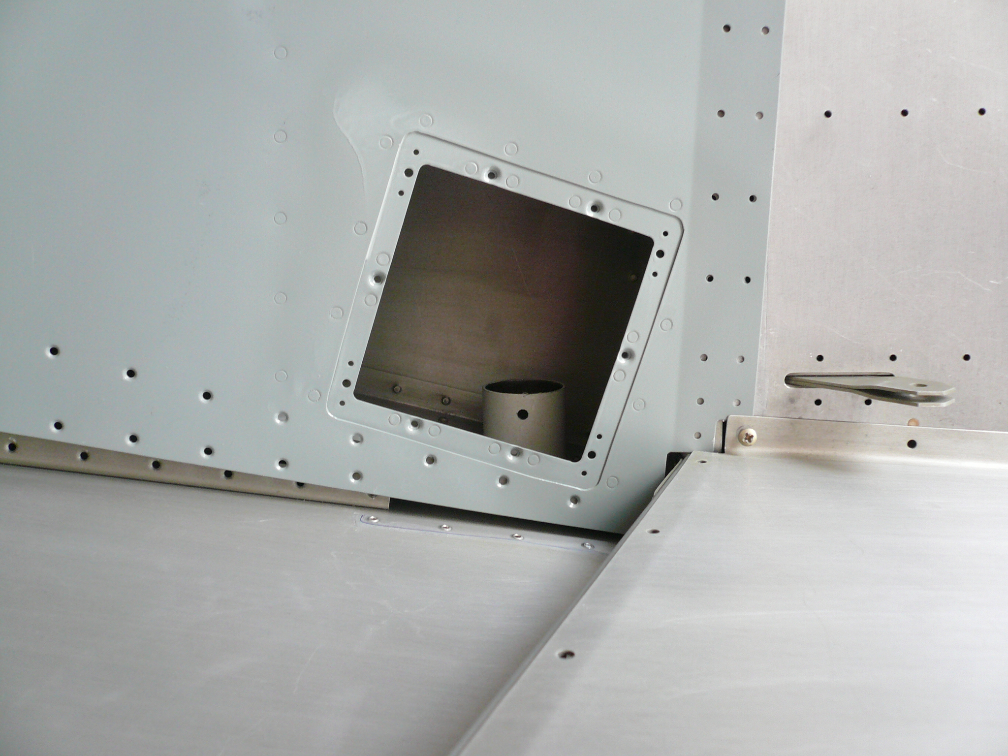

I FITTED my steps in a long time ago. I strongly urge builders to:
1. Nut plate the entire rear baggage / back seat area - OR
2. Put an inspection panel in above the steps - to repair or replace the steps and check for corrosion on an ongoing basis
I put the inspection plate in above the step bolts. This allows you to clean corrosion in the step area, upsize the step bolt as needed, inspect the area for corrosion, add an additional bolt, and remove the step (during the build) so that you do not have sore shins for the next year.
As a 1200 hr pilot my observation is that the RV10 has (to my view) three major flaws. 1. An un-inspectable rear and front sub-floor area 2. permanently glued and secured windows and 3. badly molded vertical opening doors. ------ At least you can cure flaw #1 - do it......

PostPosted: Wed Oct 22, 2008 7:45 pm    Post subject: baggage area Reply with quote
Oh yea - while you are at it - run some flex conduit for future wiring and put a nylon line or tent cord in the conduit

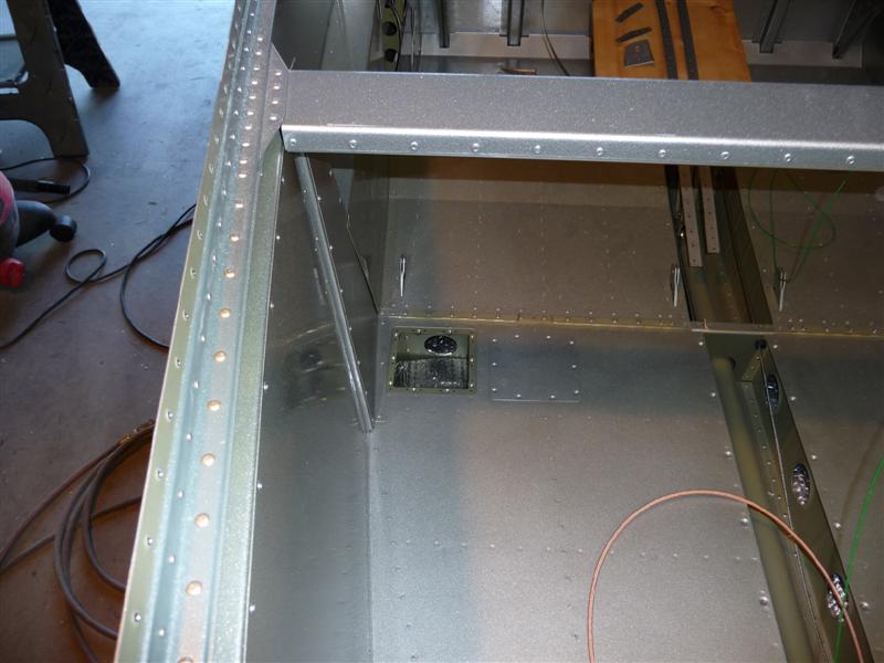

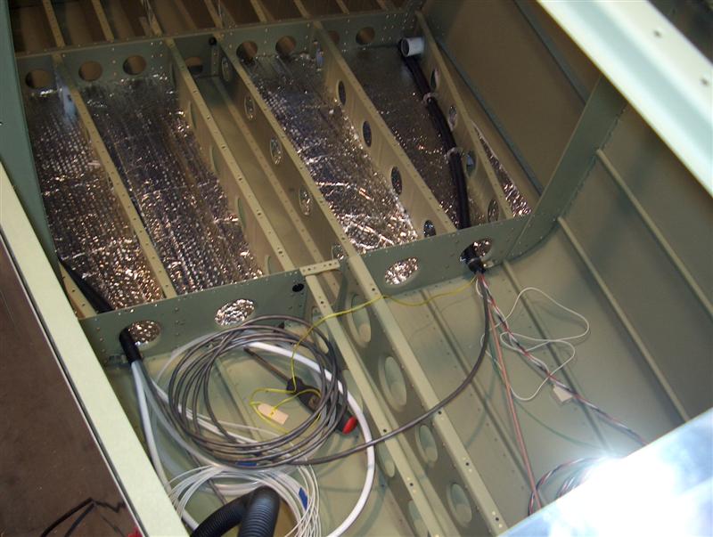

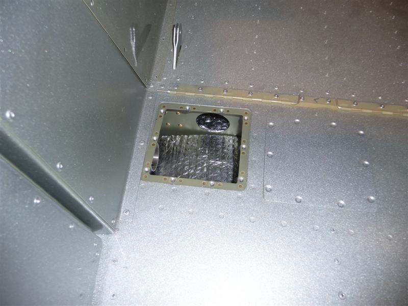

PostPosted: Wed Oct 22, 2008 8:11 pm    Post subject: Re: RV10-Steel Bits - paint or plate Reply with quote
I second or third or nth the access cover (keeps you from having to lose weight!)
Mike are you aware that your access cover is going to be under the side panel? The side panel is supposed to be pop riveted through the floor which will put a rivet or two right through your access panel.
I attached some pics of my install. I was pretty careful to make it accessible after the side panel is installed. A side effect of that though is the bolt cannot be dropped in from the top. You cannot tell from my pictures but I removed the bolt and redrilled it horizontally. This will allow me to remove/insert with my access plate slightly askew like it is.
-Ben
