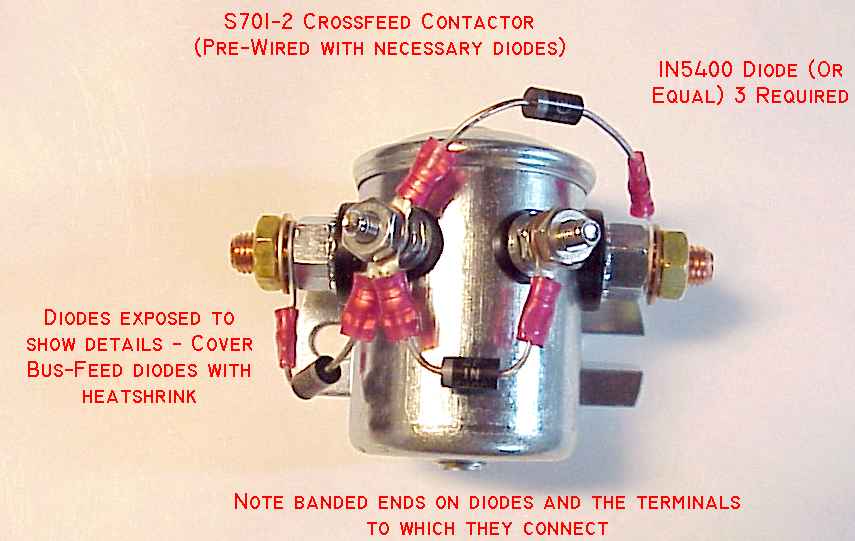

I have the B&C S701-2 Crossfeed Contactor (starter) and just need to know what wires go to each contact. Really the ones in question are the two small contacts. Neither has the "S" or "I" labels that I've read everyone referencing. Noone at B & C could tell me, so hopefully someone has this wired up already. I've attached the photo that is on the B & C website with the can lid on the top, and one diode going from the left small contact, over and above to the right large lug. This particular contactor has the 2 large lugs on each side and 2 smaller lugs in the middle. I also tried Bob Nuckolls, but email address was no longer valid. Thanks,

Don, the "S" is to engage the contactor and goes to the switch. The "I" would be for a "starter engaged light".

Yep, you're absolutely right.... and if the contactor had either the "S: or the "I" markings, I'd be in great shape. Thanks

Hook up the fat wire to the battery, but leave off the one to the
starter.
Apply 12v to the little terminals one at a time.
Use the one that makes it go click for your starter switch wire..
DLW
