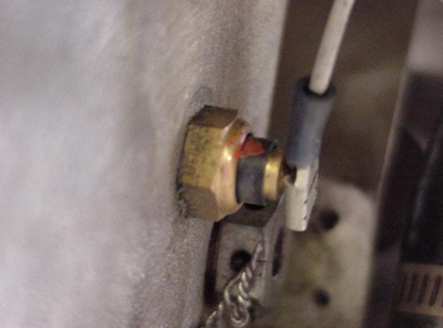

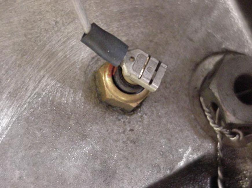

For the oil and head temp senders – either by luck or design a female spade “fast-on” connector works. Two pictures (from a Jabiru installation manual) attached.

Yes spade connector is the correct type for the temp sensors......forgot to put that in last time.
