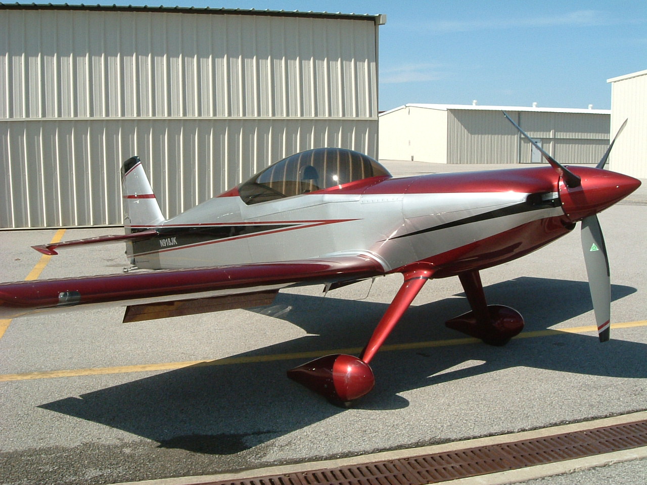

Please don't pull that cowl for me. I await your confirmation. BTW, send me a pic of yours so I can put a name to a Rocket.
Jim Stone
PS Attached is a pic of my ride

Lee Logan
Posts: 86
PostPosted: Wed Oct 08, 2008 1:54 pm    Post subject: Airfilter problem Reply with quote
Jim: Your Rocket continues to amaze... It's really beautiful!
Lee...

jrstone(at)insightbb.com
PostPosted: Wed Oct 08, 2008 2:05 pm    Post subject: Airfilter problem Reply with quote
Thanks Lee!
