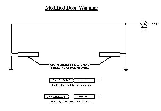

The door warning diagram Vans has uses a normally open switch to activate a relay. What happens if the relay doesn't work? I decided to take the relay out of the circuit. I checked with Mouser and found they sell both the normally open and normally closed switch. I purchase 4 normally closed magnetic switches from Mouser part number 540-MP201702. These are just like the magnetic switch Vans sells but is normally closed when the magnet is pulled away. With this switch I am able to eliminate the relay in the circuit. If any switch senses the magnet in the door latch moving away from the switch, a ground is supplied to the warning light and lights it up. Any thoughts on my idea. I am using LED annunciator lights which require very little current.

PostPosted: Sat Oct 04, 2008 4:47 am    Post subject: Re: Door warning switch Reply with quote
Gary,
This is the electrical circuit using the normally closed switches.
Greg...

PostPosted: Sat Oct 04, 2008 7:03 am    Post subject: Door warning switch Reply with quote
When I first received the Door light warning kit and looked over the schematic, I thought "why so complicated?"
Vans is usually very conservative and will default to the KISS principle unless there is a good reason to do otherwise. There is a very good reason for the relays and the seemingly more complicated circuit in the original setup. With the Van's circuit, all parts of the circuit MUST be functioning perfectly in order to extinguish the light. The door unlatched or a failure of ANY component in the circuit will keep the light illuminated as long as there is power. If a wire breaks, the light will remain on; if the relay fails, the light will remain on; if any of the switches fail, the light will remain on. The Van's circuit requires power to the relays to keep the light extinguished.
Changing the switches to normally closed defeats the original purpose of the Van's design and introduces a failure mode where a break in the switch circuit will give the indication that all is well when in fact it may not.
I will not be using the relays but I will be using the normally open switches. The AFS EFIS has inputs for things such as this and wired to normally open, can trigger a master alarm whenever the input line is NOT grounded. This configuration adheres to the Van's principle. If there is a break or failure of any component in the circuit, the light (master alarm) will remain illuminated.

PostPosted: Sat Oct 04, 2008 8:11 pm    Post subject: Re: Door warning switch Reply with quote
Interesting explanation. This is why I uploaded the diagram and idea. I needed some thoughts into this change before I wired it in. Thanks for the replies.

PostPosted: Sun Oct 05, 2008 4:22 am    Post subject: Door warning switch Reply with quote
Greg,here's a thought.
Put little green LEDs on the panel, across each NC switch. If the door
isn't closed, no 'green to go', and you'll know immediately which door is
causing the problem. The LEDs will draw less current than the relays which
may be significant if you lose alternator power. I like simplicity (and
weight) too, and that's my thought.
