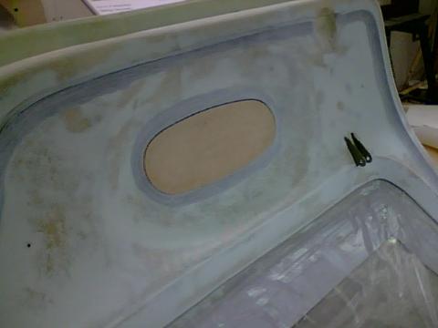

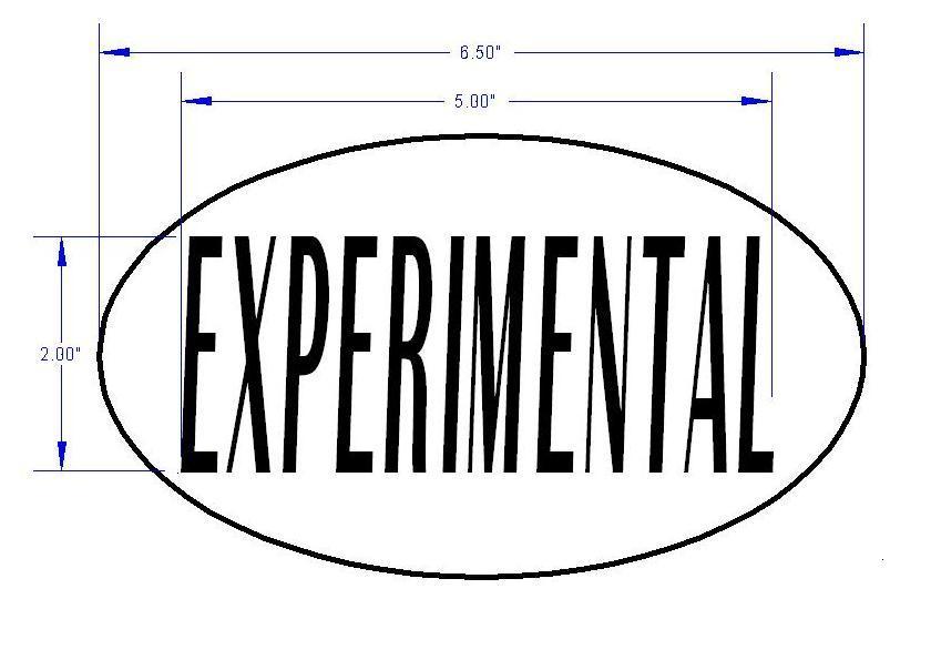

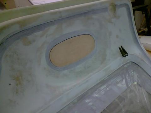

Since I was doing a custom interior, I didn't really want to use the standard "Experimental" sticker or the size of the letters. I checked with EAA about the FAR and what is really required. They told me the wording has to be at all passenger entrances into the aircraft. The great thing I found out was that the only size requirement for the EXERIMENTAL is it has to be at least 2" tall and not taller than 6". This was perfect. I used my computer and condensed the wording down to a 6" length but still had the 2" height. A wood placard was made with the lettering engraved in it and will be inset into the upper interior door panel. I attached some pictures on what I did.

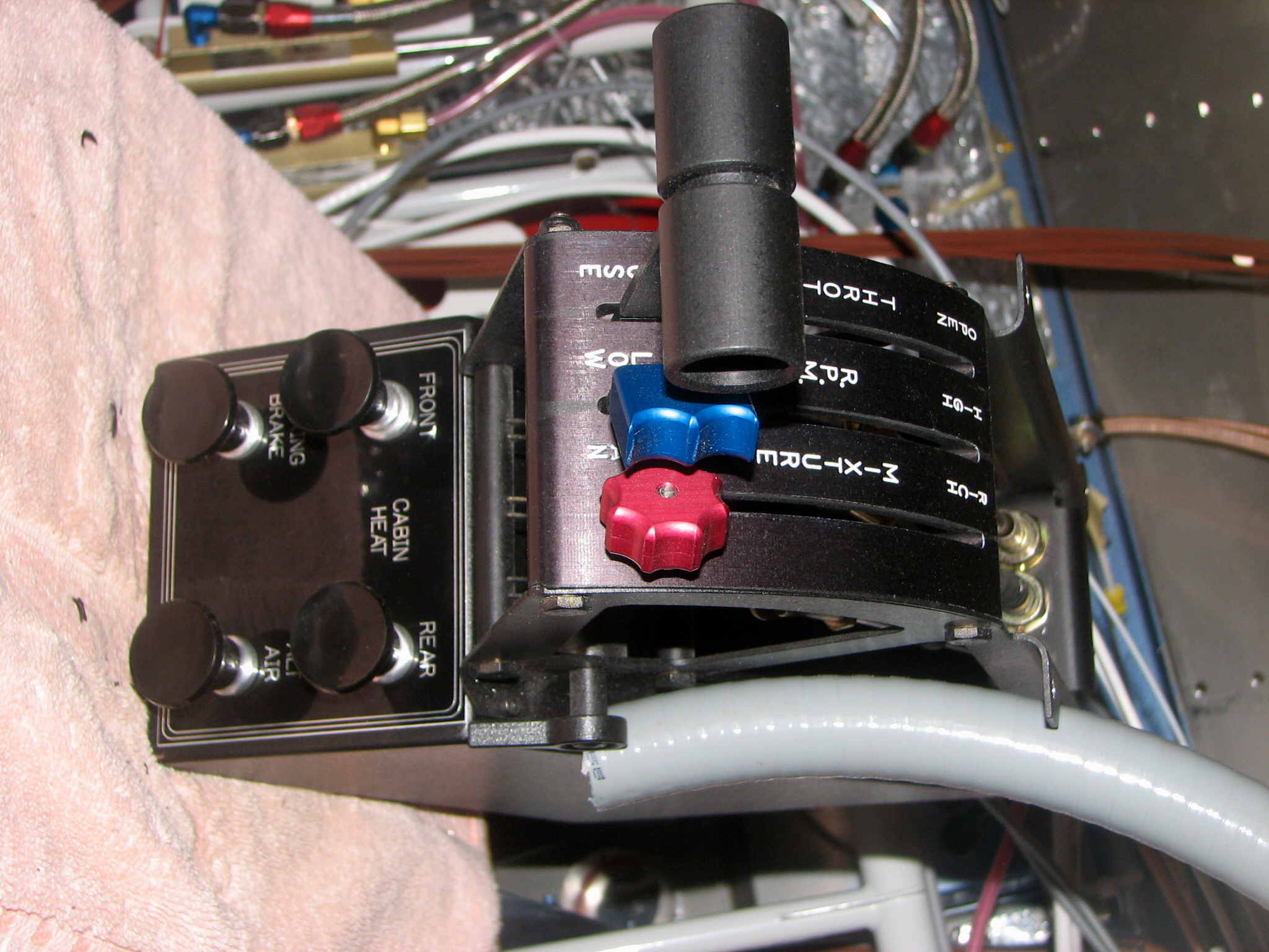

Thanks for the great idea. I have a friend who does engraving. Was not looking forward to sticking that god awful looking sticker on each door. I'll have him make up some nice looking aluminum pacards about the same size you made. He can do them in most colors. Anyone else interested, let me know. I attached one of my HUGE pics, sorry, haven't had time to do the conversion.... it's one he made for my cabin heat, emerg brake and alt air.
