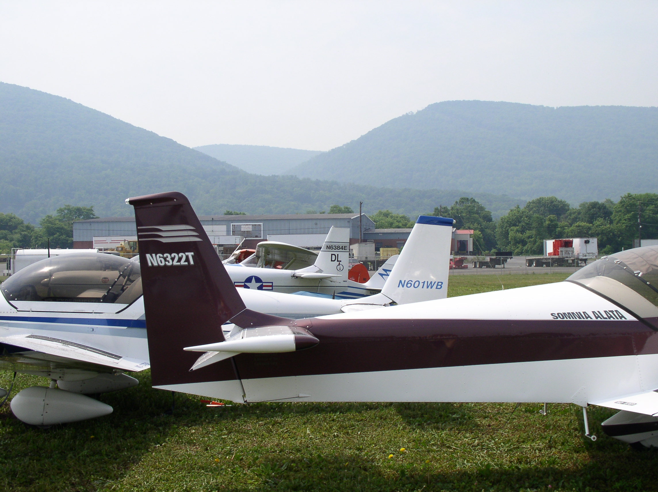

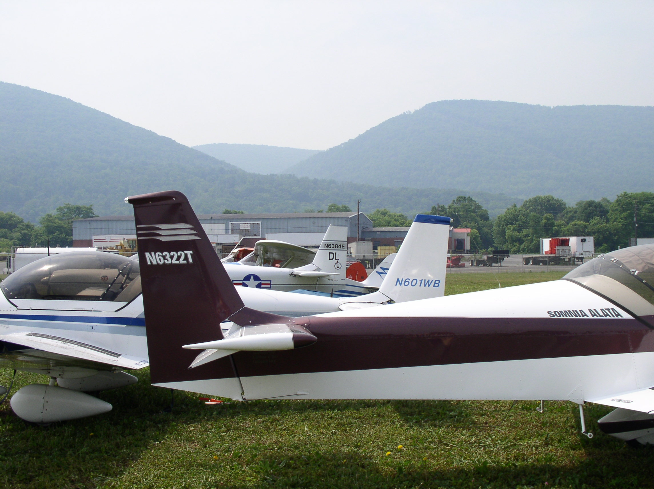

I'm going to assume that you are building the older side opener, correct? If so you will find that the flashing will have to be trimmed so that as the tube along the top longeron pivots in the nylon blocks, the plexi and the flashing are trimmed to clear the side skin. Best way to see this is to stand to one side and have someone you trust raise the other side of the canopy and see for yourself. This is probably going to be a trial and error fitting. You will end up with quite a gap that you'll fill with some type of foam insulation - either that or have chilly, breezy airtime.
You can see that typical gap of the older side opener on N601WB in the attached. Sorry I don't have a closer view. Note the cutouts for the nylon blocks.
Good luck...jeff

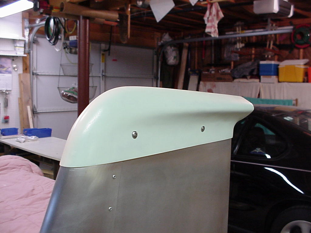

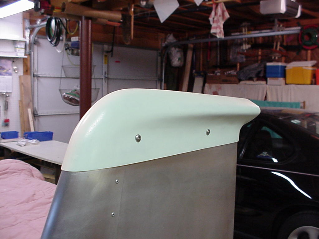

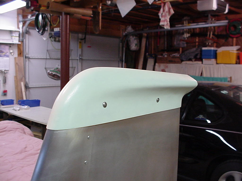

This is not related to your post, but I love that rudder tip. Did you make it yourself or is it for sale somewhere?
Pavel
Pavel,
I made it myself following an examination and pep talk from Wayne Beattie who owns that very nice N601WB. I can send you a bit of tutorial on it if interested. It's of medium size and I don't know if you hotmail address will take it. If you have another email contact me directly.
