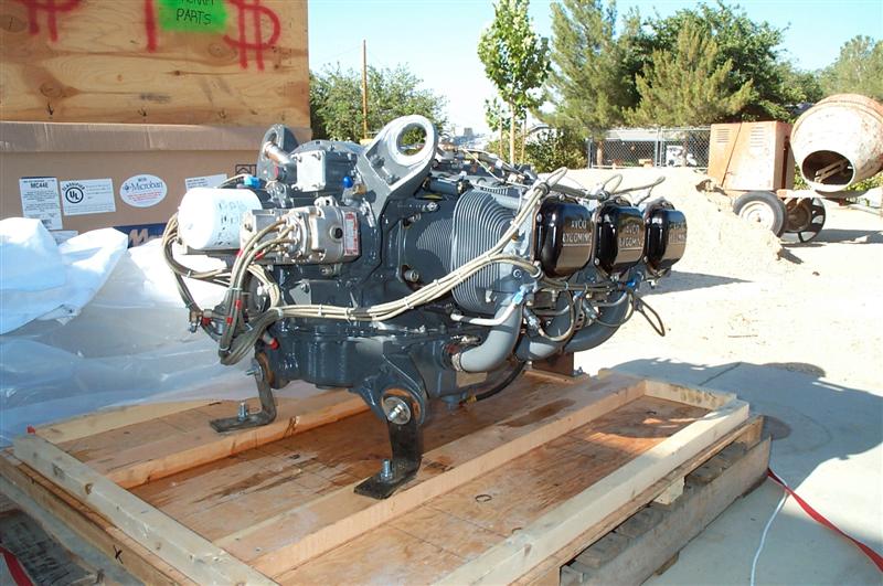

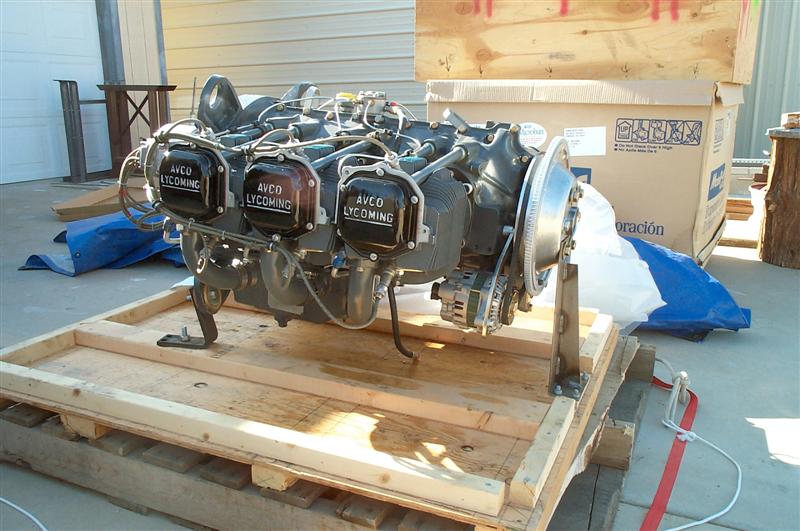

PostPosted: Sun Sep 28, 2008 12:16 pm    Post subject: engine transport Reply with quote
Here is how the engine I bought from a private party was secured for shipping. (Plywood box cover removed)

PostPosted: Sun Sep 28, 2008 5:06 pm    Post subject: engine transport Reply with quote
I'd see if anybody near you has recently received an engine and still have their shipping crate. You could just borrow (or otherwise acquire) it and ship that way. That's the safest way I can think of. Might be an engine or airplane shop near you that has a crate they would let you have. Maybe worth a couple of calls. I'd give you one but I usually just keep one on hand in case I need it and disassemble the rest.
