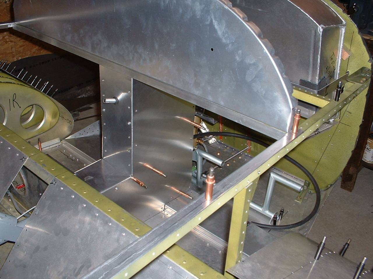

Just sprung (Sprang? Emptied my checking account!) for a Dynon D-100. It comes with a remote compass. I'd normally ask EAA, but they're closed today. Do I still have to have a whiskey compass? I have a nice Airpath, but what's the sense of taking up panel space and weight if I don't have to? The D-100 also has a build in voltmeter, so I might have some brand new or like new instruments up for sale.
I've been to several hardware stores and spent hours on the net but still can't find a handle for my header shutoff. Well, I could use a plumbing handle, but you can imagine the razzing I'd take for the "H" or "C". Has to fit over a 1/2" rod. It shouldn't be threaded- I'll either modify it with setscrews or a drift pin. Any ideas? Picture attached. Remember, on an HDS this is all scratch-built stuff so I don't have a clue.
Finally, I haven't been able to find a decently priced, functional used Mode C transponder for weeks. Any leads appreciated.
Thanks, guys.

I have a $10 Walmart compass stuck to my canopy. It's an Airguide brand, weighs a couple of ounces and is marked in degrees as well as the eight cardinal directions. It has compensators to zero it out and it works like a charm. If your DAR won't sign off without a compass, this one should do fine.
For the fuel valve, you could grind flats into the end of the shaft and drill and tap the center for a screw and then the handle off a ball valve might fit it. Or you can make a handle out of a piece of flat stock by cutting a hole in one end to fit the end of the shaft and secure it with a screw and washer.
For transponders, you might try eBay: http://tinyurl.com/3fuh9v there's a few of them listed there.

The regulations (91.205) require a "magnetic direction indicator" but they do not specify what type of indicator is required, so any device that senses the earth's magnetic field and displays directional information derived from that sensor should meet the requirement. Nowhere does it specify that a wet compass is necessary. Technically, 91.205 only applies to aircraft with standard airworthiness certificates but I believe the operating limitations issued with an experimental certificate state that 91.205 must be complied with.
My $10 Walmart compass is the only magnetic direction indicator installed in my airplane and it's there primarily to satisfy the regulations. The remote magnetic sensor in your Dynon should also satisfy the regulations but that doesn't mean the DAR will sign off on it. When my plane was signed off, I had an vertical card compass installed so I don't know what he would have thought of the Walmart compass. I bought the Walmart compass after being unable to properly zero out the very expensive aircraft compass in a couple of different locations on the panel. It might have worked mounted on the canopy where I now have the Walmart compass but it was too big and heavy to mount there. I sold the aircraft compass on eBay and kept the Walmart compass in the airplane.
