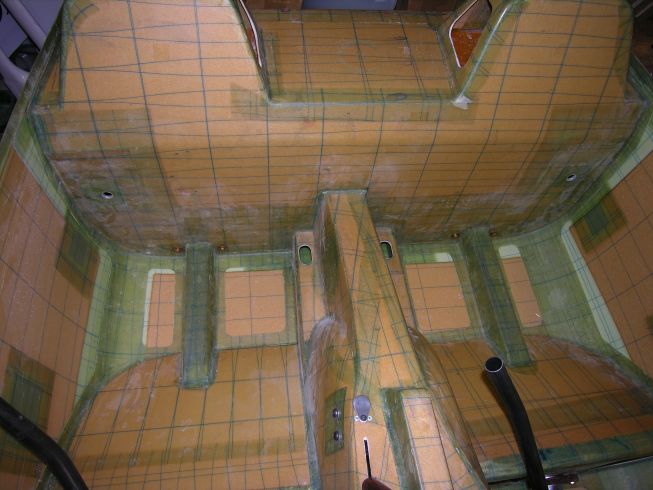

I attach 6 fairly small pictures which I hope illustrate what I'm
talking about.
I have fitted the bearings for both ends of the CS05 torque tubes and
was pretty happy with the way it was all going until I put the
cockpit module into the lower fuselage moulding (see picture
DSCN2491.jpg) to do the check of stick movement as advised in the
manual (page 13-10). If I don't sit in the CM, all is fine and
movement of the sticks is constrained only by the cockpit sides and
tunnel. However, when I sit in it, the movement is considerably
reduced; with only about 100mm deflection left or right from centre
at the top of the stick, there's a graunching noise as the corners of
CS07/08 scrape against the fuselage floor.
You'll see in the picture that the outlines of the brown foam inserts
in the lower moulding don't seem to have any real relationship with
the various cutouts and shapes of the CM. I'd have thought that
perhaps they would line up in places. They are not even symmetrical
port & starboard (the seats, on my CM anyway, have slightly different
shapes P & S).

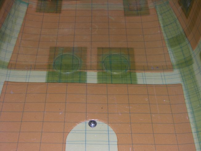

The cockpit flange at the bottom of the seat backrest is supported by
only fresh air, in the middle of the green area across the middle of
picture DSCN2496.jpg, and any pressure on the seat pan will bend the
CM down into that depression. That causes CS07/08 to touch the
fuselage floor where the small black marks can be seen on the brown

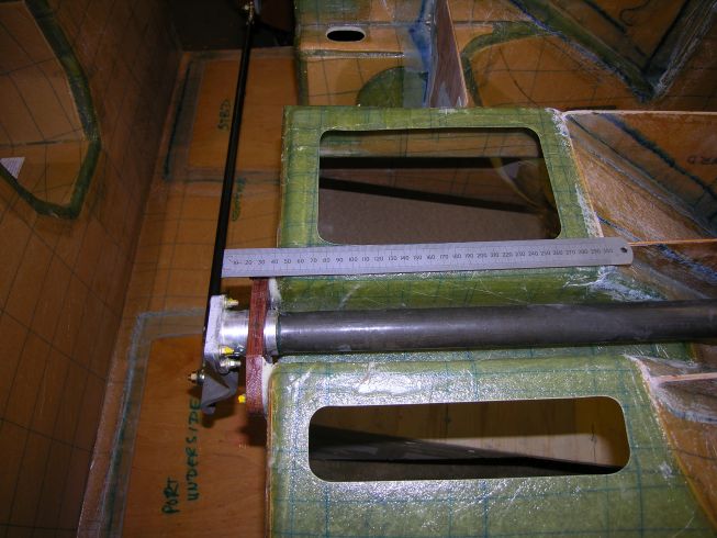

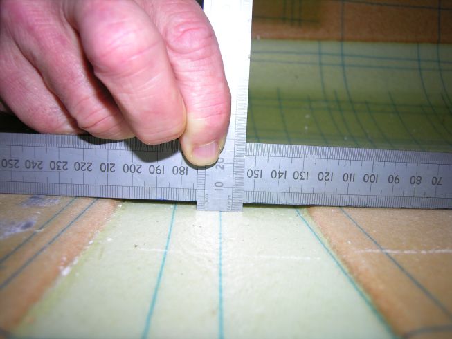

area at the rear of the green stripe. I checked that the clearance
for CS07/08 is correct (~6mm) as per the manual (picture
DSCN2501.jpg), but the depression in the green stripe is about 4mm
deep (picture DSCN2513.jpg) so if the CM is pushed down ito that
locally the clearance will be badly compromised.

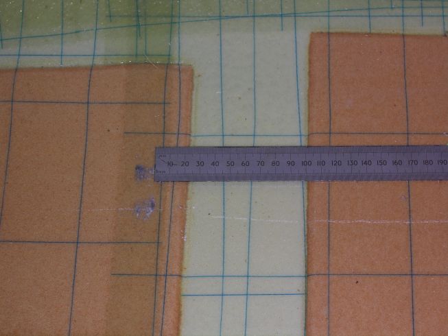

Picture DSCN2515.jpg shows the width of the green depression, with a
ruler placed against the port CS07/08 witness mark. The depression
shows the same ruler positioned on the CM underside against CS07,
demonstrating that the CM flange across the seat-backs falls between
the 25mm mark and the 100mm mark.
I think the engineering solution is to put packing between the CM and
the fuselage where there is no foam layer, so that the Redux will not
need to bridge the full 4mm gap. But what packing? It's got to be at
least as strong as the Redux. Maybe I should go the (expensive) route
of putting in a layer of Redux first with release film to fill the
gap, as I did on the ribs when closing the wings.
Has anyone else found this problem? Or is my CM/fuselage moulding a
mismatched pair?
All input appreciated!

the join areas you will highlight all places needing attention. Scrape
off all surplus Redux which has squelched out and trowel this spare
redux into area's where there's gaps or shortage ensuring the width
areas are suitably abutted with one or two LOOSELY applied pop
rivets.(Rivets only partly extended)Wipe out areas of remaining surplus
and leave to cure. Bingo!
IMHO do not pull the flanges of the CM down where they are gapped
because:-
a) you stress everthing up
b) you make indentations on the outer fuselage surface needing filler
to fill them.
You will ultimately use less weight of Redux than the larger areas of
filler needed and for my money I'd rather ride on Redux than filler as a
structure !
Further don't mess with release agent or cling film you will not get a
good bond, I say again just fill all the gaps with trowelled Redux.
Bob Harrison G-PTAG

At 2008-09-23 09:03 +1200 Tony Krzyzewski wrote:
| Quote: | Rowland, I don't think that you have a problem. There is a lot of
flexibility in the bottom molding until the cockpit module is bonded in.
I did a similar "pre flight" test sitting in the cockpit module before
it had been bonded in and had exactly the same result. Once the module
is bonded everything stiffens up quite considerably and you'll find that
the clearance that you currently have without the weight of your body on
it will be maintained.
Tony - that sounds good theory, but how in practice do I ensure that
everything stays where it ought to while doing the cockpit module
bonding?
I haven't yet done all the drilling and cleco-ing that is called out
in the manual page 11-6 (trial fit of CM) to fit the CM as closely to
the lower fuselage moulding as possible, and fear that I could easily
make things worse instead of better during that process. It says
"drill and cleco other areas until your cockpit module is a snug fit"
but I can't see how you get a snug fit of the relatively flat CM
surfaces against the fuselage moulding which goes up and down at
every edge of the brown foam inserts.
The manual also says "Use as few clecos as is necessary to fit the
module to the bottom moulding. Remember that when you come to bond
the module into the fuselage bottom moulding you will be able to
locally weight down any small areas that need it". If I were to weigh
down the aft end of either seat-centre tunnel, that would ruin the
CS07/08 clearance.
Why doesn't the area of the CM around the CS06 rear bearing actually
rest on the fuselage floor? It seems crazy to take care setting up
the clearance for parts at the aft end of the torque tube, and then
leave it dangling in fresh air.
regards
Rowland

At 2008-09-23 16:21 +1000 Kingsley Hurst wrote:
| Quote: | I had the same problem with the bottom corners of the CS08s contacting the
fuselage floor. My solution for this was to locally remove the inner glass
plies and then to sand out the foam
Kingsley - thanks for your message. I thought about that , but I
think I'd need clearance from an inspector to proceed with that.
| Quote: | I also filed away any excess material on the bottom corners of the CS08s
I'd only get about 1mm or less by doing that - they're pretty close
to the screw heads already, although any extra clearance would be
welcome.
| Quote: | from memory, all of the cockpit module parts to
be bonded should mate with glass only sections in the fuselage. It
his is not the case, would
removing some extra material from the module allow this?
All the CM flanges around the seat area (and the ply thigh-support
ribs) mate with brown foam areas on the lower fuselage moulding - it
covers all the central bottom area of the lower moulding (see the
pictures attached to the first posting). The only CM bottom flanges
NOT resting on foam are the outboard and rear edges of the seat pan,
although the one at the port side is wide enough to catch the foam at
its inboard edge.
| Quote: | Is this because some parts of the module are resting on foam sandwiched
areas of the fuselage as mentioned in my last comment
Yes - see above.
| Quote: | if the module is lowered such that the
cockpit flange at the bottom of the seat backrest contacts the glass only
area, the interference with the bottom of the CS08s will be worse
Yes. But the module doesn't lower into that position naturally; only
if pressure is applied at the back of the seat pan does the CM
distort to allow that flange to contact the plain glass area of the
fuselage floor.
| Quote: | Hope I have made SOME sense Rowland
Yes, I think we are on the same wavelength, but I'm still a bit puzzled.
regards
Rowland

the outboard and rear edges of the seat pan, although the one at the port
side is wide enough to catch the foam at its inboard edge.
Because I have little trust in my memory anymore, I pulled my fuse out of
the trailer this morning to check. Parts of my module DO mate with the
foamed areas of the fuselage but where they do, the module is rebated to
accomodate this. Does your module not have any rebated sections? There is
a slight joggle where the rebated sections start but they are not very
prominent..
| Quote: | >My solution for this was to locally remove the inner glass
Kingsley - thanks for your message. I thought about that , but I think I'd
It must be a pain not being able to make a small change like this without
jumping through hoops etc. It was once like the UK over here too but thank
goodness, we have the Experimental Regulations here now.
Maybe you can raise the rear bushes a little. . . . I too had the rear
bushes installed as per the book but as I said previously, they turned out
not to be quite high enough.
I hope you can get on top of your hitch at the moment Rowland. There is
always a reason and a cure but properly identifying the problems can often
not be the easiest thing to do.
All the best
Kingsley

r.collings(at)onetel.net Guest
Posted: Thu Sep 25, 2008 1:52 pm Post subject: cockpit module alignment |
I had the same problem and was told to remove the foam locally from the
inside of the fuselage where it was contacting the torque tube and then
patch over the exposed area with 2 ply of bid there by creating the
clearance required. Regards richard
