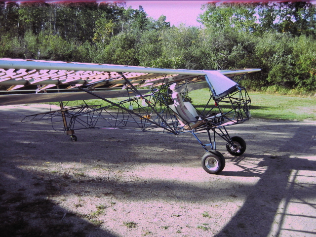

Hi all C well I've been trying to get my flaperons adjusted on the plane C and can't find the procedure in my manual.  I did a search on the archives and that wasn't much help either.  I even have the article by Mark Budak in the Kitfox Skystar Journal 'All about flaperon rigging and new tailwheel springs' and that isn't much help either.  None of what I've read walks you through the process from start to finish.  Can anyone help?  All of the controls were in when I got the plane C but they are not set correctly.  Thanks C  Jim Chuk  Kitfox 4 b;         - The K; _nbsp;                           -Matt Dw.matronics.com/contribution" target=_blank>http://www.matronics.com/cont================

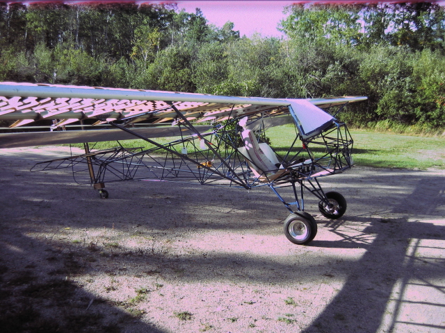

Hi all, well I've been trying to get my flaperons adjusted on the plane, and can't find the procedure in my manual. I did a search on the archives and that wasn't much help either. I even have the article by Mark Budak in the Kitfox Skystar Journal 'All about flaperon rigging and new tailwheel springs' and that isn't much help either. None of what I've read walks you through the process from start to finish. Can anyone help? All of the controls were in when I got the plane, but they are not set correctly. Thanks, Jim Chuk Kitfox 4 b; - The K;
[url=http://www.matronics.com/Navigator?Kitfox-List][/url]
See how Windows Mobile brings your life together—at home, work, oirect/01/' target='_new'>See Now = <Kitfox 4 build pics 038.jpg>
