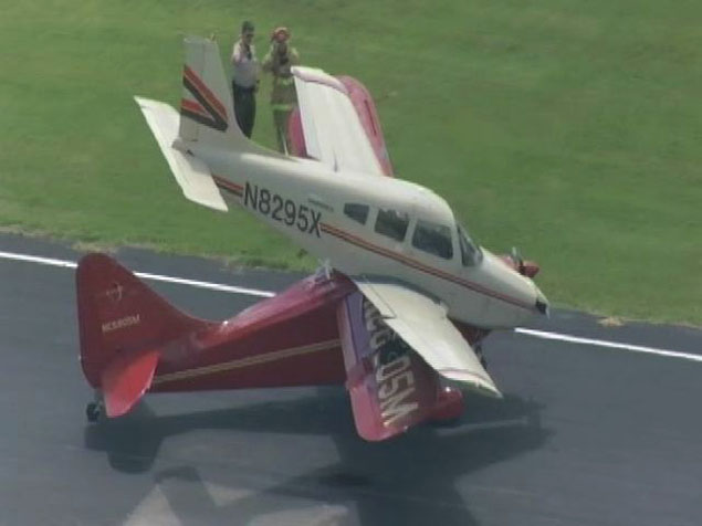

PostPosted: Wed Sep 17, 2008 10:33 am    Post subject: Closure Rates Reply with quote
steve
if you keep asking these question and we will all be required to have tcas. occasiobally i have to fly to the SF bay area, and have never liked it. but the big boys are not the ones that i worry about. we have a large collection of migs and l-39s here. those are the guys that are tough to see. While it does seem to happen the odds that you put your aircraft in the same fifty foot box as somebody else enroute, is very slim. the odds of this happening though, see pic is much higher
rick
