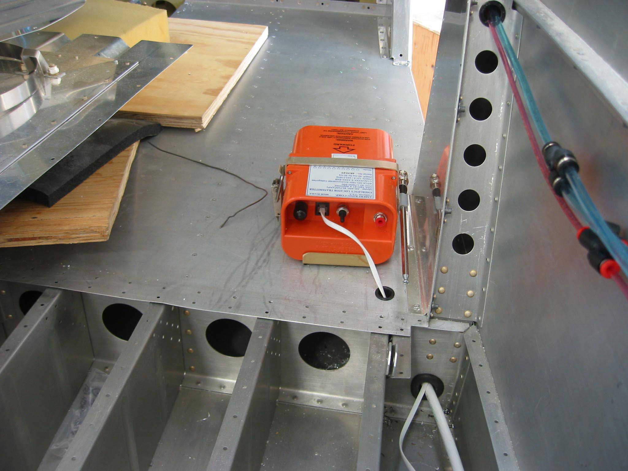

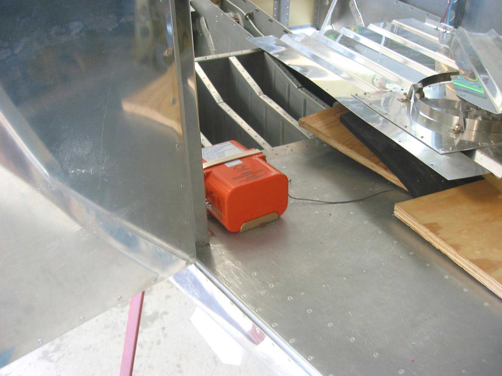

partner14
Joined: 12 Jan 2008 Posts: 540 Location: Granbury Texas
Posted: Tue Sep 09, 2008 8:04 pm Post subject: elt locations |
I hope the pics are self explainatory. Any questions, just email.
Don McDonald

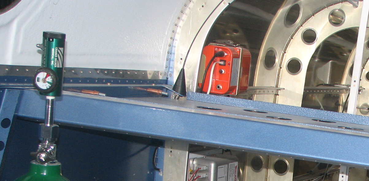

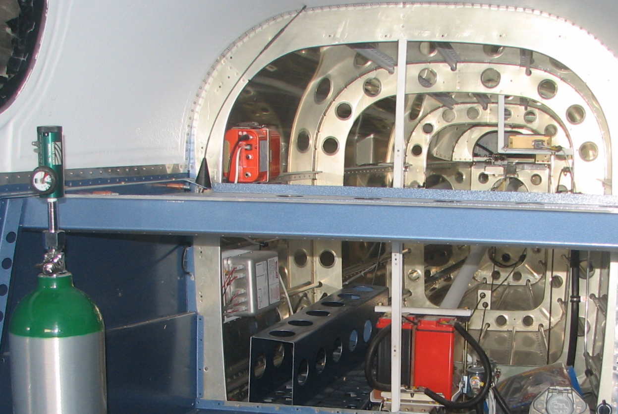

wayne.e(at)grandecom.net Guest
Posted: Wed Sep 10, 2008 2:58 am Post subject: elt locations |
I mounted my ELT antenna just inside the baggage compartment immediately on the left almost against the fuselage. It's out of the way and in case I ever need it hopefully I will be able to get at it. I thought about putting it behind the bulkhead, which I think many have done, but as I said I wanted to be able to get at it.
Also I have an overhead console and I have the ELT antenna mounted horizontally up in the console. I've also seen some mount the antenna horizontally in the tail section area and you can access it if the rear fairing is off.
I've attached a couple of photos of where I mounted it. I've done quite a bit of traveling, using the baggage compartment, and it's nit proved to be any problem.
Wayne Edgerton N602WT
