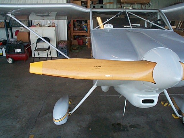

Curt
I had a similar thing to happen on N6PJ years ago. See the attachment to see how I cemented a plexiglass patch around the filler hole and painted it white.
Good Louk.
Lou Owen

owenld(at)earthlink.net Guest
Posted: Mon Sep 08, 2008 11:10 am Post subject: Lexan windshield |
I thought you'd ask that and I don't really remember. That was about 15 years ago I think but it seems like it was a paste type adhesive that was touted to be for plastic. Sorry I cant do better than that.
Good luck with your fix.
