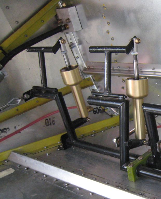

At least one of the 701s built at Quality Sport Planes ran the line back to a three port manifold on the people side of the firewall. I’ve attached a picture. Presumably there it mixed with cooler fuel coming from the tanks. I’ve attached a picture. Doug Dugger said the part came with the FWF kit from ZAC but that a similar part could be bought from Aircraft Spruce. Look under hardware->fittings->aluminum manifold fittings. I found a similar part at McMaster-Carr, p/n 5469K101 “ALUMINUM MANIFOLD, 2 OUTLETS, 1/4" NPT INLET X 1/8" NPT OUTLET”
