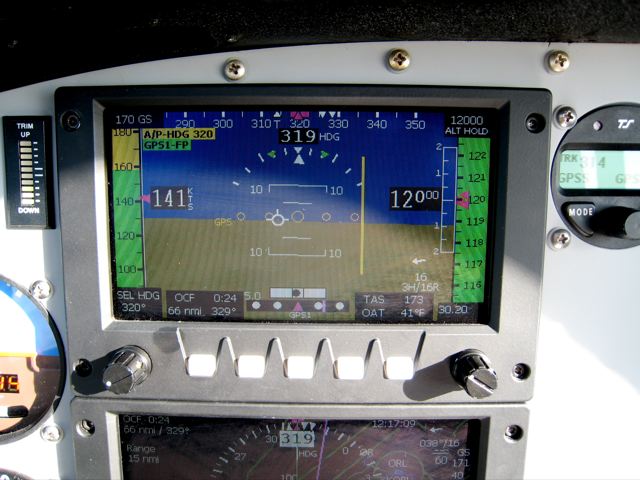

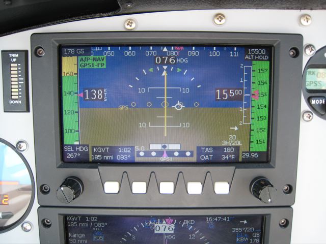

On my trip to Moses Lake and back over the weekend I tried different propeller RPM's for speed. I was level at 8500 Ft and full throttle. I started at 2600 RPM and then tried 2500, 2400, 2300, and 2200; for every 100 RPM drop I would see a couple of knots drop in airspeed.
Rob Hickman

Thanks Rob for the update. So 2600 produced the best speed at the price of higher fuel, and the loss of speed was consistent for every 100rpm? how did this effect fuel rate?

I have enclose two photos of my panel from a trip. They are both
taken on the same trip at different altitudes. I have done the GRT
speed correction but will try the GPS speed calibration for the next
one. Now, if my outside temp sensor is really out of wack and my
numbers are off, it is not my fault!
I took these shots with the AP engaged and the plane level in smooth
air, with everything settled. Notice no vertical speed, TAS on the
right bottom and OAT.
