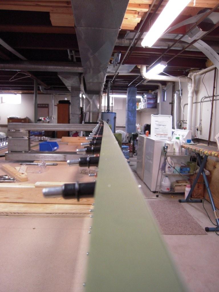

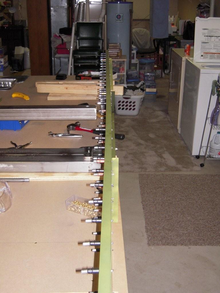

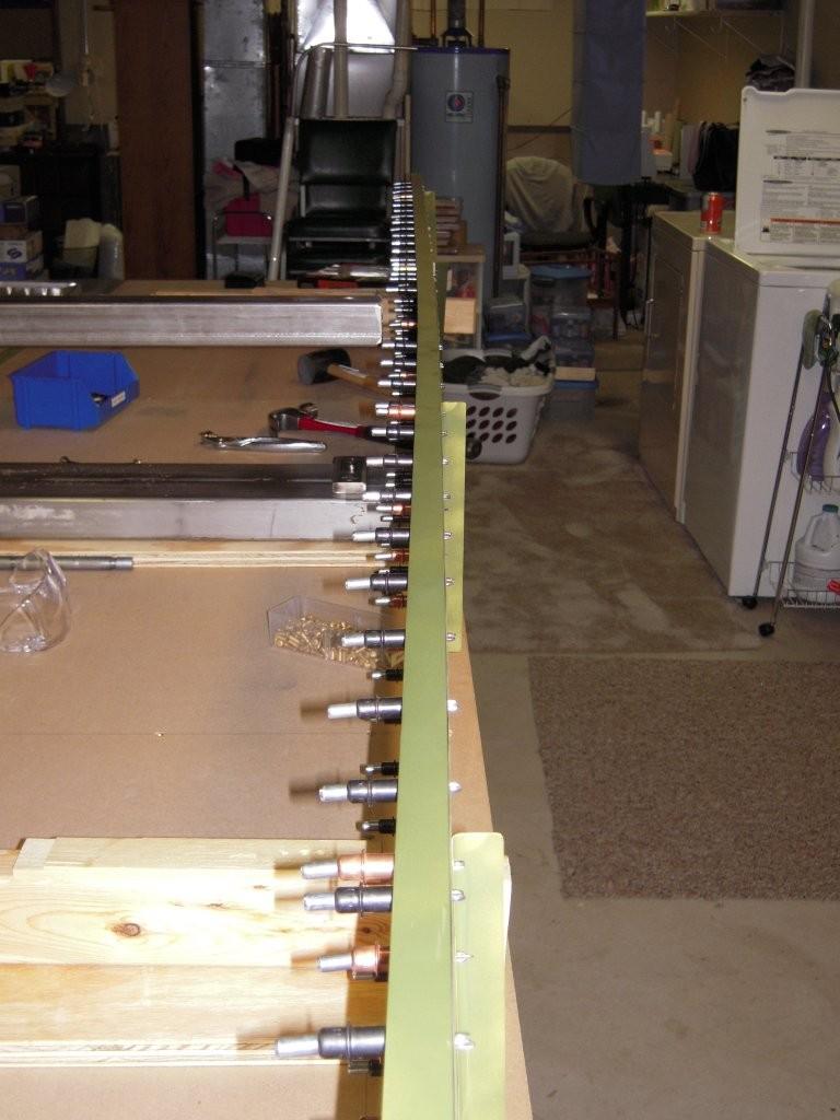

.ExternalClass .EC_hmmessage P {padding:0px;} .ExternalClass body.EC_hmmessage {font-size:10pt;font-family:Tahoma;} I finally made the jump and started to rivet my wing spars for my 701.  All seemed to be going well C and I've got about 6 rivets in one spar.  I started from the center C all rivets look good C but when I look at my spar from the end C it is starting to bend in towards the formed side of the rivet.  I can tell that it is bending at the rivet locations.  It is really noticeable C and I hesitate to go any further until I figure out why.
Does anyone have any ideas as to why my spars are starting to bend in?  I shimmed everything straight before I set any of the rivets (down to 1mm).  You can see the blocks in the pictures.  Any insight would be helpful.

Ryan.
If it is any consolation my factory spars are about one inch off, from the center out to the ends. I had to anchor it straight to the table before I could fab the rest of the wing.

Actually C it is some consolation.  If this is just the way it happens C great.  Then I will continue.  I just figured something was wrong with the way I was doing it.  I have noticed C however C that my striking rod was just ever-so-slightly off (hitting at some un-noticeable angle) so that the shop head was being formed off to one side.  This is something that I have fixed already C so I think I will end up drilling out my six rivets anyway.
Thank you so much for the response.  I figured I might get some bow C but I never figured on and inch.

My factory spars were also "curved" a little but no need to worry. I just struck a chalk line on the table as the instructions indicate. When I was ready to attach the skin, I jigged the spar straight by screwing small pcs. of wood to the table on both sides of the spar to keep it on the line. Worked out fine.

ch701builder
Joined: 07 Feb 2006
Posts: 119
Location: N38.9947,W105.1305,ALT. 9,100'
PostPosted: Mon Sep 01, 2008 2:42 pm    Post subject: Problems with riveting the 701 spars... Reply with quote
Ryan,
Are you doing every hole from then center out, or every-other-hole from the center out?

I had originally tried to rivet my (CH601-HD) spars with a heavy hammer and a rod. It did not go well - I don't quite recall what exactly was the problem, but it was bad. I pretty much trashed all the parts and started over.
So I enlisted the help of a fellow EAA member, and we did it with a pneumatic riveter, in the best RV style.
Given by bad experience, I kept the spar web, extrusions and doublers in place with the smooth end of drill bits (I had many, worn out and new ones). Clecoes allow parts to be offset by I few thousands - this may explain your problem.

Ryan, if it is crowning and really noticeable after 6 rivets something is not right. Crowning comes from distortion. I'll bet it is crowning away from the flange. if so, the setting method would be suspect to me. It sounds like you are using the hammer method which is less desirable than a gun and bucking bar which is less desirable than a rivet squeezer. Are you using an actual rivet set on the manufactured head? If not you should and minimal strikes to set the rivet.  I became so anal when I was at this stage that I built an electric over hydraulic squeezer. Each squeeze the same as the last and the results were a blemish free spar nearly arrow straight and the job went from an ordeal to pleasant one day chore. If you are anywhere near south central Michigan we can hook up and git er done.

Upon re reading you post, bending toward the shop head suggests lack of support of the manufactured head. offer still stands.

I scratch built my spars using a rivet gun and bucking bar and had the same curvature, probably about an inch, when it was complete. I had the spar angles secured to the table so I didn't even notice until I was done riveting. The blows of the rivet gun probably distorts the aluminum a bit more that squeezing the rivets would. Squeezing would be the way to go if you can borrow or purchase a pneumatic squeezer. They are expensive.

Thanks everyone for responding to my email.  I appreciate all of the insight.  I have since drilled out my six or seven rivets C and the spar returned to straight.  What I plan on doing next is to set up the spar so that my rivet location will be slightly higher than the ends C and I will start with one rivet in the center of the spar C but then will set a couple rivets on each end.  Then I will fill in between the rivets until the spar is riveted.  Hopefully this will minimize any curving.
Someone mentioned that the hammer method for setting rivets is probably the least desirable.  Unfortunately C I do not have access to a rivet gun C and I definitely don't have access to a power squeezer.  Maybe someday.  I will let everyone know what happens with the spars C hopefully in the next few weeks.
