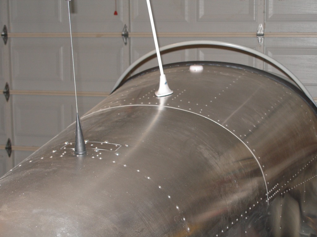

PostPosted: Fri Aug 29, 2008 6:33 am    Post subject: Antennas Where are you mounting them? Reply with quote
Larry,
I've attached a photo showing where my ELT, comm & GPS antennae are
mounted. The transponder antenna is mounted in the floor just ahead of
the wing spar center section.
Jay in Dallas
