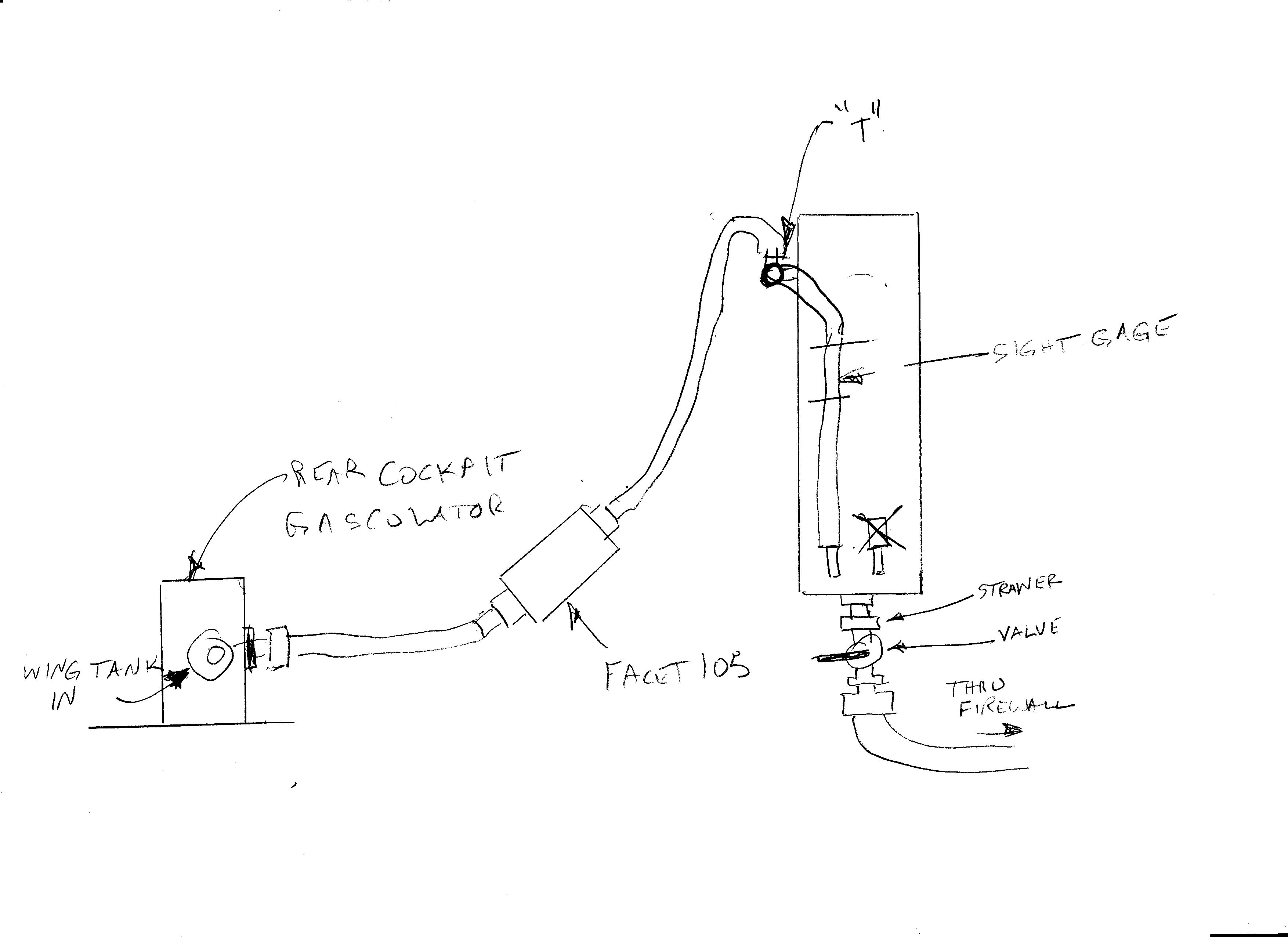

PostPosted: Tue Aug 26, 2008 3:03 pm    Post subject: Sight gage Reply with quote

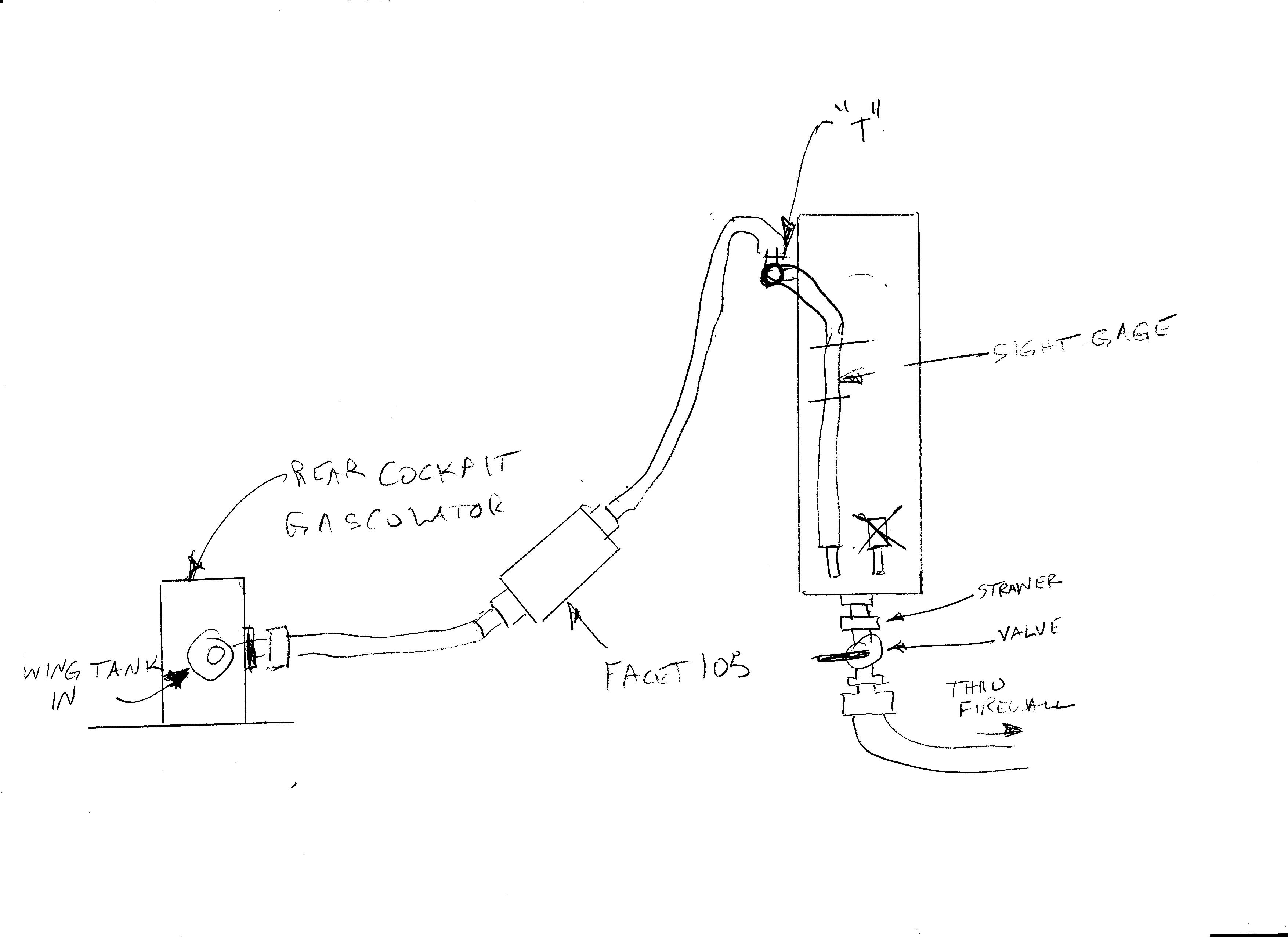

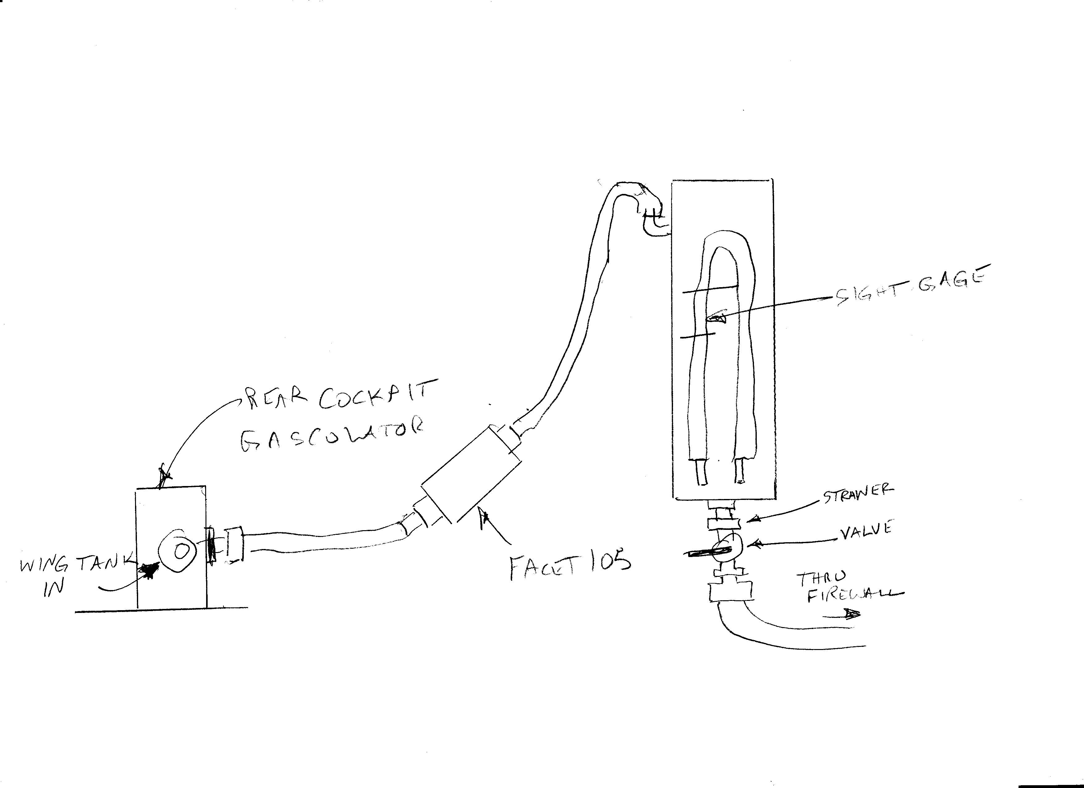

Gig, and everyone with a sight gage-
It seems that every 8 gal header tank was plumbed differently. I've
attached a sketch of what I think the layout in my case should look like. I
searched the archives and not a whole hell of a lot to go on. Whaddya think?
Bill

leo(at)zuehlfield.com
PostPosted: Tue Aug 26, 2008 4:40 pm    Post subject: Sight gage Reply with quote
Bill,
The sight gauge should look like the edited drawing attached, plumbed
into the top and bottom of the tank. Your "U" tube would not allow any
fluid into the tube. On the HDS demo plane in 1998 it was like my
drawing. The tubes came through the instrument panel, top and bottom,
through grommets. Gig is correct.

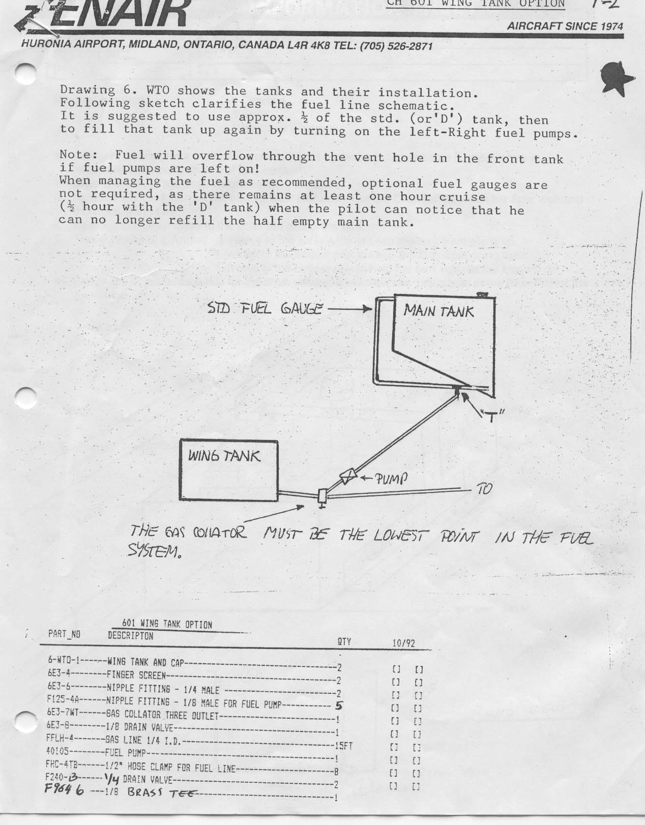

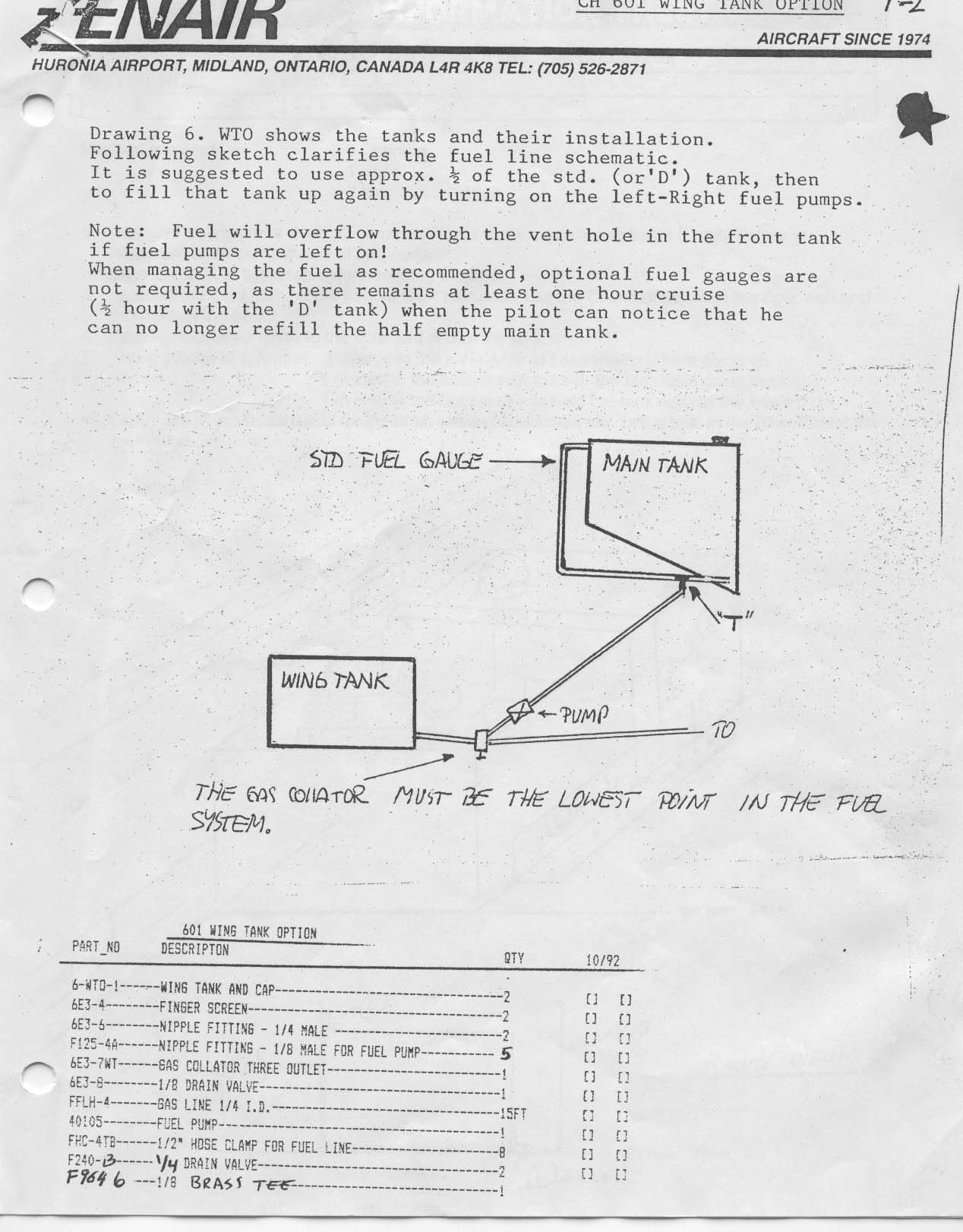

jlatimer1(at)cox.net
PostPosted: Tue Aug 26, 2008 4:56 pm    Post subject: Sight gage Reply with quote
Bill,
As several people have already pointed out your sight glass diagram will not work. Gas will not get into the sight glass loop. You need to attach the sight glass at the top and bottom of the tank.
My 8 gallon header tank came with two barbed connections at the top, a barbed connection near the bottom of the tank, and a threaded connection at the bottom of the tank.
I plumbed the sight glass between one of the top and the bottom barbed connection. My wing tanks are plumbed to the other barbed connection at the top of the tank. And the threaded connection at the bottom goes to the engine.
I've tried to attach the original documentation from Zenith on how to plumb the wing tanks to header tank. It also shows the sight glass.
Everyone building an XL should get a kick out of the documentation that we got with our 601HDS kits.
Jerry

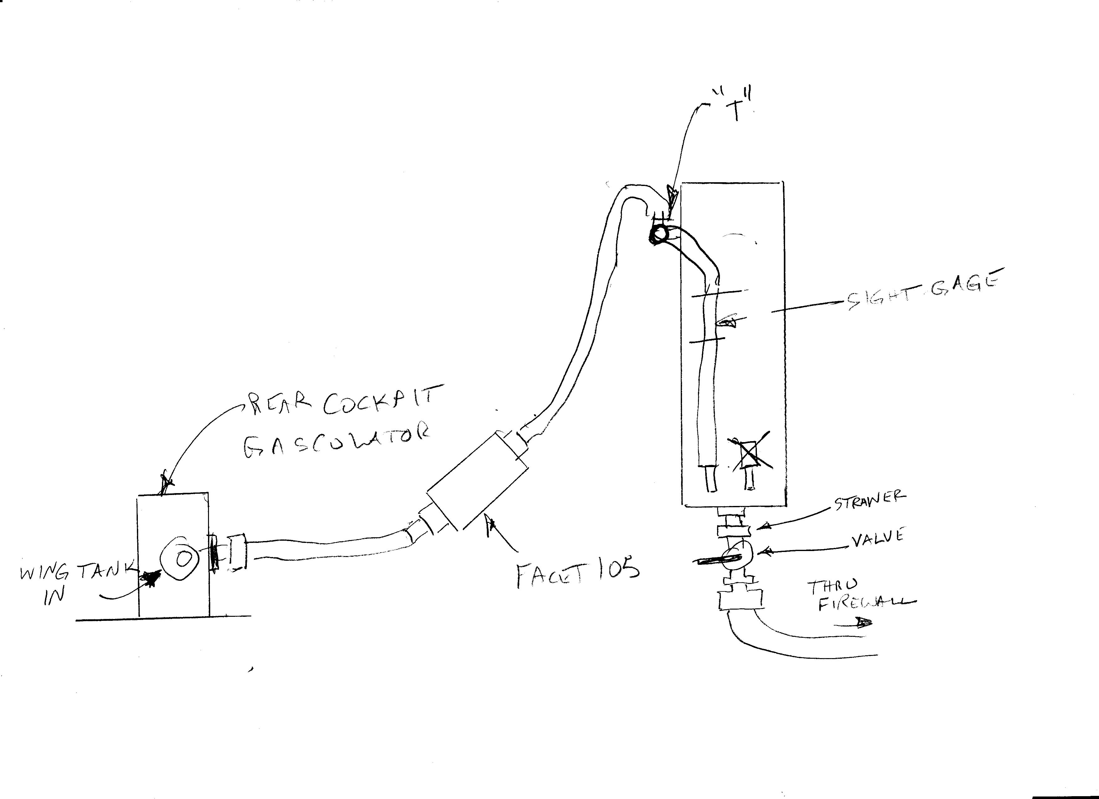

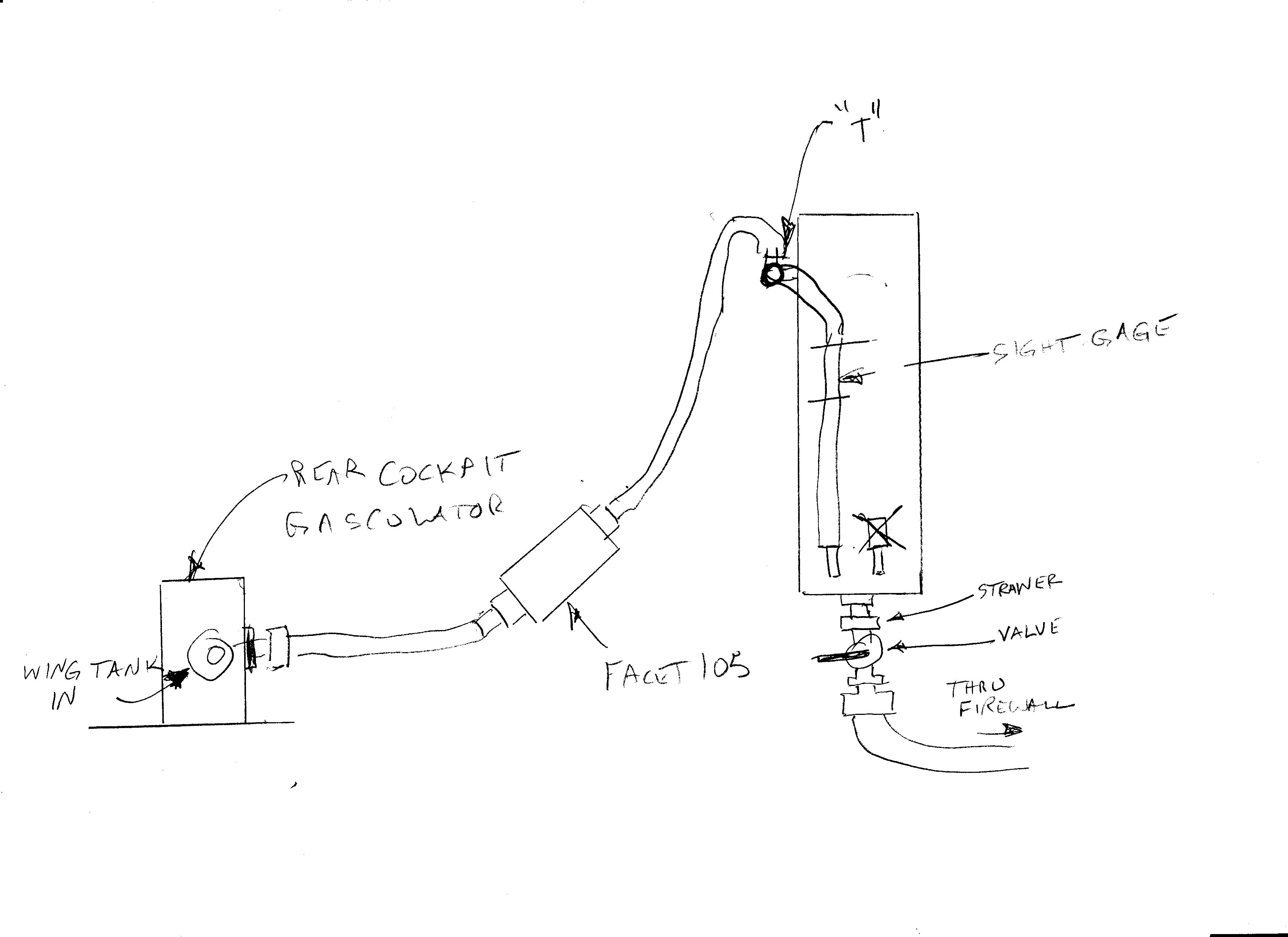

naumuk(at)alltel.net
PostPosted: Tue Aug 26, 2008 5:30 pm    Post subject: Sight gage Reply with quote
All-
Like I said, all the header tanks seem to have different in/outs. The
stupid arrangement I portrayed is what I got with my tank.
Since I have two outlets at the bottom of the tank, one is apparently
worthless.
I'm guessing that the alternative is to put a T at the top inlet, block
off one of the bottom, run the main to one side of the T at the top, and the
sight gauge between the other side of the top T and the uncapped bottom.
Sketch attached. Once again, waddya think?
PostPosted: Wed Aug 27, 2008 8:27 am    Post subject: Sight gage Reply with quote
That will work. As already posted you can run the fuel line from the wing tanks into the bottom inlet that you show blocked off. This will eliminate a T fitting.
Jerry

grs-pms(at)comcast.net
PostPosted: Wed Aug 27, 2008 9:50 am    Post subject: Sight gage Reply with quote
One concern about a fuel inlet on the bottom of the fuselage tank: If the
valve (or check valve in a fuel pump) leaks a little bit, all the fuel in
the fuselage tank will try to drain back into the wing tanks. With the
inlet in the top of the fuselage tank, only the small amount of fuel in the
line will leak back. This is the reason I felt it necessary to relocate the
inlet to the top of my tank.

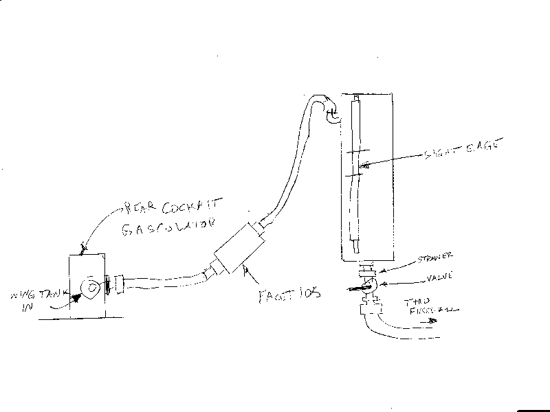

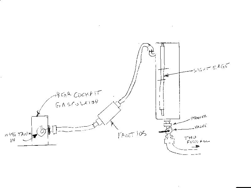

PostPosted: Wed Aug 27, 2008 2:11 pm    Post subject: Sight gage Reply with quote
Jerry-
After a day to get everyone's input and think about it, I figure the way
to plumb this puppy is in the attachment.
I obviously don't (Or didn't) know jack about fluid dynamics, but I
guess all you have to do is really think about it.
The first logical assumption is that it's easier on the pump to drop the
fuel in from the top rather than push it in from the bottom. Factor the
strain pushing fuel up an extra 2' versus squirting it in from the side,
along with the additional line under pressure (Which is a potential failure
mode) and the strain on the pump is about equal, while the potential for
pressurized failure is lessened.
Your HD/HDS instructions came through fine. Eat your hearts out, XL
people!
Bill
bryanmmartin
Posts: 1018
PostPosted: Wed Aug 27, 2008 4:07 pm    Post subject: Sight gage Reply with quote
Unfortunately, your first logical assumption would be wrong. Smile
Overall, the pump will be working harder pumping in to the top of the
tank than it will pumping it in to the bottom. The back pressure on
the pump depends entirely on the height of fuel above the pump, not on
how many gallons are sitting above the pump. The pressure two feet
below the surface in a 500 gallon tank is the same as two feet below
the surface in a five gallon tank. Pumping in at the top, height of
the fuel will always be the height to the top of the tank so the
pressure will always be at its maximum. Pumping in at the bottom, the
pressure will start out low and increase as the fuel level in the tank
increases. But this is no big deal, just use a pump that will deliver
more pressure than the maximum it will see in this application.
The one advantage to pumping in to the top is that you won't need a
check valve to prevent the fuel from draining back to the wing tank
PostPosted: Wed Aug 27, 2008 5:36 pm    Post subject: Sight gage Reply with quote
Bryan-
After sleeping on it, that's what I figured, too. Since the 105 has a
built in check valve, I'm thus best off with the arrangement in
theattachment to my last e-mail.
Bill

PostPosted: Wed Aug 27, 2008 6:46 pm    Post subject: Sight gage Reply with quote
Bill,
It seems to me that your sight gage will work only while the engine is not running if you tee into the line feeding the tank from the pump as shown in your sketch.  However, I have to wonder if one of those fittings on the bottom might actually be connected to a tube extending to near the top inside the tank.  That would let the sight gage "breath" properly with the existing fittings.  If not, you probably can make an adaptor to achieve the same thing.  How that would be done would, of course, depend on the type and size of those fittings on the tank bottom.  Hope this helps.

bryanmmartin
Posts: 1018
PostPosted: Wed Aug 27, 2008 7:33 pm    Post subject: Sight gage Reply with quote
If you mean a Facet 105, I believe that the check valve in this pump
is designed to allow a small amount of back flow in order to let the
fuel line depressurize after shut down. If you use this pump to feed
to the bottom of the header tank, you will have to remember to shut
off the valves leading from the wing tanks to prevent the header tank
from gradually draining into them.
Bryan-
has a built in check valve, I'm thus best off with the arrangement
in theattachment to my last e-mail.

hills(at)sunflower.com
PostPosted: Thu Aug 28, 2008 4:43 am    Post subject: Sight gage Reply with quote
Gosh, wouldn't I feel silly if my header tank ran dry because my check valve
failed and allowed fuel to drain from the header tank in flight. I think I
will just keep my top-of-the-tank fuel pump discharge tube in it's current
location, even if it does take a bit more pressure to pump the fuel up
there.

bryanmmartin
Posts: 1018
PostPosted: Thu Aug 28, 2008 5:09 am    Post subject: Sight gage Reply with quote
It probably wouldn't drain out much during a flight, but after sitting overnight, a significant amount may drain back. As I recall, the reverse flow rate is something like half a gallon an hour. I use two of these pumps in parallel, one main and one as a backup, it works just fine with no additional check valves needed. I would probably pump the fuel to the top of a header tank if I had that configuration myself. One less thing to keep track of.
PostPosted: Thu Aug 28, 2008 2:18 pm    Post subject: Sight gage Reply with quote
Bryan+Roger-
1. At 1/2 gal/hr, if I fail to monitor my fuel situation in flight and transfer as needed, my fault- pilot error. If the loss is worse than that, I'll replumb.
2. I was programmed many moons ago in flight training to shut the fuel cocks off at shutdown. However, this step will be a good addition to the "601MG" operational checklist.
Thanks, guys. Full snail's pace ahead!
