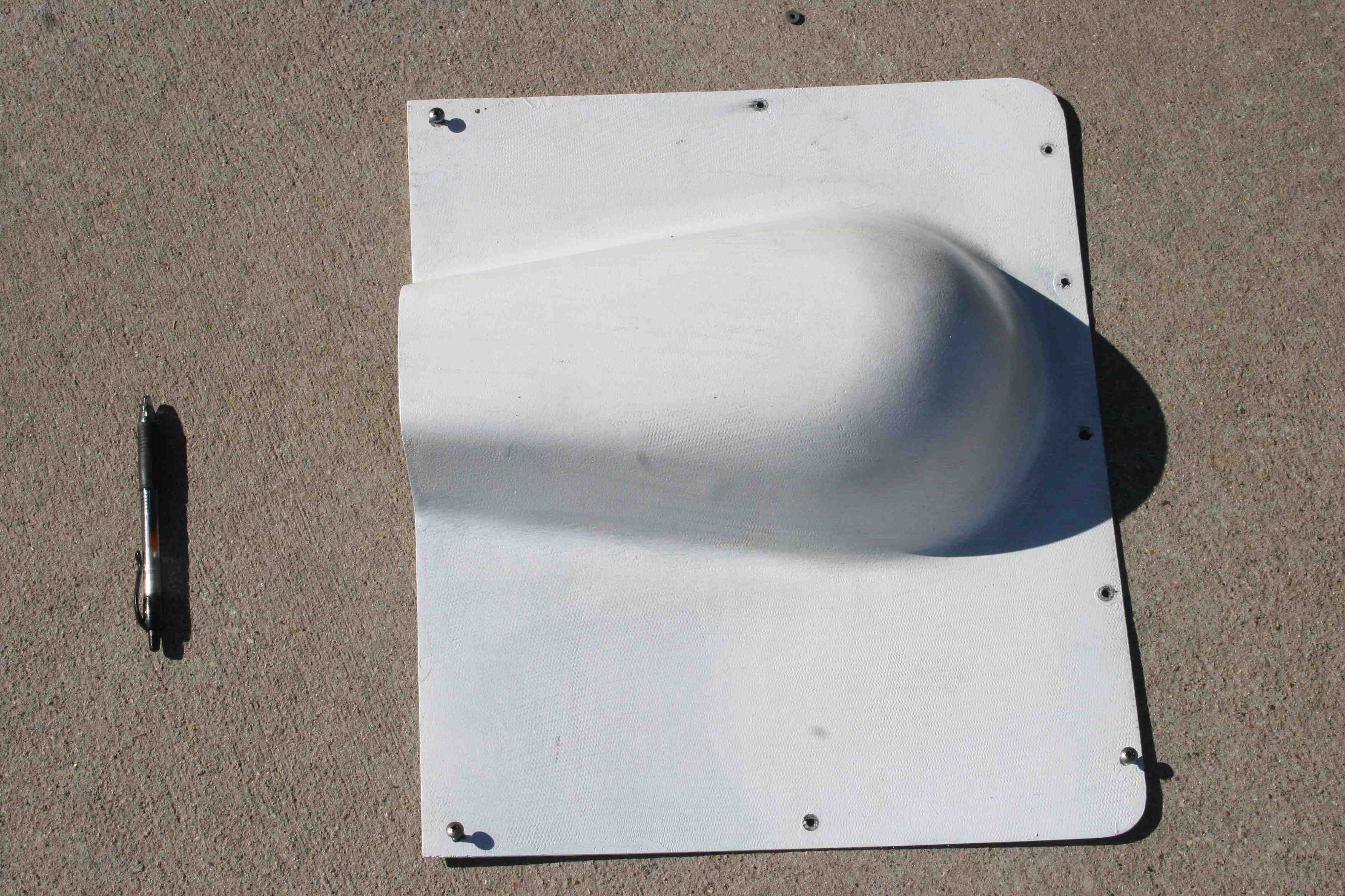

I put a reverse scoop on fuel drain panel to create low pressure under
the belly tank. I assume most of the fumes are coming from the tail
cone as that is where reports of acro smoke starts to come from. There
is no way seal the tail cone short of a high dollar bulkhead. The
scoop creates low pressure to give it a place to go out side. It is
not fix but the gauge shows it seems to help by half on landing and a
third at cruise. My glass guy made one in a day and still has the
form. I turned it around for high pressure and it made it worst on the
meter not better. No mod to the plane. I could not tell a difference
but a friend with lung problems said otherwise.
