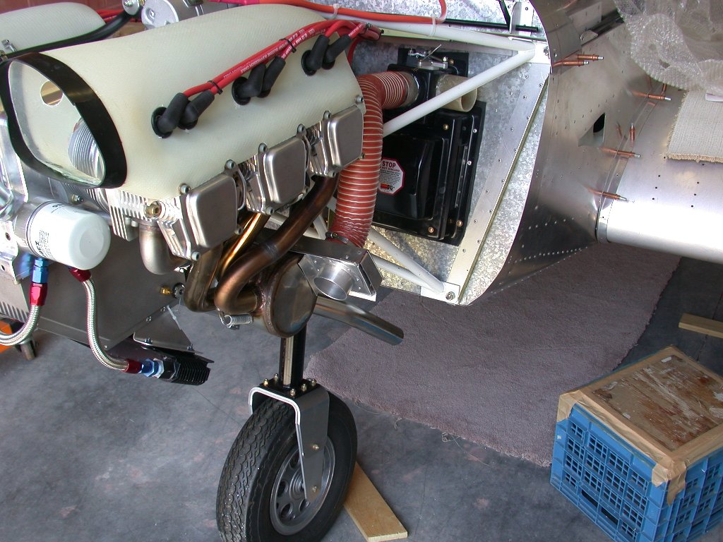

I agree that you should wait. I have seen several arrangements for all the
stuff that goes on the firewall, but overall it is a tight fit. You will
need to place everything and then assess who it all works together. I'd
suggest not doing one item at a time. Attached is a picture of my air box
on the pilot's (left) side of the airplane during installation of the 3300.
Jeff Davidson
