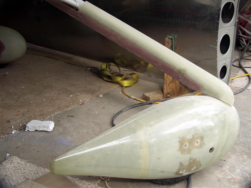

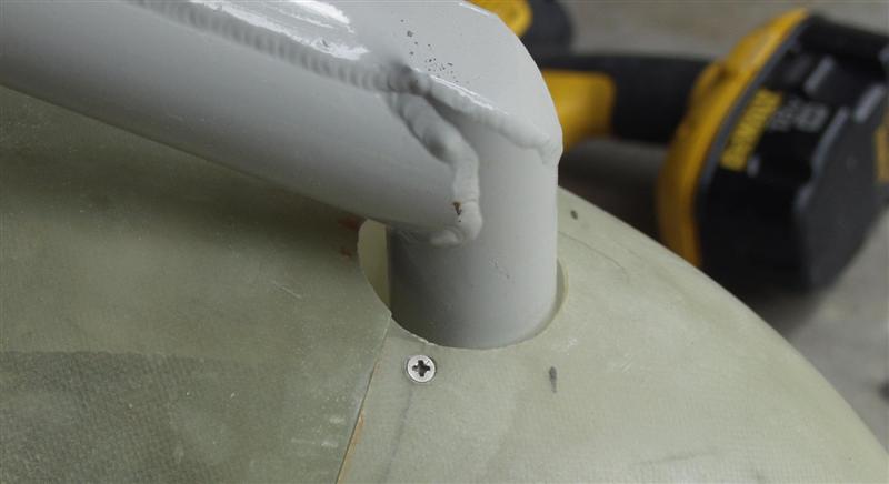

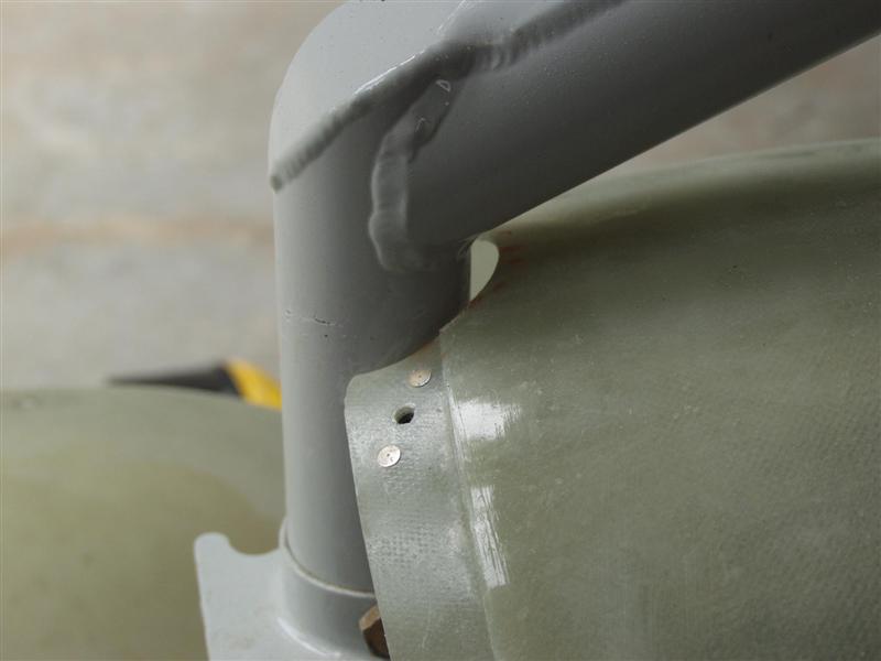

Lew Gallagher
Joined: 04 Jan 2008 Posts: 402 Location: Greenville , SC
Posted: Fri Aug 22, 2008 12:46 pm Post subject: Re: Nose wheel fairing length |
Hey John,
It took longer than I thought to get back to it but here are the pictures showing the hole cut past the flange in the rear nose fairing. Everything lines up and I don't see why it won't work just fine.
By the way, I ended up reinforcing several times the countersunk holes where the fairing attaches to the gear on all wheels. This still seems like a weak point to me, and we may go with countersunk washers to spread the force ... but then it wouldn't look so slick.
Later, - Lew

John Ackerman
Joined: 19 Jun 2006 Posts: 130 Location: Prescott, AZ
Posted: Fri Aug 22, 2008 6:48 pm Post subject: Nose wheel fairing length |
Thanks, Lew. That's a really nice fit, and you don't have to fiddle
with riveting the scrap back!
We wound up just slightly (1/4") fitting the rear nose wheel fairing
to the vertical post, and letting the rear fairing be long.
On the suggestion of an experienced local builder, we put a couple
layers of 9 oz. where the bracket-fairing mounting screws are before
glassing the bracket/fairing mounting pads. Good idea! All seems well.
The forward nose wheel fairing is not thick enough, so there is a flow
"trip" where the intersection is. Doing it over again, I would put a
few layers of glass on the interior of the forward fairing before
fitting and match drilling the two. That would smooth the intersection
and also reinforce the countersunk holes in the forward fairing. Am
contemplating whether or not do to something similar even now,
although keeping the hole locations would be tough. Alternatively, the
area will have to be faired out with micro.
John Ackerman 40458
