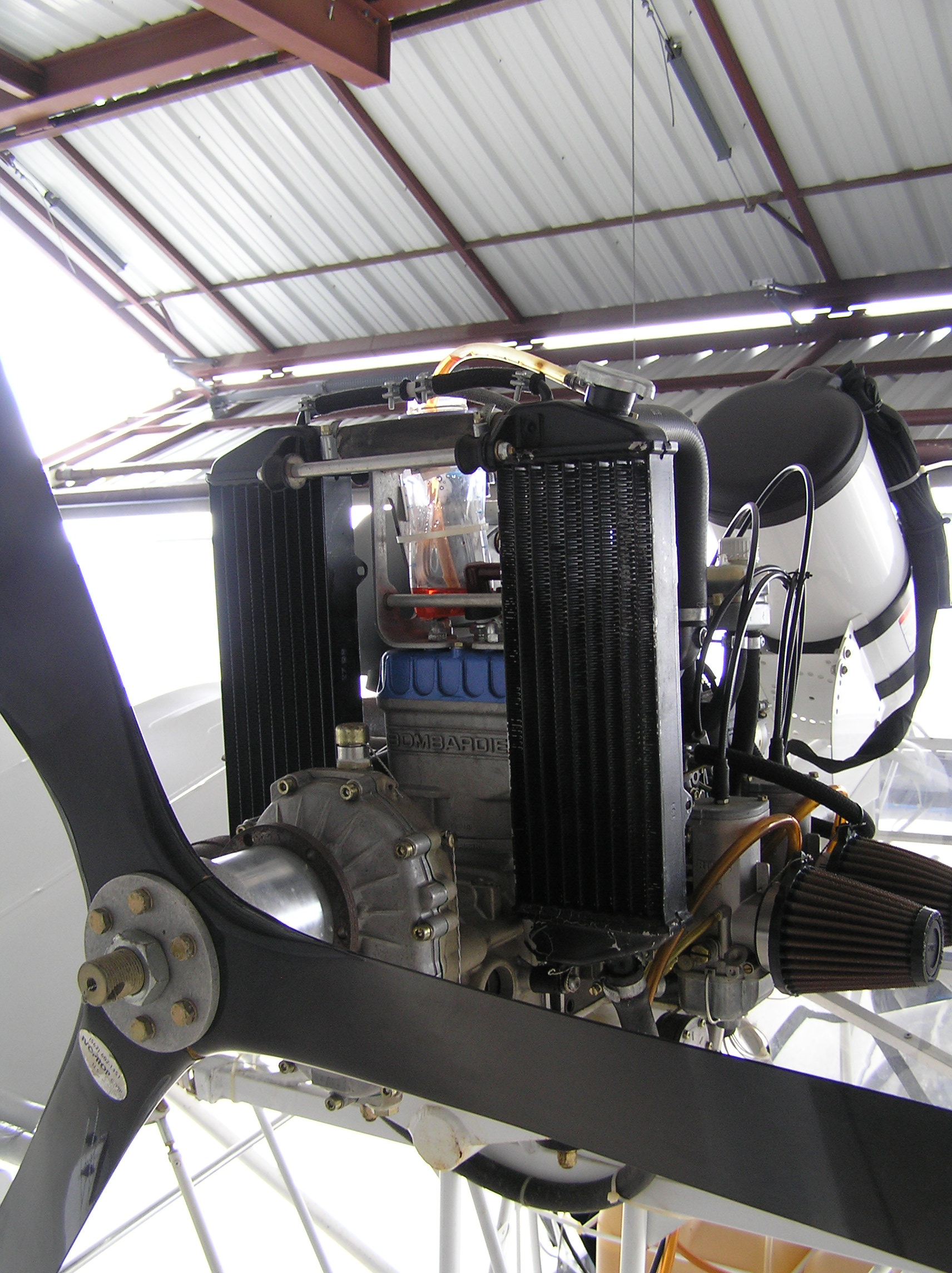

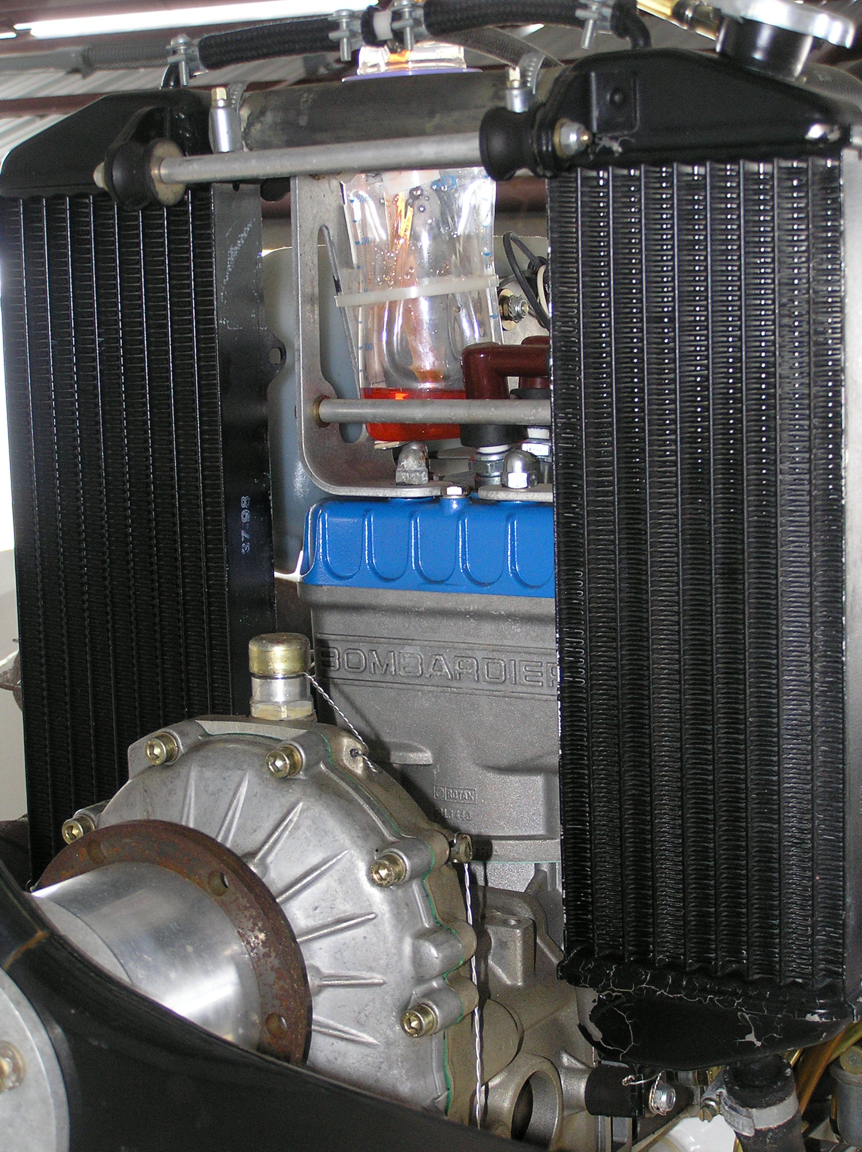

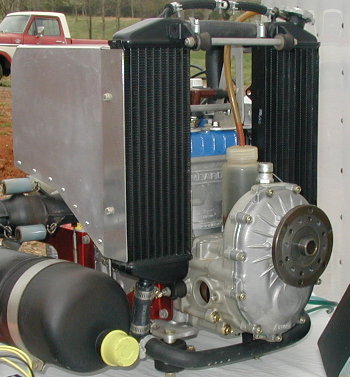

I am a flyer not a builder and enjoy the MKIII Classic that I purchased with a 582 blue. But, I have a problem. EIS temps seem to run too high. Yesterday at 62 ambient I had a great flight (160degrees)but had it been 72 I would have been up at 180 with the light flashing. Seems that a lot of you are down south at that you probably only have two days a year down at 62--LOL. At 78 ambient, if I stay in the pattern, I will be at 180 half way into the downwind leg-5500rpm.
I have two radiators (VW?). They both measure roughly 12.5"x4.5"x1.25. Thermosat is set to open at 146. Coolant is protected down to 0F-- where I want it for the winter.
Do most of you have 3 radiators? Is anti-freeze ratio too high? What else to check?
Thanks for helping me-- on probably an obvious problem. Pics are attached.

Can't help you with the temp problem. Looking at your photos, I noticed
that none of the hose clamps are safetied. It might be a good thing to do.
I have fried one engine for the lack of a hose clamp safety.

Posted: Thu Aug 14, 2008 6:11 am Post subject: 582 Running Hot |
| Quote: |
Tom O:
I don't know if this is your problem or not, but I noticed air in the vent
tube.
Been a while since I flew with a 582, but seems to me that venting all air
from the system was imperative to get the cooling system to operate
correctly. Of course, my 582 was much older than the blue head 582's. I
think there was a way to vent air from the cylinder head on the older 582's.
Back in the old days, 1993, Rotax recommended a 75 to 80% antifreeze
solution. First cross country flight to Lakeland my coolant temps were very
high. When I got to Lakeland I dumped the antifreeze and refilled with
straight distilled water. Coolant temps came down quite a bit.

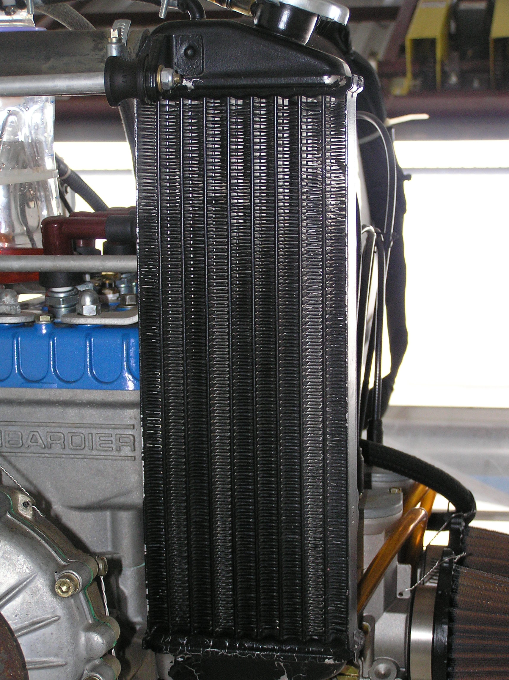

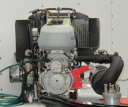

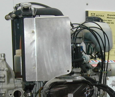

I had the same problem with my 582-blue on hot days and long climbs. The
attached photos show what I did to eliminate the problem.
Steven
