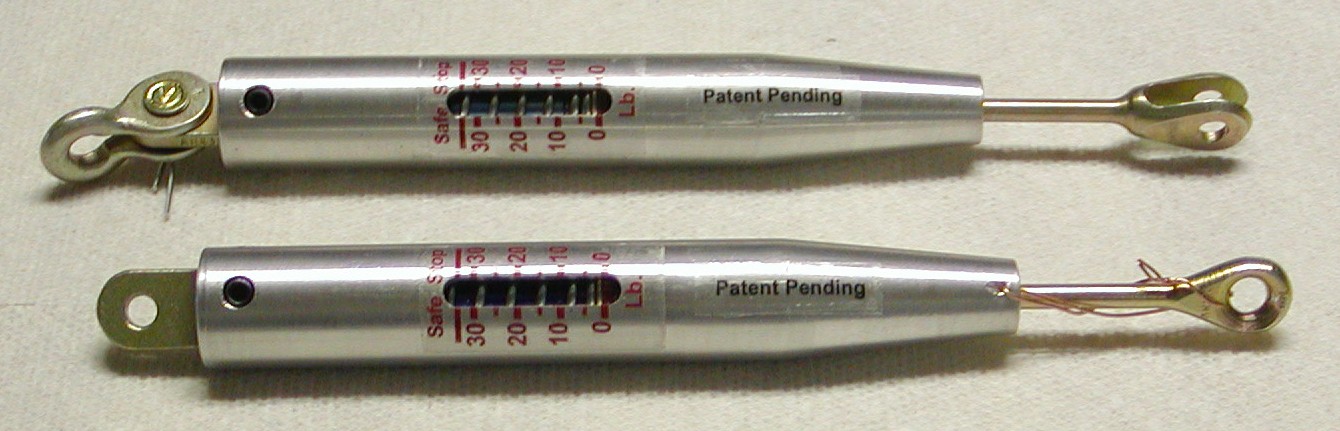

deglass1
Joined: 14 Nov 2006 Posts: 5 Location: Forest, VA
Posted: Mon Aug 11, 2008 5:54 pm Post subject: Re: aircraft cable tension meter - a new solution |
Zenith builders-
With Chris Heintz's letter and this thread of interest on the 601 list, I have been told by my patent attorney that it's OK to talk about this: For a year in my spare time after completing a 601 fuselage as part of a team build, I've been developing and preparing to patent a device to allow in-line setting, adjusting, and easy visual inspection of the tension in cables. The patent covers aircraft and other applications. It takes the permanent place of one turnbuckle in any of the 3 axes, serving that tightening function during installation. It's in testing now for ultimate strength, and will be shopped around soon. Based on the CNC production prototypes, I expect it will cost $60-80 each.
The prototype in the attached photo (on its control simulator for test and evaluation) has a nominal setting of 30 lb as shown. It hits a hard stop in the event of a 10% dynamic overload that prohibits flutter, and will maintain at least some cable tension in the event of a component slip of up to an inch that can immediately be detected at visual inspection since the device is in-line all the time.
I would appreciate the interest feedback from this small but dedicated group, on both the technical aspects and price points. The aircraft cable version is such a small niche that I'm not sure it's worth chasing.
Regards to all -
David Glass
(fuselage builder, N253DG/601XL/3300A, in airframe integration now)

| Description: |
| A pair of in-line tensiometers, with different end hardware configurations, in relaxed state. |
| Filesize: |
134.83 KB |

David, On my HDS the cable tensioners are made up of two pieces of
aluminum angle, a bolt, a flat washer,
a nylon insert self locking nut and some safety wire. This is the Chris
Heintz design. My DAR thought they
were way cool and too bad you can't do that on a certified aircraft. My
cables and tensioners are visible
with the seat backs pulled forward. You can reach them to give them a
good "twang".
I would not buy yours. But, then I'm a cheapskate.
Leo Gates
N601Z - CH601HDS TDO

Very impressive David. I think you've made one huge mistake. You are underpricing it. The aircraft community will never accept a part that does more than what it is replacing unless there is an order of magnitude difference in the price.
Keep up the good work and keep us up dated.

Interesting concept Mr. Glass. Let's add a complex piece of equipment to a simple machine to make it what? More complex? More safe? I really don't see the need. Guess I went to the school of KISS and remembered some of it. But I do wish you much success.
