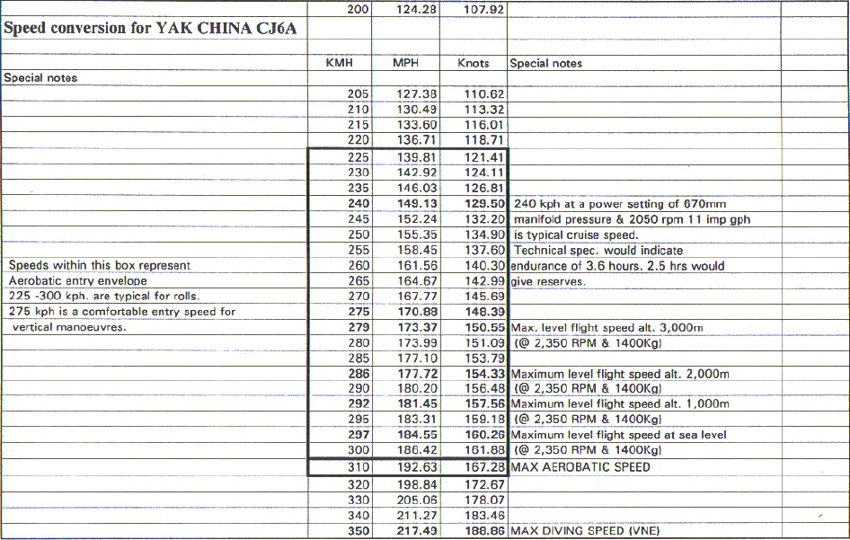

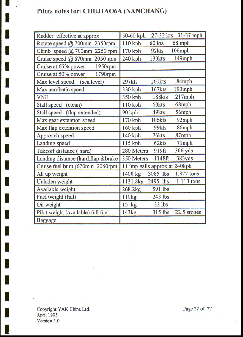

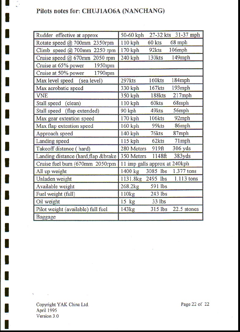

PostPosted: Mon Aug 11, 2008 9:05 pm    Post subject: Re: V speeds for the CJ Reply with quote
try these:
 Filesize:  276.66 KB
 Viewed:  503 Time(s)
 Filesize:  267.05 KB
 Viewed:  470 Time(s)
