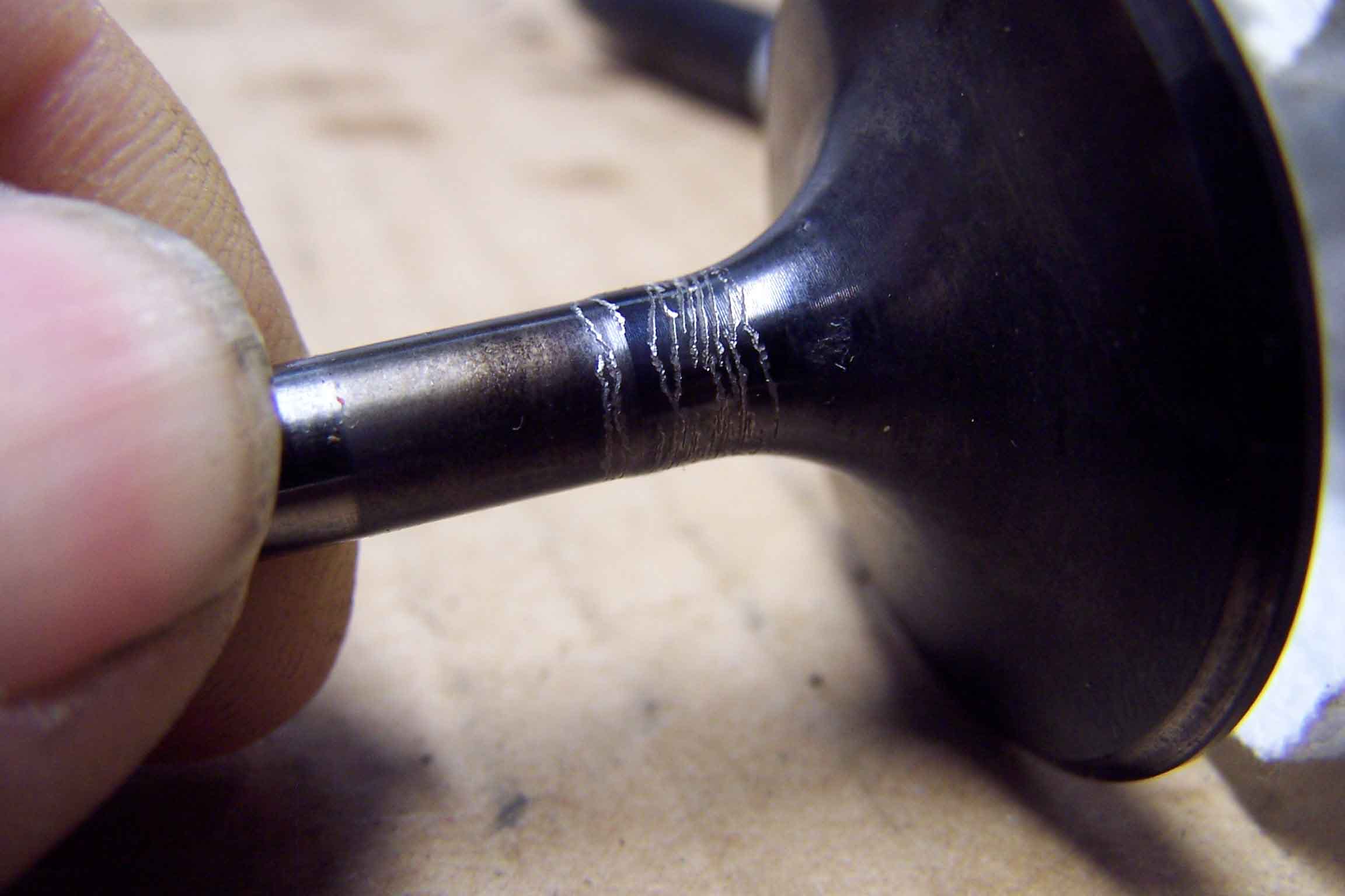

If you would like to send the broken gear to my office in Barrie, Ontario I can have our metallurgist take a look at it. We can do carbon analysis and have metallurgical inspection as my people there are qualified in fatigue analysis for our drilling products.
Might show something!
the only other thing that the jab people here could come up with was some sort of contaminant in the oil etc that jammed between the teeth. After reading your posts I find that highly unlikely!
How were the rest of your pistons and valves?

I think the only contaminant that got between the teeth was another
one of the teeth. : )
Even the intake valve that was hit by the piston is still without
runout when spun in my lathe, but a local aircraft engine rebuilder
magnafluxed it and said it looked like it had cracks, but that it
might have been where the head was spun-welded onto the stem, and
that he would not use it. And to that I gave a big amen, 'cause I
sure as hell WASN'T gonna put that back into the engine, even if I
got a "good to go report" from the magnaflux check. See picture:
I certainly didn't need the 'flux job to tell me not to use this
valve, but I also couldn't determine what the "scratchy-looking"
marks were. My best guess is that very hard metal was flexed, and
where the flex occurred, the edges flaked off, leaving a slight
crater which shows up as a scratch.
The guides are worn to their allowable tolerances, but the valve
stems are right on specs. The valve "wobble test" told me more than
the micrometer did, and I plan on getting the heads done...new valves
and guides. The local aircraft engine guy said he thought they'd make
it to the 1000 hr suggested head overhaul time, but certainly not
with the one valve looking like it does. His estimate was based on
the appearance of the guides, valves, and the wobble test, and his
experience in the field.

On Aug 7, 2008, at 6:54 PM, gary.algate(at)sandvik.com wrote:
Lynn
Gary

PostPosted: Sun Aug 10, 2008 6:04 am    Post subject: Landing and engine pictures Reply with quote
That valve appears to be ready to let go at any time, Lynn. Good catch!

Lynn Matteson
Posts: 2778
PostPosted: Sun Aug 10, 2008 8:16 am    Post subject: Landing and engine pictures Reply with quote
Stevie Wonder could'a caught that one, Deke!
