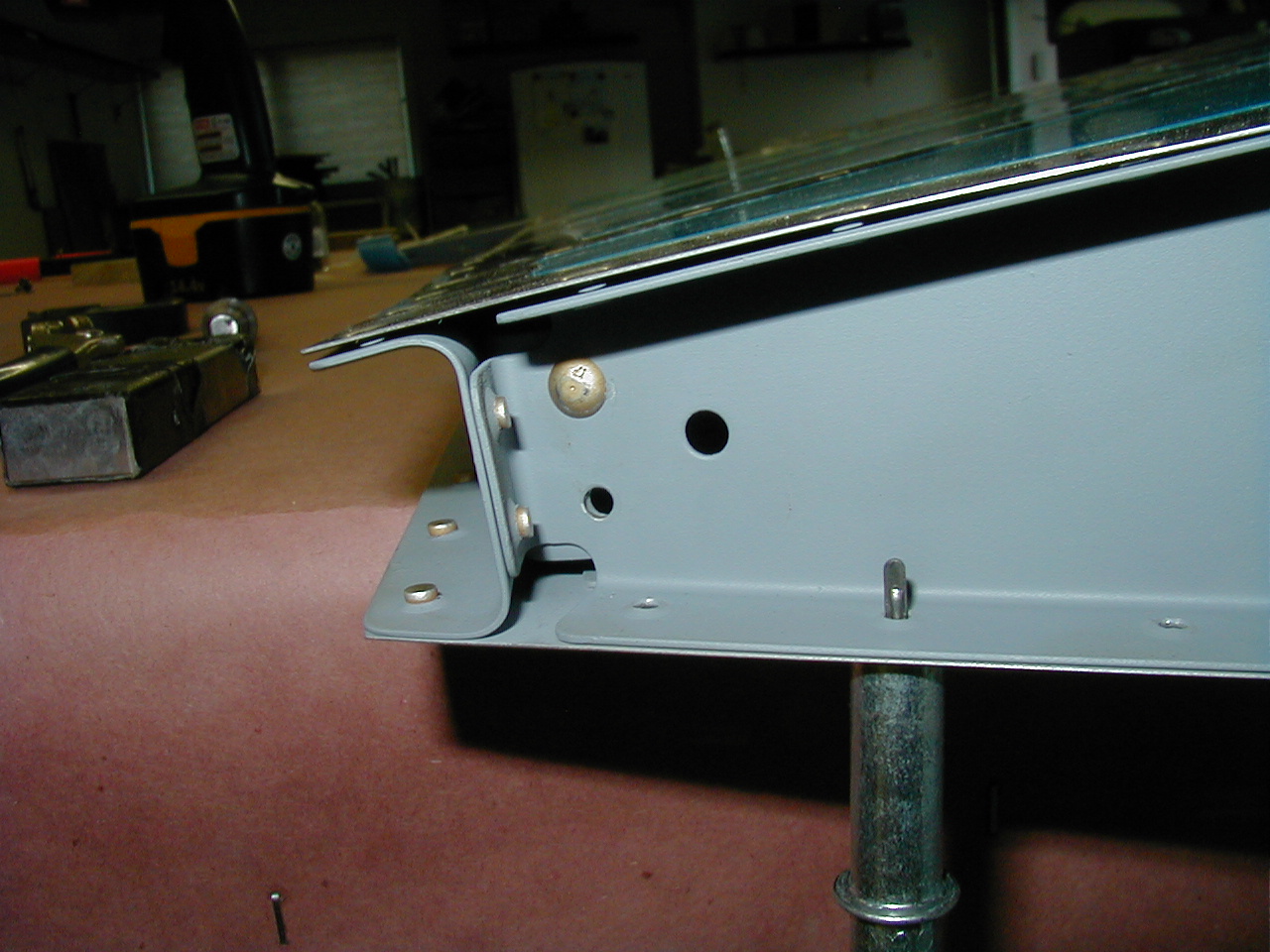

Hi,
I am to the point of setting the rivets from the root rib to the gusset and can't seem to come up with a good way of doing it. The plans say to rivet the root rib to the rear spar first. I did that but the thing is so tight that I can't get a set straight on the manufactured head either with a squeezer or rivet gun. I have the manufactured head on the outside.
If I take out the 3/32 rivets connecting the rear spar to the root rib it would give me a little more room but not sure if it would be enough.
Maybe I'm not seeing something.
Thanks for any help in advance,
Bill

Bill Cannon
Joined: 03 Jun 2008 Posts: 11 Location: New Jersey
Posted: Thu Aug 07, 2008 3:20 pm Post subject: Re: Elevator root rib and gusset |
9-14
After looking at it again with better lighting I found that with trying all sorts of angles of holding the squeezer I was able to get it. The set on the squeezer did have to ride the edge of the spar but I got two nice shop heads. A little primer touch up where the set rubbed and I'll call that step done.
Thanks for the quick reply,
Bill
