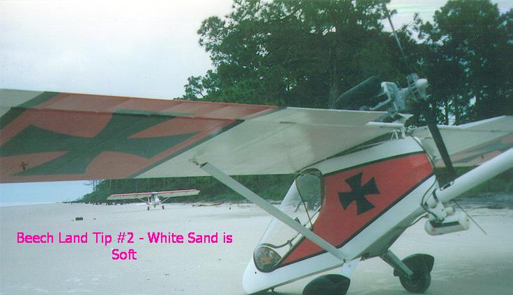

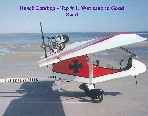

Possums
Joined: 03 Nov 2007 Posts: 247
Posted: Thu Aug 07, 2008 3:09 pm Post subject: Aircraft Drag Componts |
At 06:24 PM 8/7/2008, you wrote:
| Quote: | To put it in perspective, remember that the drag HP varies as the
cube of the airspeed.
I think the most bang for your buck is going to be the lift struts.
I could tell at least 4 to 6 mph top end with my old 447 Firestar.
I did the landing gear later and didn't really notice any difference, but
it looked neat. Those original little landing gear looked kind of goofy.
| Description: |
| Filesize: |
28.8 KB |
| Viewed: |
397 Time(s) |
| Description: |
| Filesize: |
43.8 KB |
| Viewed: |
443 Time(s) |
_________________ Possum |
