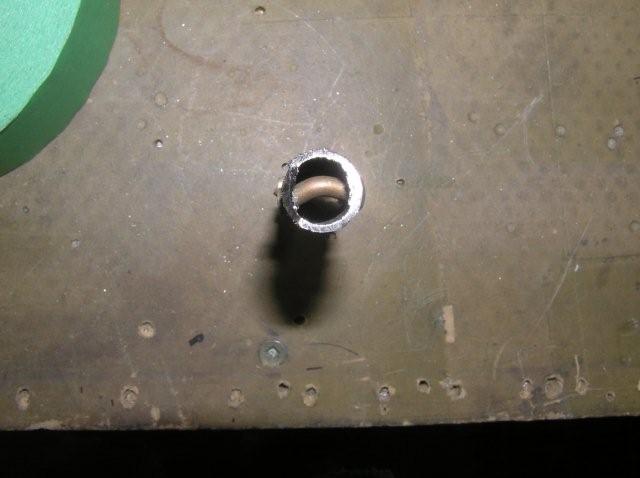

Having some "spare" parts, I did a little riveting experimentation before trying the real things. Pix P1010016.JPG shows what happens when you try to put a AN470AD4-11 rivet in a piece of tubing without the rod end installed. I tried this several times and always got the same result. It appears that the rod end provides enough structure that the rivets don't bend too much inside the rod end tube.

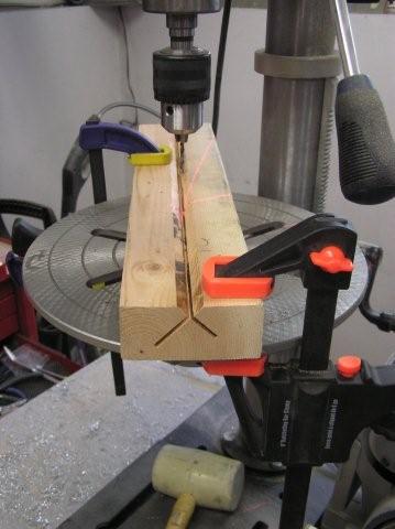

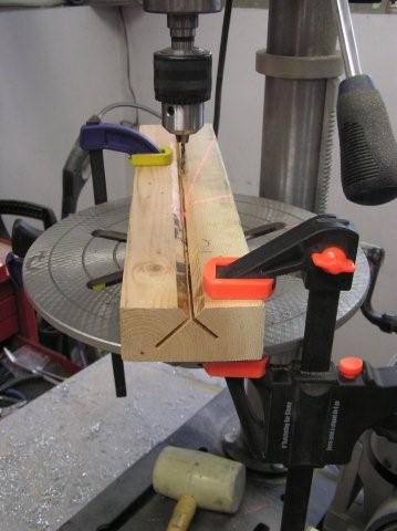

  • First I made a V channel holder (see P1010015.JPG) as suggested by Carl. This I aligned on my drill press so that the drilled would always go through the centerline of a tube and clamped in place.

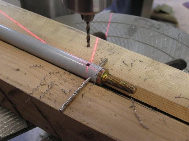

  • Drill the #40 pilot hole with the rod end in place. Care must be taken to ensure that the rod end does not "wander" out of the tube when drilling. Prevent this by holding the rod end in place by hand when drilling. I also clamped the tube in the V channel to ensure it did not move.
  • Insert a #40 drill bit in the drilled hole (see P1010019.JPG) and then drill the next hole. Re-drill this hole with the #30 bit then rotate and re-drill the first hole #30 - use a #30 drill bit in the first hole to keep everything aligned.

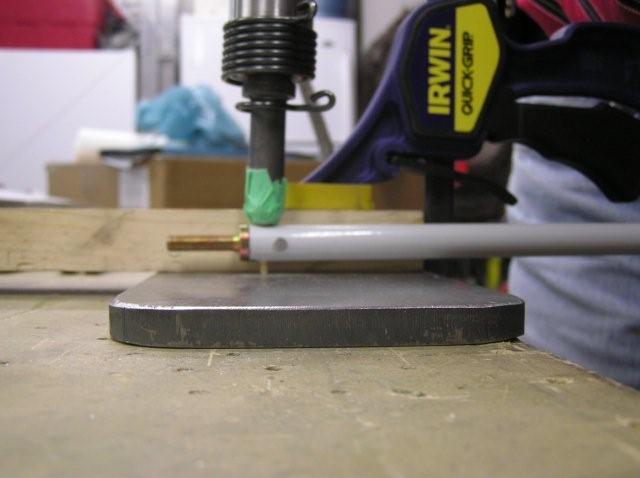

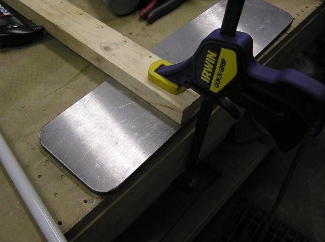

  • After a bit of experimenting, I found that if I used a "fence" (See P100024.JPG) to help align parts, I could easily get great results using the back riveting method to install the ANAD4704-11 rivets.
  • P1010023.JPG shows how I aligned the parts for riveting.

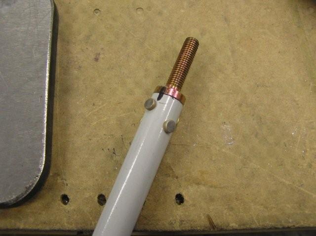

  • I used several very short, light bursts on the rivet gun to get the results shown in pix P1010026.JPG. The shop heads are round and meet spec dead on. When riveting keep an eye on how the shop head on the rivet is moving - you may have to slightly rotate the tube etc if to keep the the shop head square to the back rivet plate.
