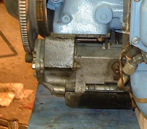

Jerry Grimmonpre'
Joined: 09 Jan 2006 Posts: 144 Location: Huntley, Illinois 60142
Posted: Fri Aug 01, 2008 1:14 pm Post subject: Starter gear won't retract |
Jim
[quote] Is it possible to submit a picture to the list showing what you have done to make the Mitsubishi starter useable? Maybe a word description?
Thanks ...
Jerry
RV4
In a message dated 8/1/2008 3:38:31 A.M. Eastern Daylight Time, jsflyrv(at)verizon.net (jsflyrv(at)verizon.net) writes:
Ditto. That has been my experience with those antiques. I welded a bracket to adapt a Mitsubishi starter (looks like a skytec but got it free off a junk car) and it has been great for the last 10 years.
Jim

Jerry;
I looked through my files and this pathetic photo is the only thing I have. It is a permanent magnet gear reduction "nose-less" type of starter that I remember getting out of a Mitsubishi. They should be easy to come by because the engines and frames usually fall apart and all that's left is the starter. It has 2 mounting ears and I made a flat plate with holes, that mounts to the spot where the original starter went on my 0-360. I welded 2 ears onto the plate with a tube (for bolts) on each ear. You have to get this part right for the correct gear engagement. There is a small support "tang" on the back of the plate that rests on the back of the starter so the drive won't push out of the flywheel teeth when engaged. It weighs about half as much as the stock starter so keep weight and balance in mind. It spins the engine about twice as fast which may cause a problem as mine did. It spun just fast enough that the magneto impulse coupler would not engage. I had to lighten the fly weights in the magneto. Works great now.
One other thing; shortly after I put it in the starter drive clutch started to slip. A replacement drive was outrageous but the Mitsubishi drive can be disassembled. I removed the worn cam rollers and bought a drill blank a few thousandths larger. Cut it up and used them as replacement rollers. That was 10 years ago and it still works perfect.
Jim

Thanks Jim ...
I follow your word description fairly good, Jim, and congratulate you on your creative problem solving. I'll try this in the future.
Jerry
