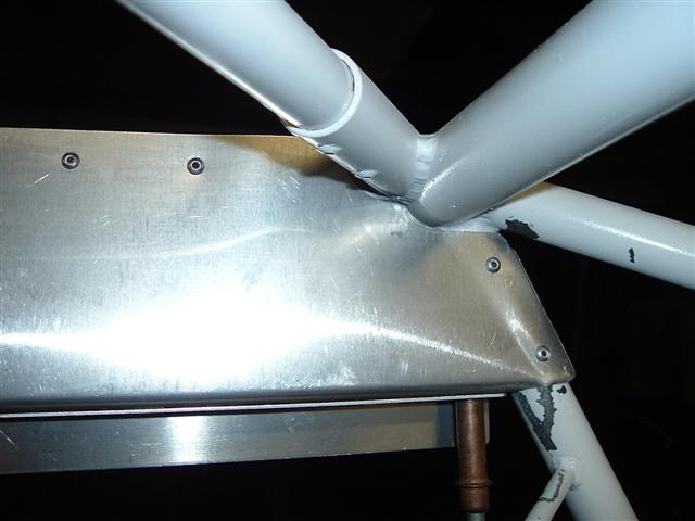

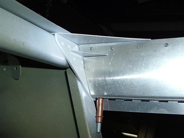

Can anyone post how they trimmed the door sill, specifically the rear inside?
The plans and manual are lacking.

This is the way I did mine. Drilled #30 pilot hole and cut slot using snips. The tricky part was fitting the forward end of sill around tubes. Took many fittings and trimmings to get it right.
