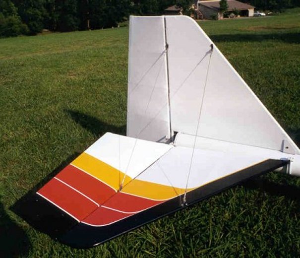

Anyone know how to get a hold of Gary Haley ? I really like his dual tail wire setup, I already have the hardware to do this and would like some information on it.
Mike

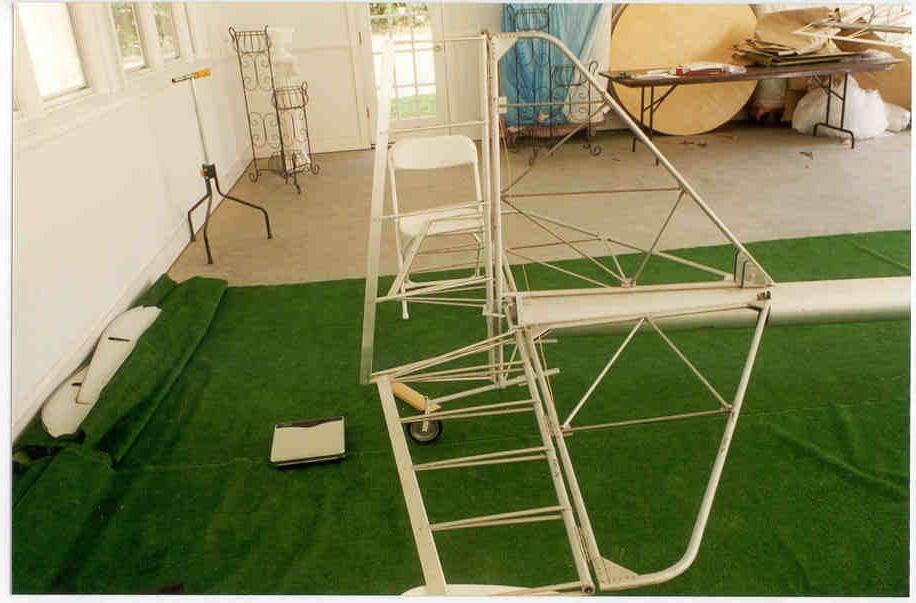

PostPosted: Fri Jul 18, 2008 4:26 pm    Post subject: Nauga 2008 Reply with quote

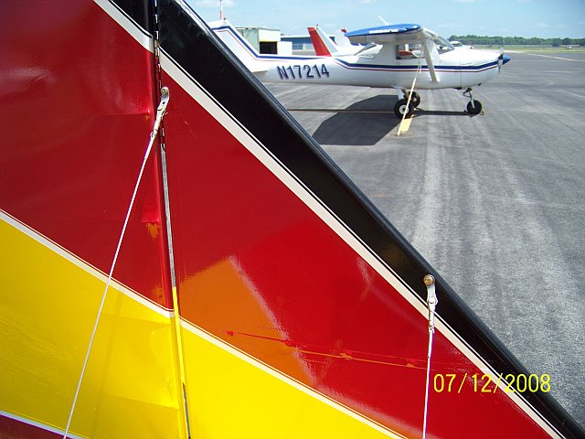

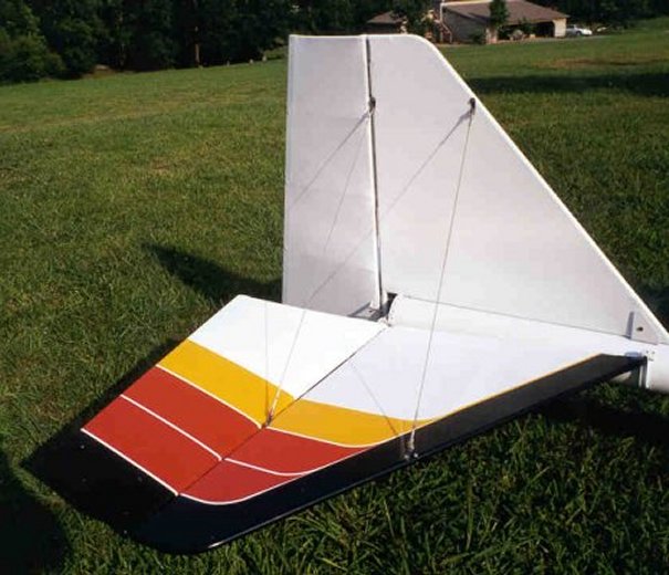

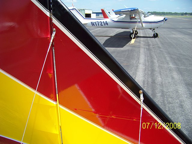

It's pretty simple to do.
You can do it like this - with or without the curves in the stabilizers.
You will, of course, need to put sleeves where the bolts go thru before
you build the tail. - you will have to slide them in place inside the
tubes before you rivet things together.
 Filesize:  70.03 KB

PostPosted: Fri Jul 18, 2008 5:13 pm    Post subject: Nauga 2008 Reply with quote
The curved tubes really look good on the horizontal.Nice touch.

Thanks, but idea wasn't mine, I stole it from some else.

PostPosted: Sat Jul 19, 2008 12:43 am    Post subject: Re: Nauga 2008 Reply with quote
Possums,

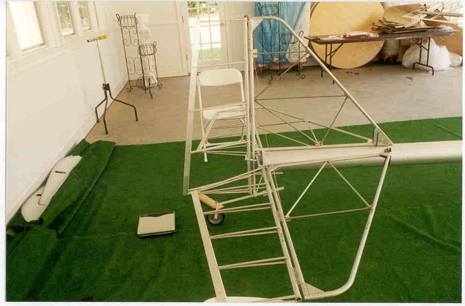

I see you do not have the tabs with the different holes in them like comes with the MK III, did you put a turnbuckle in there somewhere ? Looks like the lengths would have to be perfect to keep the tail from twisting, was that difficult to set up ? BTW, Nice shop ! I need a work area like that, I would be motivated to get a lot more done...
Mike

PostPosted: Sat Jul 19, 2008 4:18 am    Post subject: Nauga 2008 Reply with quote
At 04:43 AM 7/19/2008, you wrote:
--> Kolb-List message posted by: "JetPilot" <orcabonita(at)hotmail.com>
You can change those things to.
Not that there is anything wrong with the original equipment.
It's just cleaner and not that expensive to do.
I had all my cables "machine" swaged this way ( elevator, rudder and tail wires)
by a guy near Aircraft Spruce in Griffin Ga.
He supplies the cables and fittings.
He does need to know the length from "hole to hole" on the attachment
points and they are only adjustable about an inch.
There is only a turnbuckle on one end so you better know the measurements
if he's not local.
I'm sure there are people like him all over the country.
