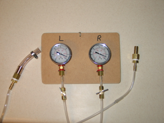

Roger Lee
Posts: 1464
Location: Tucson, Az.
PostPosted: Wed Jul 16, 2008 3:00 pm    Post subject: Re: Carb sync tools Reply with quote
Hi Guys,
If you don't want to spend a bunch of money for a carb balance tool here is a picture that you can make at home. It works very well and is easy to use. At least use a decent pair of liquid filled gages.

PostPosted: Thu Jul 17, 2008 1:44 am    Post subject: Re: Carb sync tools Reply with quote
Rick,
I was referring to the $1.55 special as attachment in Craigs post. I used Dextron 3 as the oil inside the tubes. Very accurate and highly visible when its all happening!.
