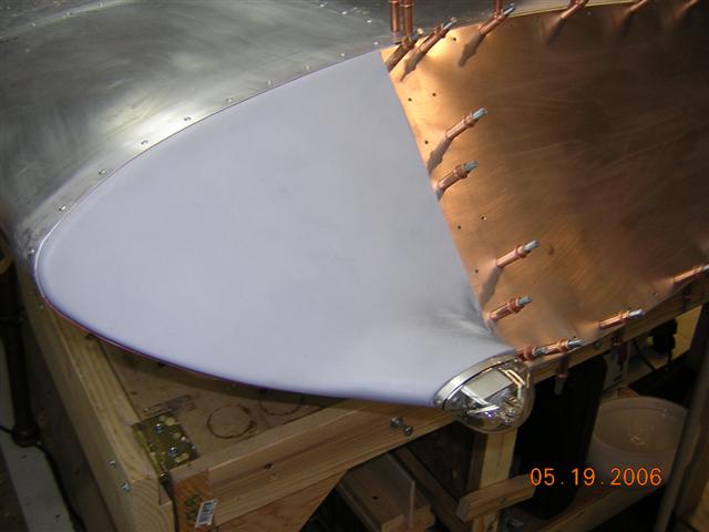

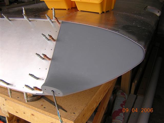

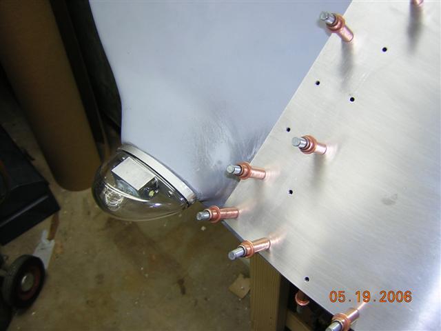

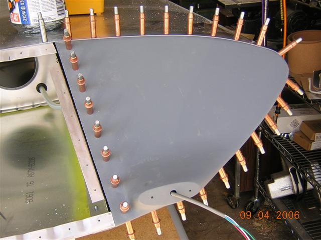

I have installed the Kuntzleman Combo nav/strobe lights on my wing tips and I had the same questions. I solved the problem by making custom fiberglass wingtips that move the light back so that the wing won't block the white light. See attached pictures.
Herb
