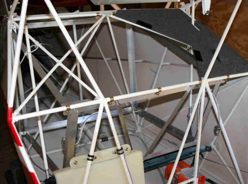

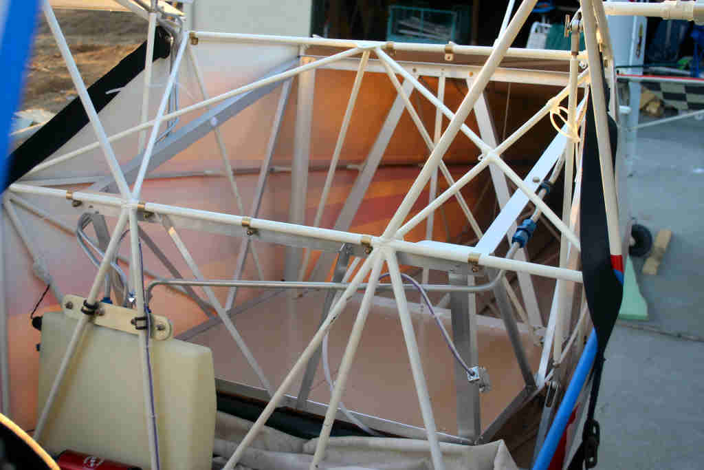

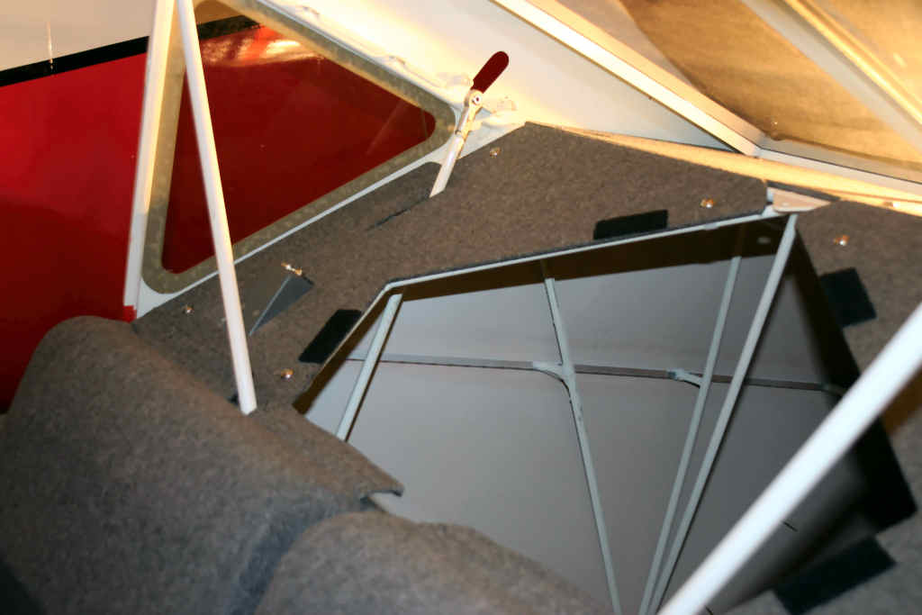

Mine is accessed from the slope behind and above the seats.
The opening is small, probably 18 x 18, which limits what you can put
in. You certainly won't be putting in any folding bicycles! You can,
however, get camping gear in, as long as it's separated. (You can't
get a full size backpack in.)
I've attached three pictures. One shows the baggage opening
behind the seat. One shows half the baggage opening with the baggage
structure, but no side panels, and one good shot of the baggage
structure without the panels. Unfortunately I don't presently have
any shots with panels, but the panels are honeycomb glass on the
bottom and corrugated plastic on the sides. The baggage structure is
the silver aluminum angles. The white tubes are fuselage structure
and the silver tubes are fuel lines.
