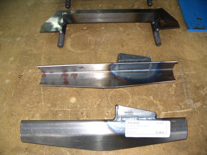

When I purchased my Grove main landing gear, I was told I needed main gear supports from Zenair in Canada, since they supply them to AMD. Now that I'm at that point, I can't say that I understand how they mount. Do they work in conjunction with Zenith 6-B-11-4 (welded main gear attachment) or replace it? Does anyone have any drawings. Picture attached.
Thanks.

I'm not 100% sure but I believe it replaces the piece of aluminum angle that is used with the normal gear. Those welded on pieces allow for the smaller (front to rear width) gear.
The piece in the background goes on the bottom of the fuselage then the gear is sandwiched between it and the pieces in the foreground.
Is that clear as mud? Smile

After posting my question, I basically figured out what you just described. Now I just need to determine if the welded-on spacer goes toward the front or rear of the channel.
Thanks, Gig.
The rear, I would believe, based on the gear on my Zodiac being positioned
at the front of the channel.
I was going to take pictures this morning, but Gig described things just
fine.

I had the same question when I went to install my Grove gear. One thing
about this list, questions are sure answered fast!!
In addition to the answers you already have you can go to the AMD site and
look at the drawings (Do other manufacturers of light aircraft provide the
same excellent detailed info? i doubt it.)
for Grove gear:
http://www.newplane.com/amd/amd/601_SLSA/Parts/6-A-25.jpg
for the standard Zenith gear:
http://www.newplane.com/amd/amd/601_SLSA/Parts/6-A-24.jpg
Mike

Thanks so much. I had no idea they provided that kind of detailed information. Questions answered!

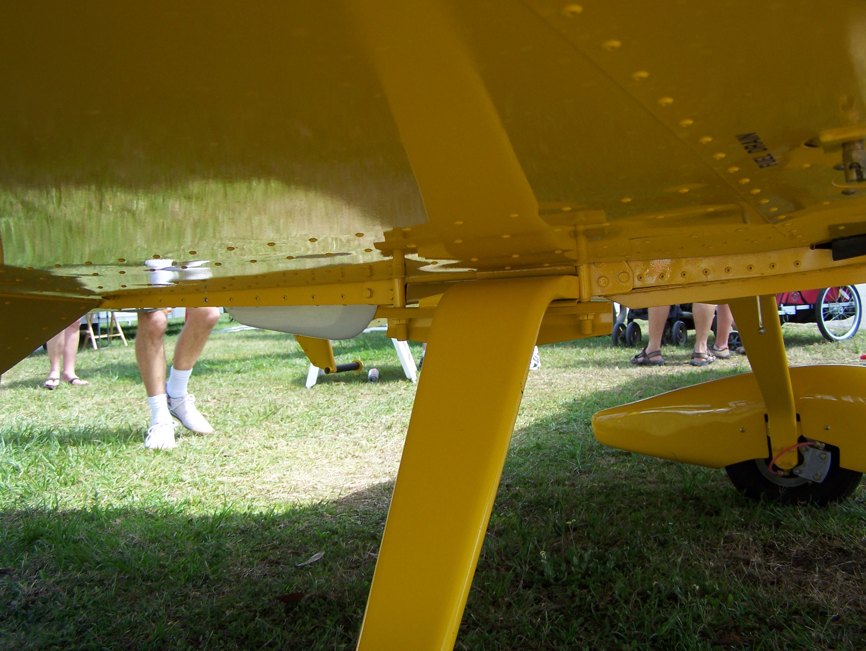

While I'll admit the gun-drilled brake lines are nice. The lack of them is hardly anything to be spooked about. Cessna has hung them out the back for years.
http://www.aircraftpartsandsalvage.com/popup_image.php?pID=12340&osCsid=eaccddfaa6563c93e7bceaa615fb3693

David L. Downey
Harleysville (SE) PA, USA
--- On Mon, 7/7/08, Brady <brady(at)magnificentmachine.com> wrote:
From: Brady <brady(at)magnificentmachine.com>
Subject: Zenith601-List: Re: Grove Main Gear Support
Date: Monday, July 7, 2008, 8:51 AM
--> Zenith601-List message posted by: "Brady"<brady(at)magnificentmachine.com>Has any body tried the Composite gear available from spruce?I understand there is a 40 LBS savings to be
nith601-List"' href='mip://00eb5478/3D"http://www.matronics.com/Navigator?Zenith601-List"'>http://www.matronics.com/Navigator?Zenith601-List
='mip://00eb5478/3D"http://forums.matronics.com"'>http://forums.matronics.com
"' href='mip://00eb5478/3D"http://www.matronics.com/contribution"'>http://www.matronics.com/contribution

PostPosted: Thu Jul 10, 2008 6:11 am    Post subject: Re: Grove Main Gear Support Reply with quote
Gig,
Here is a picture of and AMD 601 with the Grove gear. The welded spacers are towards the rear.
Ken
